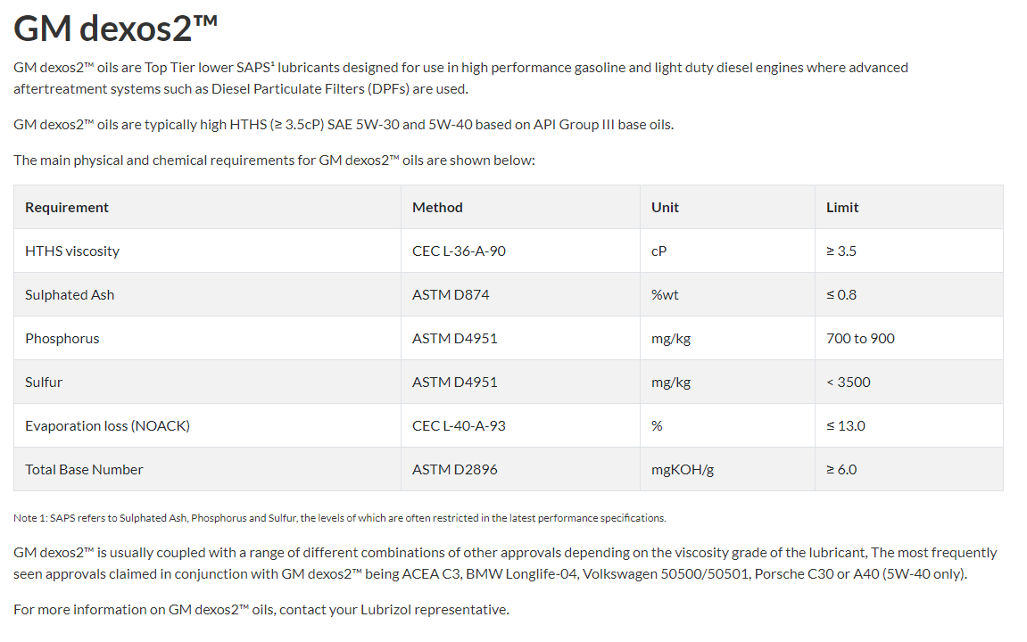

Here is what Dexos 2 requires: (from: https://360.lubrizol.com/Specifications/GM/GM-dexos2 )
Notice that Dexos 2 was intended for "advanced aftertreatment" aka catalytic converters and particulate filters in diesels. It is entirely for EPA requirements that GM NEEDS to meet to keep giving us big V8's. The reality is that many full synthetic oils meet these requirements already...there is an extensive list of oils that meet the requirements.

The Motul 300V that I prefer to use is slightly more viscous than the Mobil 1 fill across the board, is less basic (less corrosive), and has better shear resistance, but doesn't meet the Dexos 2 metrics because it is a race lubricant and doesn't even offer Ash or Phosphorus content...because race car.
Oil is subjective and some people will swear by one or the other, and to be quite honest most Corvette owners would be suited with Walmart brand synthetic oil due to the intended use of the car being a daily driver and grocery getter and the need for high performance low weight oil is less necessary.
I'm rolling with the Mobil 1 fill on my future C8 because I am not going to do anything to jeopardize my warranty on the powertrain while I am making payments...once the warranty expires I'll see how the oil holds up over time with keeping results from https://www.oillab.com/ and seeing if I like them. If I feel like I would be better suited by returning to Motul then I will but I have a feeling that Mobil 1 will perform admirably since the specifications are very close to what I used with Motul. Also Mobil 1 is MUCH cheaper so the pocketbook may force my hand anyways.
As for the comment about trusting the engineers that designed the engine around a specific brand of oil...that is just silly. Engineers don't design to a specific brand, they design to tolerances and the lubricants that can allow them. As long as an oil meets the viscosity and shear requirements to allow those tolerances, that oil will perform just as well. The only unknown I see is how necessary Dexos 2 is for the cats, it seems odd because in high performance engines there is an extremely small amount of oil that makes it into the cat and I doubt that the cats on the C8 are so sensitive that a non Dexos 2 oil would cause any issue unless you were burning oil caused by poorly seated rings and that is a far more troublesome issue than dealing with cats.
