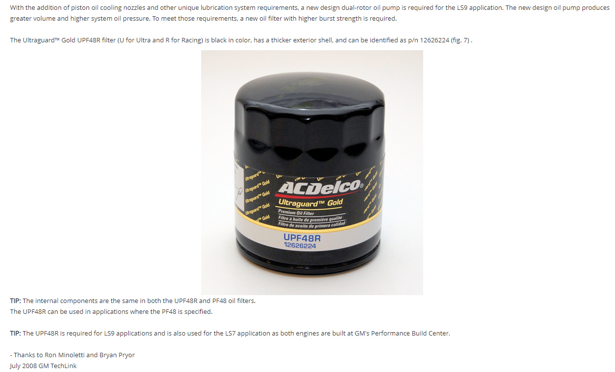

2009 Corvette Z06 and ZR1: GM TechLink Article: Oil System Changes - LS7 and LS9 (corvetteactioncenter.com)
I've cut open the old non E core PF48, the UPF48R, the old non E core PF63, the PF63R, and the non E core PF64 and PF64R. All the same inside. All the same specs. Ultraguards just get synthetic filter media, higher quality valves, and higher pressure burst can. Note the tip section under the image. The UPF48R can be used where the PF48 is used. Internal components are the same.
Old Jan 6, 2021 | 11:09 AM
SonnyAK's Avatar
SonnyAK
Joined: Sep 2010
Posts: 2,104
Likes: 701
From: Southern Illinois
The issue is the pressure relief valves. Most have different PSI’s and there have been service bulletins warning that. Here’s an example:
