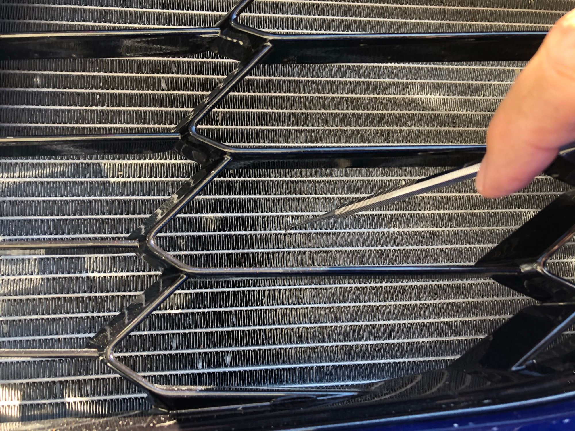

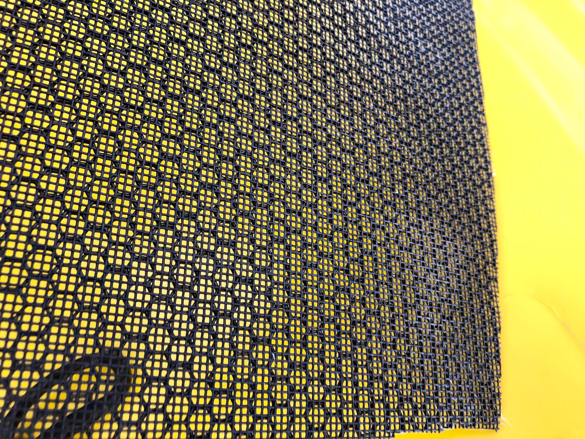

My thoughts exactly.....that’s why I glued vinyl screening on the back sides of my grills before I installed them. I had zip tied this screening on a z which I tracked wo issues. When summer comes if there are cooling issues I can remove any or all.
These fins are so soft.....I drove 800 miles wo the grills, left tons of space between the car ahead and had too much damage. Stones the size Of a nail head bending fins.
Used a dental scraper to pull out the stones and straighten the fins
Vinyl screens behind grills

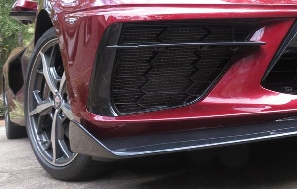

Yep Custom Car Grills opening size is the right compromise for good airflow and protection. Compared to thicker plastic mesh they are made from thin black aluminum. They flow 77% compared to cheaper screens you can find on Amazon that have much lower % airflow for those that list.
Followed your install and removed the Center and Side Grill bar so the nylon ties did not show. This is my 9 page detailed install Pics/Cation PDF: http://netwelding.com/CF_Splitter.pdf
Note also installed a splitter at the same time, hence the PDF title.
Don't need to invest in a lift to install. Have used these Stanchions I made for my 2014 Z51 for 8 years for ~$10. Used for my Side Skirt install as well. Note, lift too high and you'll need something to prop the splitter as I did to install the new one!
