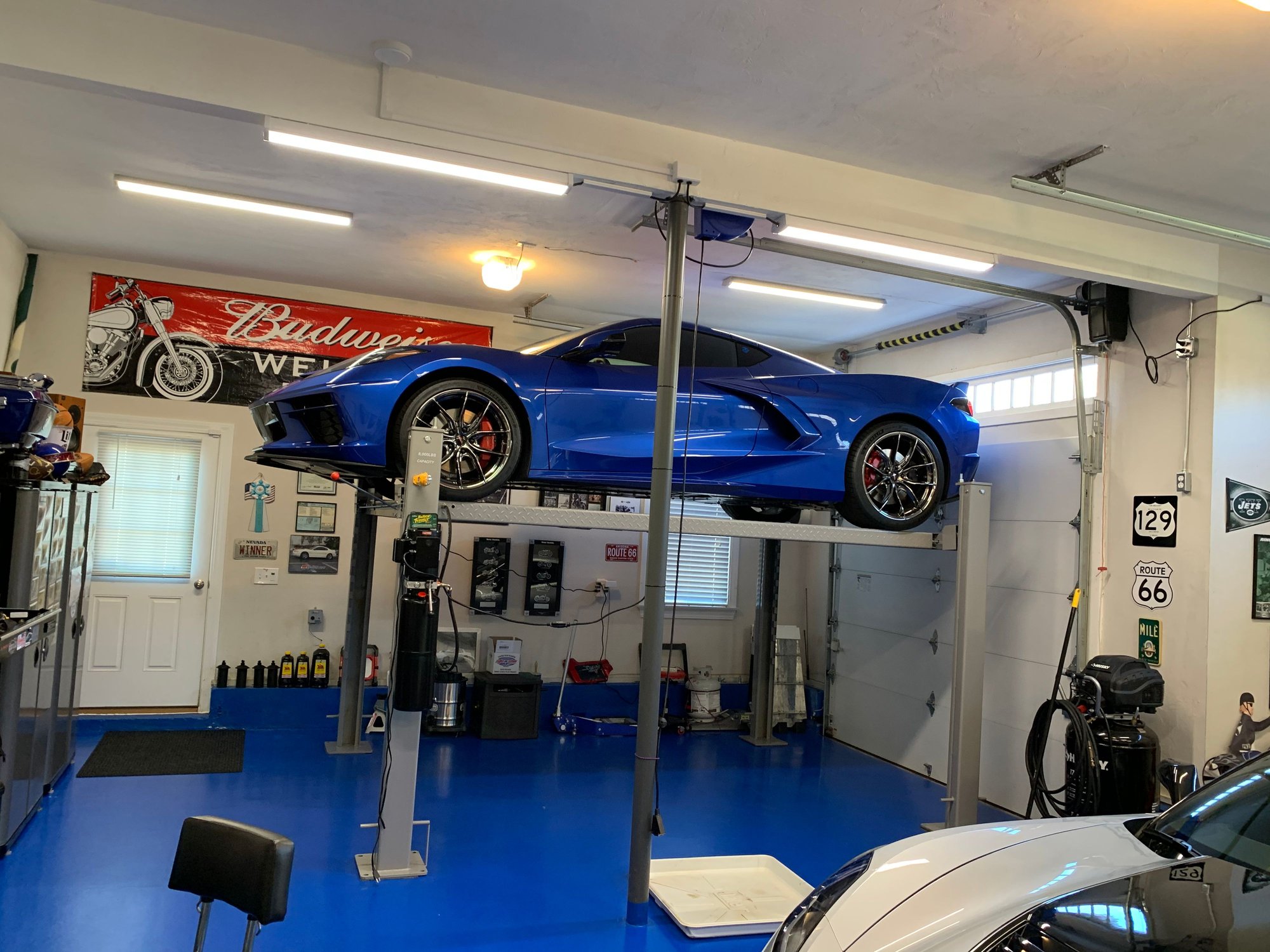

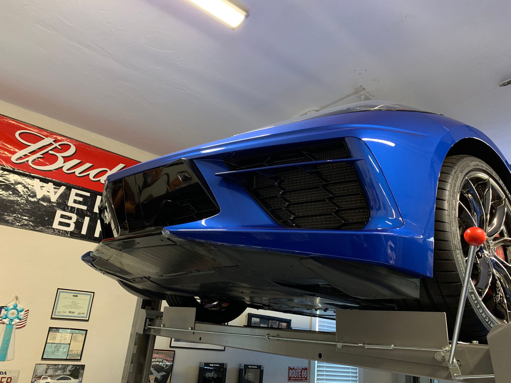

I installed mine this past weekend, not hard if you have a lift, I kept adjusting the lift height to make the install as easy as possible. If I did this on the ground, would have taken significantly longer than the one hour I spent installing. This is not hard work, it’s detail work. It take time to loop the zip ties in and out of the mesh grills, more tedious than difficult. Once the grills are in, they look great and look stock! GM should have these designed into the front end clip.

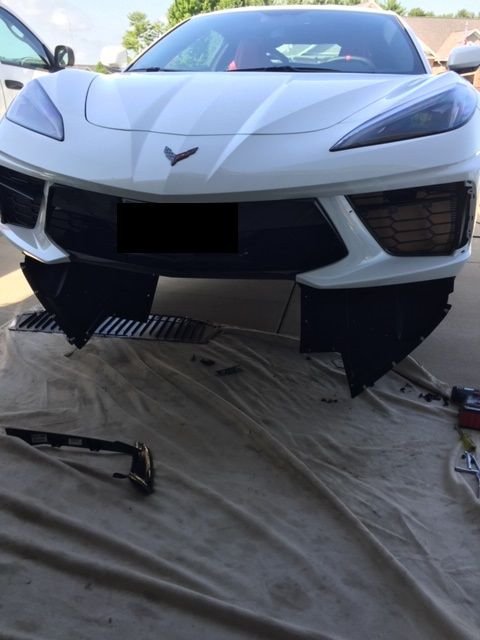

The screws that hold the splitter on are the same ones without the splitter holding the belly pan on. Yes it is a good time to add the splitter since those same screws go back in. I did mine while on a Quick Jack as high as it would go, ramps would be a must at the very least. This is what it looks like when being installed.

You can watch the video I posted in Post #5 to get an idea what’s involved. After you have the screws out, you just put the splitter in place before you put back the screws.

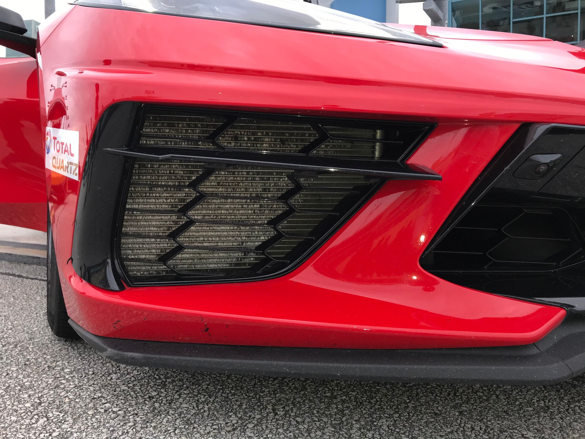

Good example of what happens without a screen !!! I will be getting screens for mine.

That is a nice setup. I was unaware of a garage door opener like that which would allow a car lift to go so high. What type is that opener?
