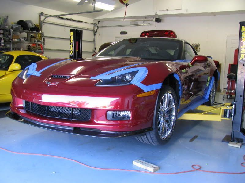

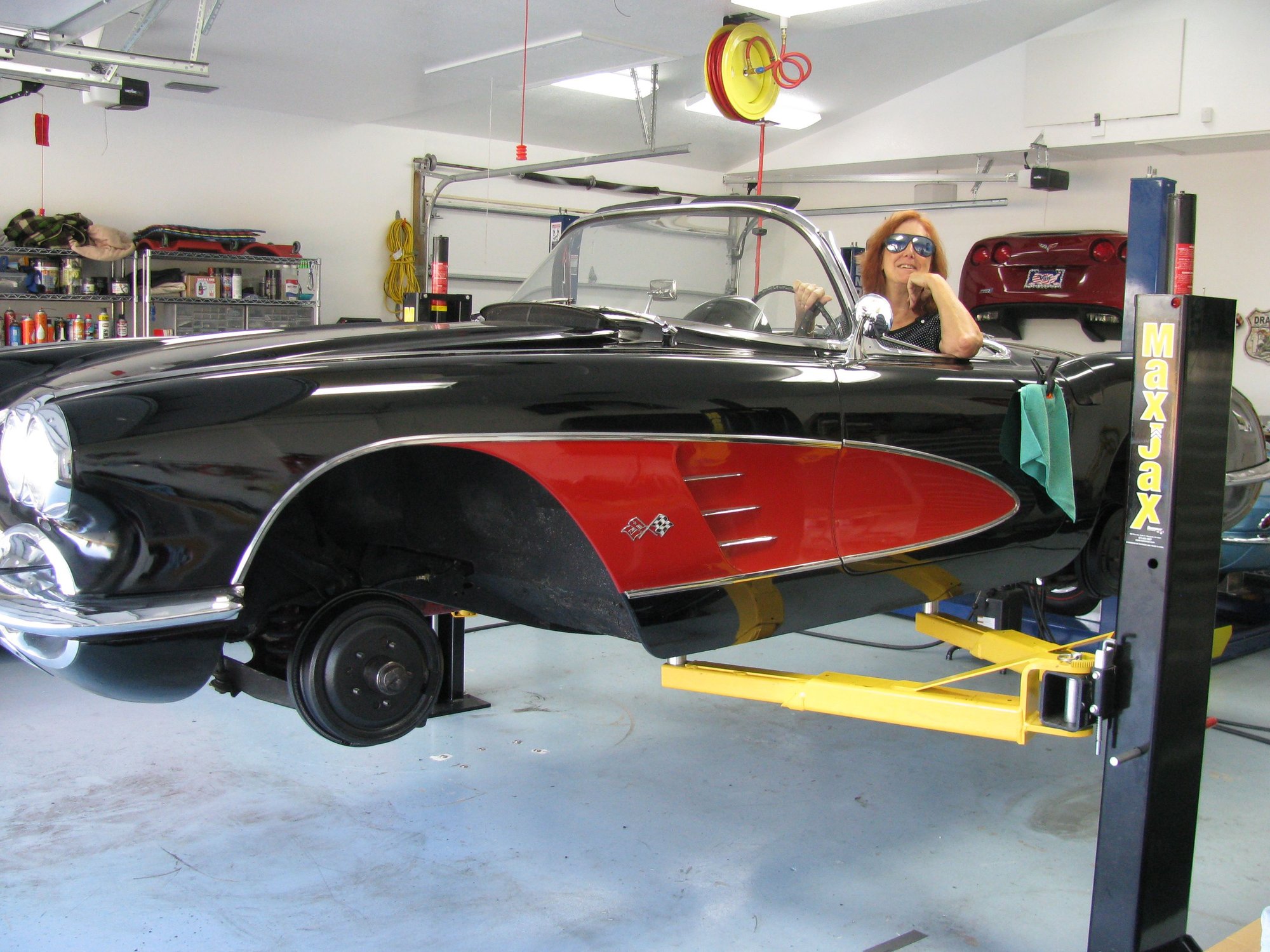

I have a MaxJax and use it all the time
https://www.maxjax.com/?SID=ugntuks861q1go32srcsc30u9g
Is it a pain to "install" and "uninstall" it each time you use it and are done?
Pretty easy about 10 minutes to set up and take down. The part that does take some time (5 or 6 hours) is the first installation when you sink the mollies and epoxy them in. You need to take your time and get them instraight, it helps having someone to lend a hand. Other than that it's not an issue to use it. I've used it for everything from my lawn tractor, golf cart to a Suburban.

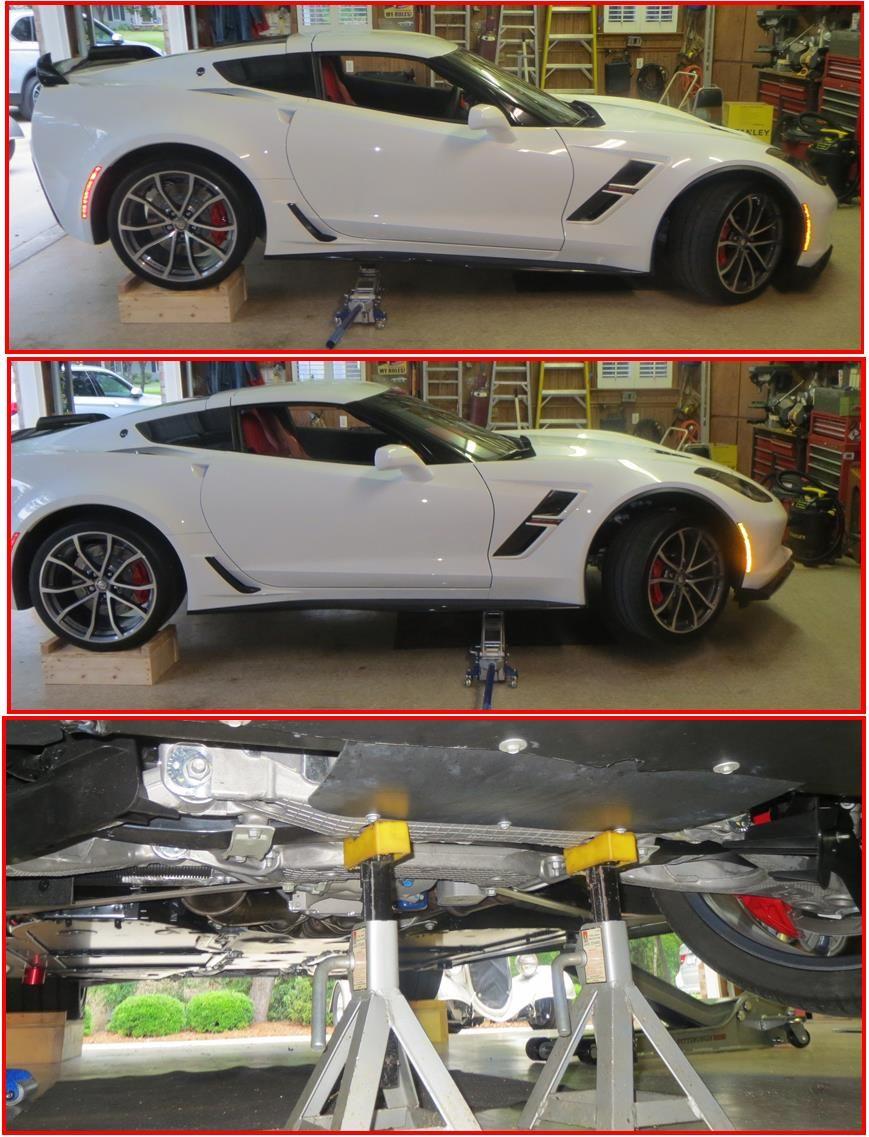

That's my issue with high Stanchions. Have a set 12 inches high I used when building my street rod. Was on the garage floor for several months installing (and welding) the exhaust, gas lines, wiring etc etc. Worth the 2 step jacking method I had to use. Still have them BUT would not consider using for anything on the C8.
I made my own Stanchions from a $10 from a 12 foot 2X6 and some 3/4 inch plywood for my 2014 Z51. Have used on my 2017 Grand Sport to change oil etc. Used on my C8 to install low dust brake pads, side skirts and AC Condenser protectors. I show how to make them in my Jacking PDF: http://netwelding.com/Jacking_A_C7_C8.pdf.
Could make from a 2X8 or even 2X10 if you want higher lift. Funny, after having someone question the safety several years ago, for fun I calculated the safety factor. It's a minimum of 4.3, which is no doubt better than the plastic ones you can buy or plastic race ramps. Last month someone said it's only air under the 3/4 inch plywood top so I added to my strength calculations and note that the thinner plywood holding your refrigerator on 16 inch spaced floor joists is much less less than half as strong. In addition, the bridge you go over every day probably has a safety factor of 3 with lots of air underneath! All the data and this latest added safety info is in the back of the updated PDF. Your car your choice!
Pic C8 Side Skirts installed. NOTE: Lifts, quick jack and some combo lift jack stands would all be in the way when installing side skirts!
My ~6 1/2 inch high stanchions would fine for changing C7 oil.
Have 12 inch high commercial stanchions but needed a two step jacking process. Was fine when the street rod i built was in the air for several months when I installed the exhaust, gas lines, trans cooler etc etc. BUT would not bother with the C8.
