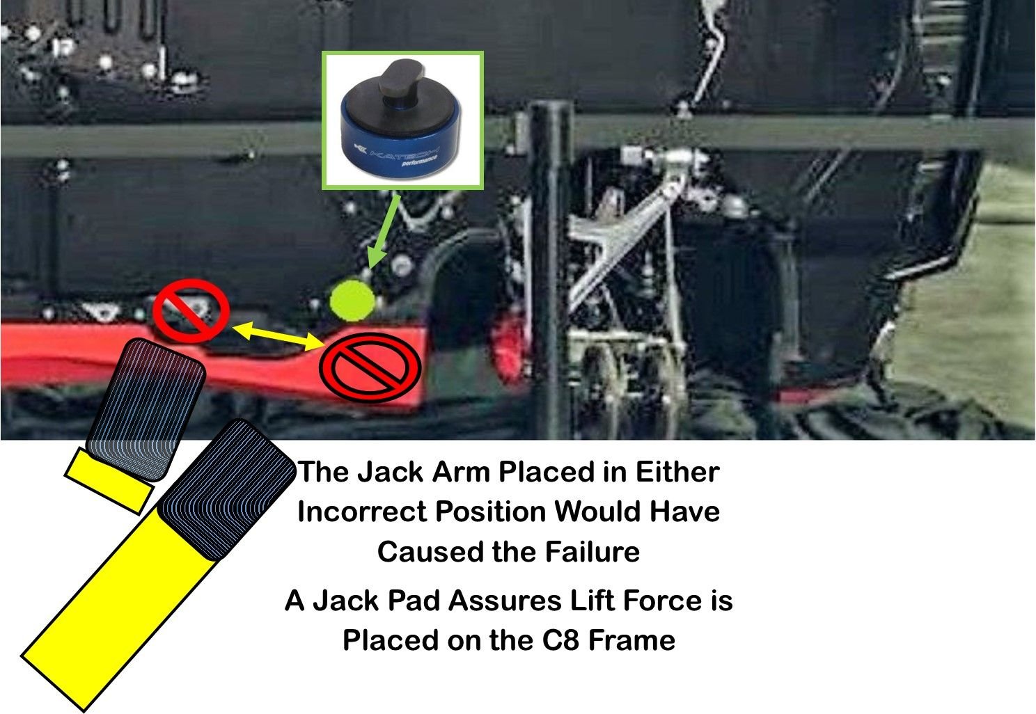

I know Jerry is going to give me fist for saying this, but I put the stand at the round hole after lifting the car at the oval hole (where I installed the lift pucks) first, and had no problem at all. The owners manual only said that do no lift with the jack contacting the vehicle body:
"Use only a service jack with a lifting pad diameter of 64 mm (2.5 in) or smaller, and thick enough to make sure the jack does not contact the vehicle body. Position the service jack and lifting pad under the frame rail shipping slot reinforcement."
From what I could observe, the round hole is on the same steel frame as the puck hole - only a few inches back, so maybe Jerry can explain why we can't use the round hole for stands... maybe there's something more being said in the Service Manual that's not in the Owners Manual.

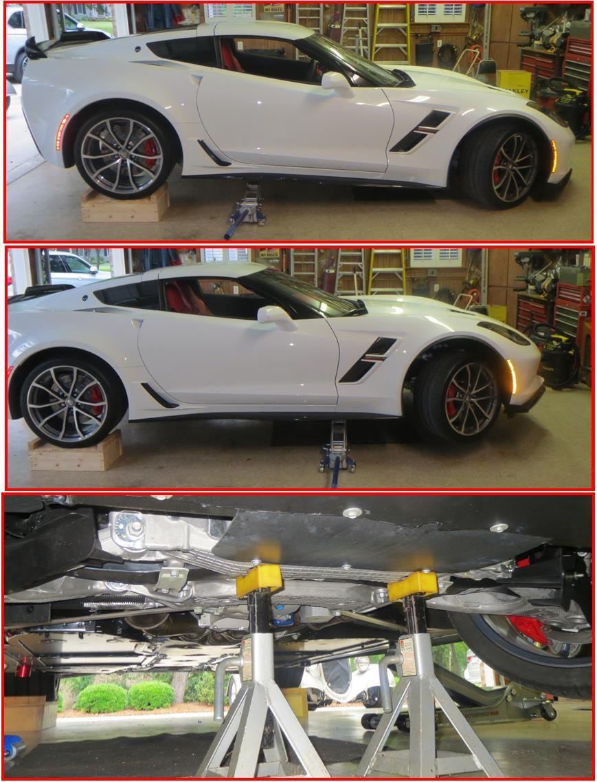

The proper lift point is also the proper Jack stand point. I bought Jackpoint jack-stands. Renn stands will also work. A lot of people have Quickjacks. If you are not removing the wheels, wheel cribs will work. I also built a set of wheel cribs. RaceRamps also makes wheel cribs.

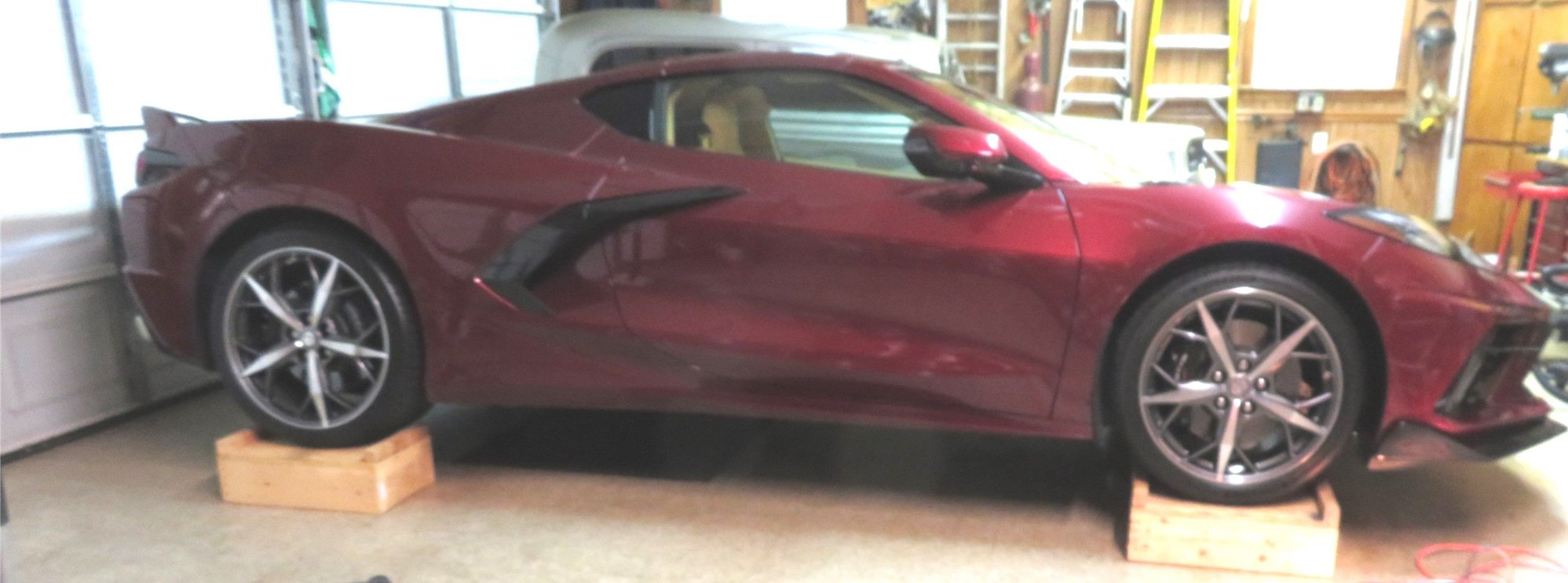

Wheel cribs is a great idea, and yours looks are well done! I saw JerryU mentioned that he also uses something similar to put under the wheels or car. I'll make a set too using lumber word following you guys ideas.
Totally agree that just using stands is risky. In the past I typically use both floor lift and stands together just in case one fails, but I'll adopt the extra wheel crib approach. I have a neighbor down the street recently worked under his BMW and the car fell on him. Fortunately he only hurt his legs. Given C8 has a less clearance under the car, I'd imagine that if it falls on us, it would be more than just the legs get hurt.

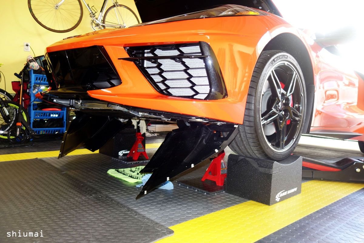

I too, believe in redundant support when working under the car - you can see below I'm using wheel cribs, I've left the floor jack in place, and I have jack stands placed under the A-arms (no pressure on them).

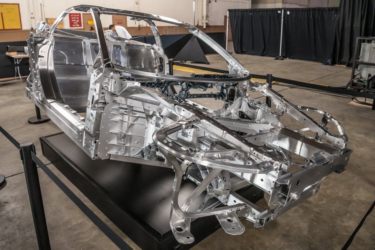

Originally Posted by CarbideTech
This shows the jacking points, but where do you put the jackstands? I’ve seen posts where they suggest you takeoff the underbody panels. But to do that you need the car jacked up. How are other people handling this?
Jerry made another pic because a poster said GM never said they were lift points just support locations. Perhaps semantics but also put in a caution. No question in my mind that with those large frame castings etc. I would find a safe place to put jack stands, BUT here is the catch 22! To use any frame members to support the car with jack stands you have to remove the aero panels. They are held on with bolts. So how do you safely remove the bolts? I have a proposal I put in my brake pad replacement PDF if you want to remove the calipers. That requires a high lift and the use of 155 ft-lbs to remove and tighten the two large caliper bolts. I would NOT do that with just jacks supporting the car.
Revised pic. Frankly if it didn't have to be jacked very high I would use the lower "A" frame supported with jack stands.
To remove the aero panel bolts I would first put the front wheels on my home made wood stanchions I have used for ~7 years.
Then if for whatever reason the GM suggestions in yellow on their diagram did not work for the specific application, I'd fine 2 spots on that complex aluminum frame to put jack stands.

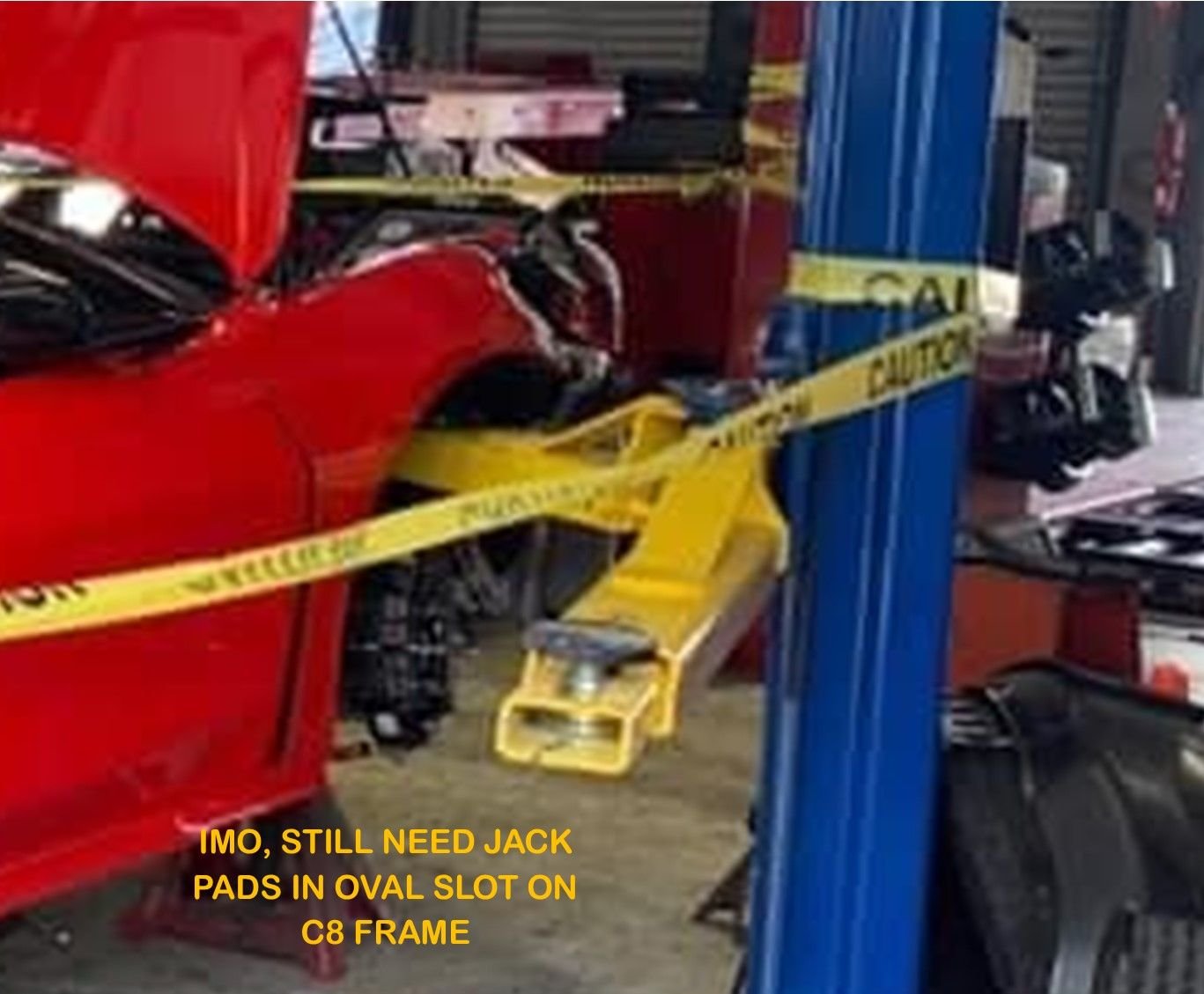

Jerry can only say in the rear it appears very critical. And that is actually a big difference in location of the oval and round frame member regarding lifting. There was a Conti video that said his smart tech mistakenly used the rear round holes and was going to put a transmission jack in the rear center to support the car because it was rocking! Got my attention since his tech is very smart. Turns out in a subsequent video he said they just said that for effect.
However in another video with the car jacked he did not use jack pads but relied on the round pads on his post lift. That had me even more concerned, perhaps not for him but for the average tech who could easily pit lift end pads OUTSIDE the frame on an area that "looks" like it's a "good spot." If you have not done it, look under the rear to see where the slots are. Not easy, have to have your head on the ground and may need a flashlight. How many techs, especially at a tire shop are going to do that?
I discussed the use of jack pads with the super Corvette Tech who works on my C8 after I showed him a pic of this one that fell (WHICH HE HAD NOT SEEN.) Their post lift also has round jack pads at the end of their post lift arms and I suggested you still need jack pads in the oval slot that are on the frame in the right location. He agreed. In addition if the post arm bends and they are not used it could be lifting outside the frame.
