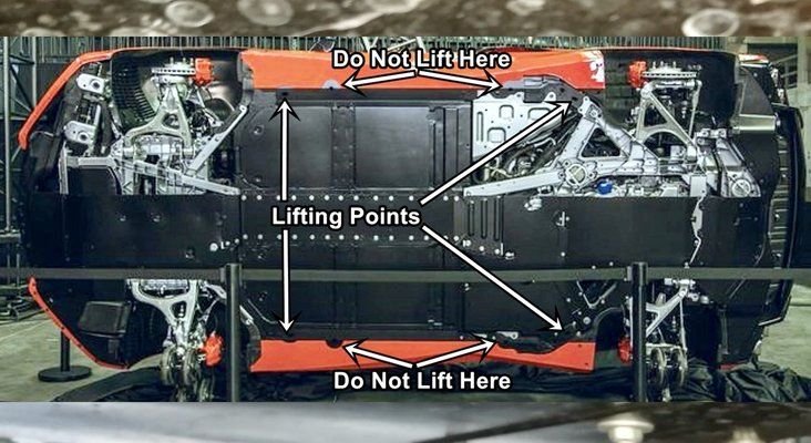

The Diagram below would seem to indicate that properly mounted pucks would still allow for skirts to be attached...

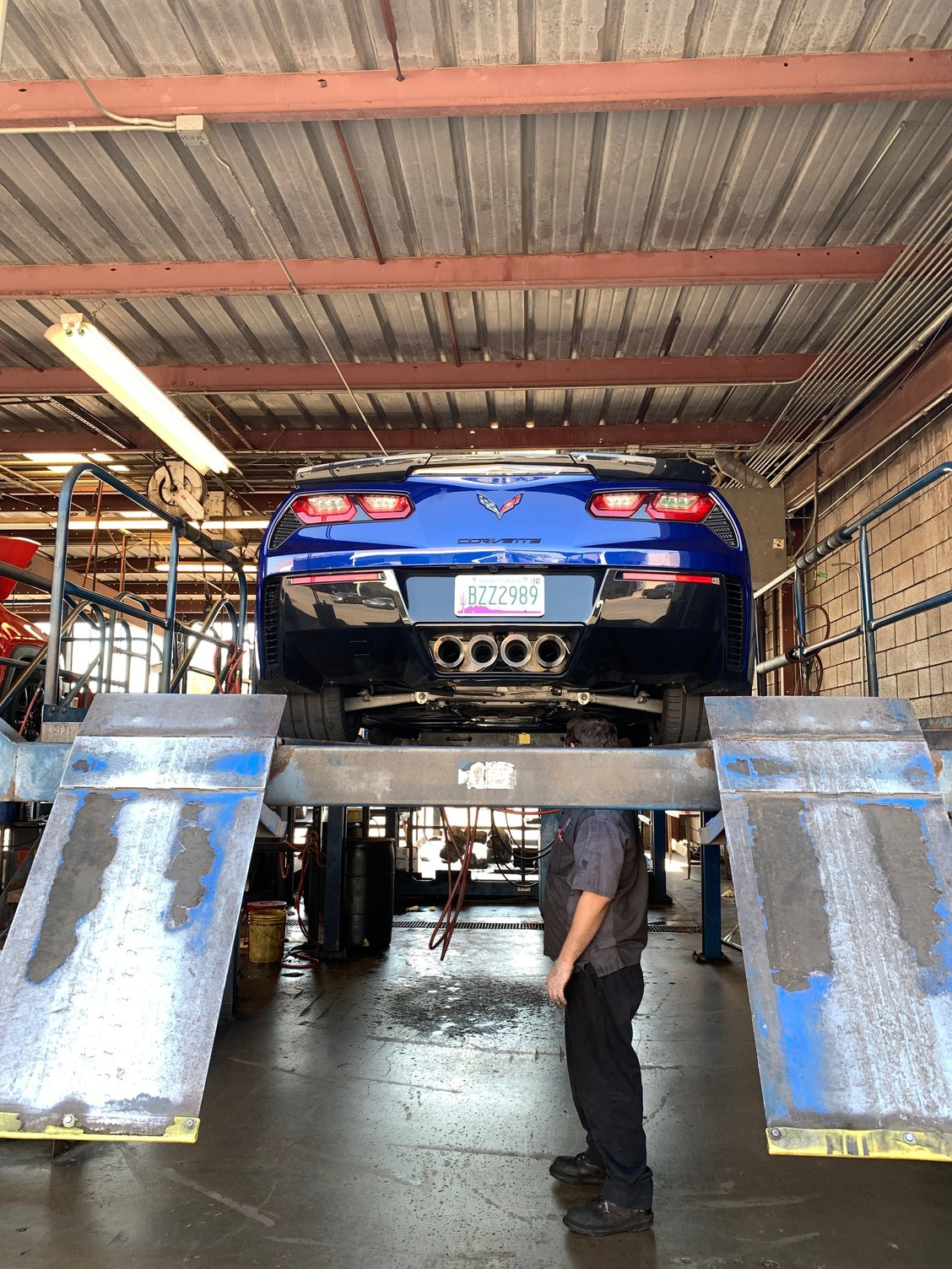

Don't need them. My dealer lifts the car this way....and they provide pucks for when it has to be lifted using a jack....

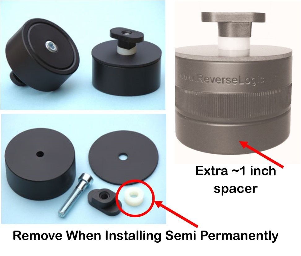

The side skirts extend somewhat under the rocker panels. In addition the frame is below the composite rocker panels. It all adds up. I use these now and have 4 in my tool bag in the C8. If going to a tire shop where they often have post lifts so tires hang free and NO Vettte techs I would bolt in these 1" high pads temporally.
Available from Reverse Logic a forum vender. Can even make higher with available spacer,

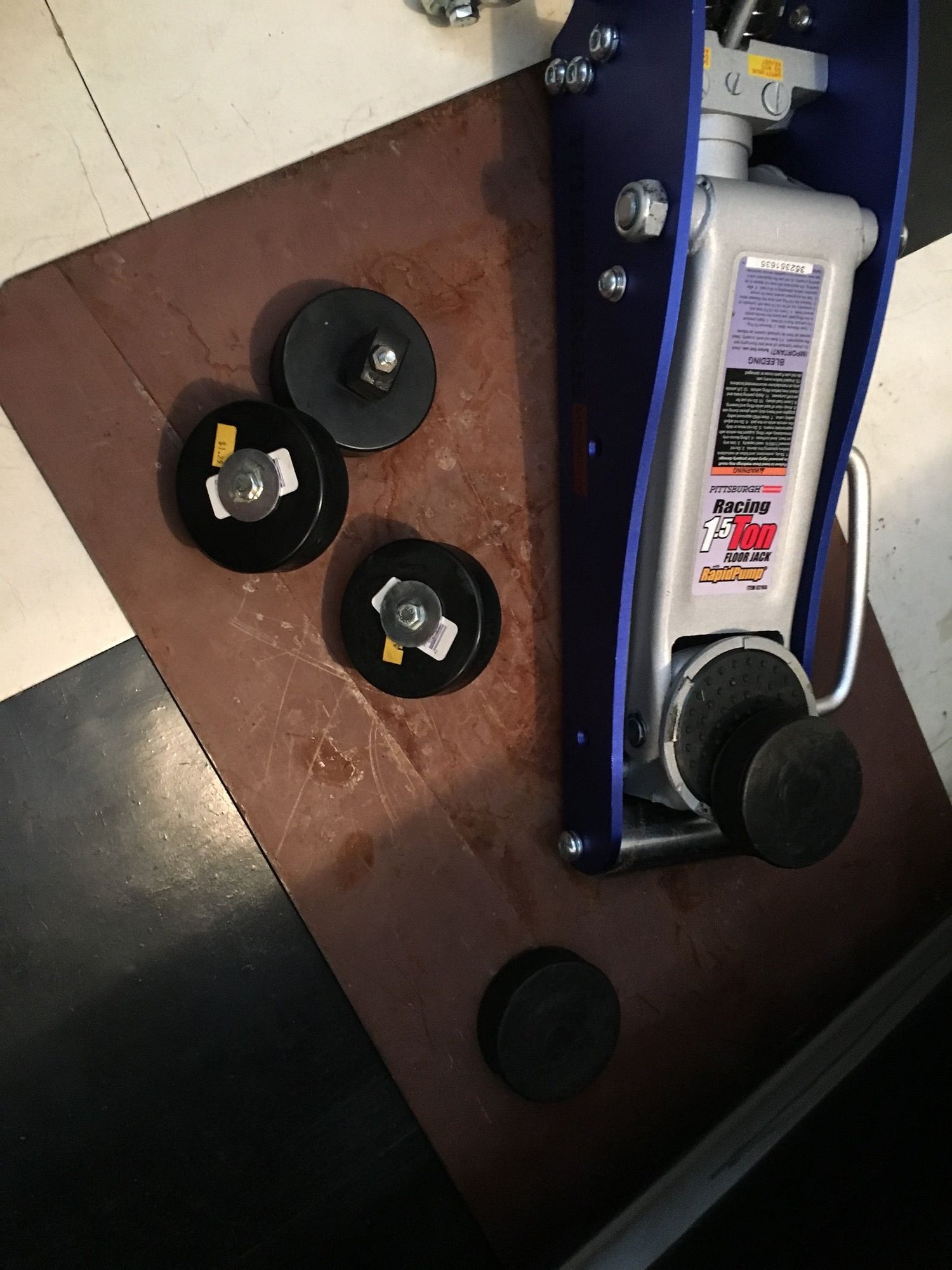

Go to play it again sports. Hockey pucks. . A little hardware and a dremmel.....less than $10. I like the rubber pucks better then metal.

I too made some using hockey pucks, but used eye-bolts to get that elongated shape where it twists in to stay temporarily. (C6, waiting on my C8.) To me it appears the lifting spots that are not correct have round holes, not the elongated shaped holes at the appropriate lifting points. So if the mechanics would use the proper pucks, they would realize the don’t fit in the round holes, and look further and realize there are in fact other holes to fit the pucks. But there in lies the problem. They don’t look, they don’t even bend down to look. So if one even has the pretty red ones permanently attached, what are the chances they’ll even see them? I am thinking when taking to a dealer bringing the photos above and having them sign off on reading them.
When I took my brand new C6 to my dealer, I told the service writer to be sure to use lifting pucks. (At that time it was to prevent cracking the rocker panels, not from cracking the car in half.) He never heard of them, but assured me he knows better than me, since he use to work at a Mercedes dealership. Asshat! Fortunately I walked around to the back and saw the young man walk to the cabinets and pull out the pucks.
