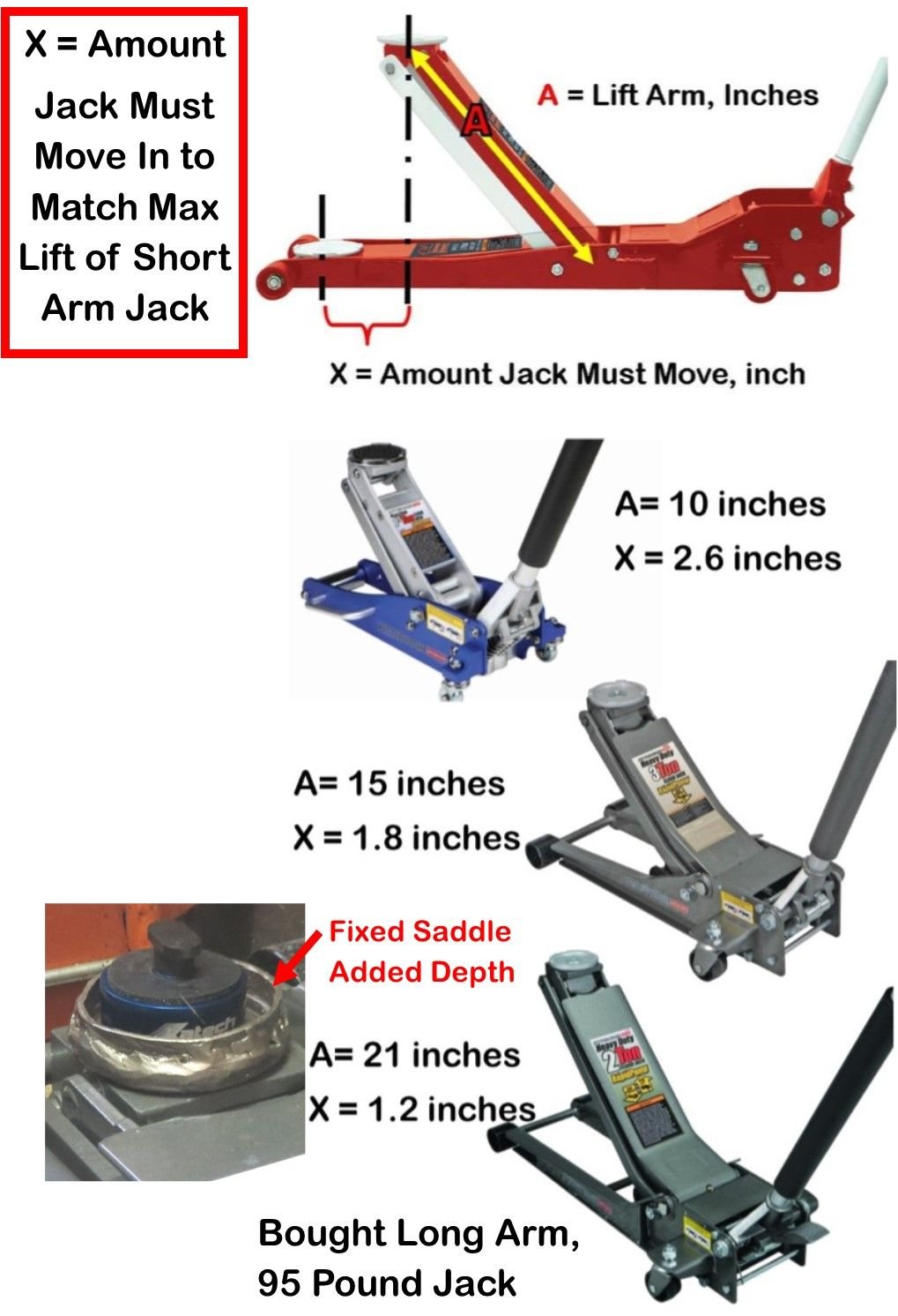

The concern I have is for tire shops and dealers. When I jack my car I am careful to watch as the jack lifts that it also moves into the car. The amount needed is dependent on length of jack "lift arm" and amount of lift. Aluminum or rubber jack pad surface, the jack saddle can slide off. Was not enough friction force to help my jack pads "pull the jack" into the car on my 95 lb long reach jack. To be sure, I increased the height of my jack saddle.
I have 4 hydraulic jacks. With all I watch carefully and check that 1) the jack is perpendicular to the car- NOT at an angle, 2) for those with casters be sure they are set to move in not backwards or at 90 degrees to the jack 3) check the jack saddle to Jack pad relationship every few pumps. Pays to be safe that sorry!
Jack MUST move Into Car To Keep Saddle Centered on Jack Pad. If Jack Saddle Doesn't Have High Sides Be More Careful and Check Saddle to Jack Pad After Every Pump. On my 95 lb Long Reach Jack I Increased Saddle Height!
