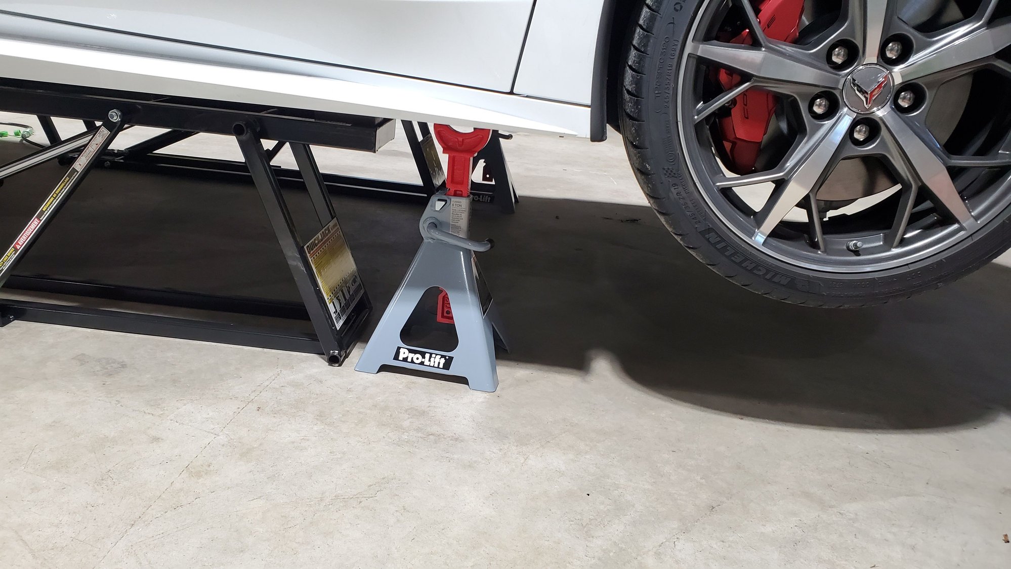

Not sure if this is what you're looking for, but after raising and lowering my car several times for detailing, etc., I noticed they had worked themselves toward the rear of the car a couple of inches or so. I now make sure they're positioned correctly before each lift, even when I've not moved the car. I have a smooth concrete floor.
Used a set of jack stands on the "short end" before getting under the car to remove the front spoiler and install the grill screens.

I've not seen any movement of the base of the lifts. What NextOne has experienced I have too, what he is seeing is as the lift comes up it is in an arc and the car is in Park and or the E brake is set. The car can't move, but the trays ARE moving forward (depending on the direction you have placed them) so the pads CAN slide a bit as it lifts the car until the tires break free from the pavement. I now anticipate this and start with my lifting pads lining up at the front edge of the pucks so after "the slide" occurs (it's not much, maybe 1/2") the rubber blocks are centered the rest of the way. On my daughters Mazda 3 I had to reposition the lift like three times because it kept sliding, the Corvette is minimal. So to answer your question, does the base move, I haven't seen any movement of the lift on the floor.

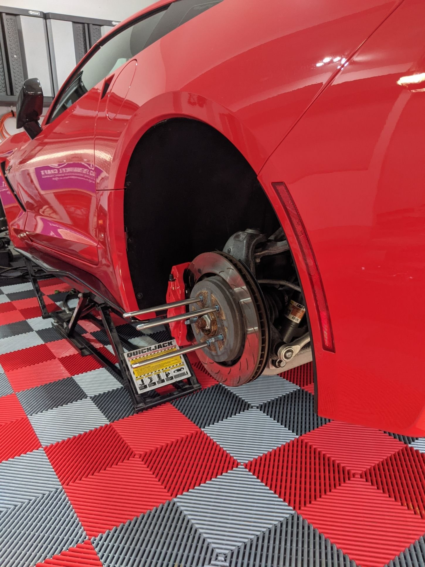

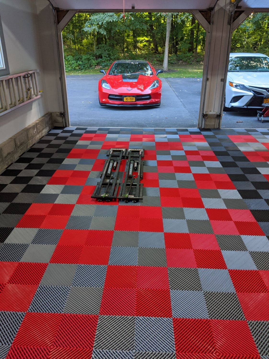

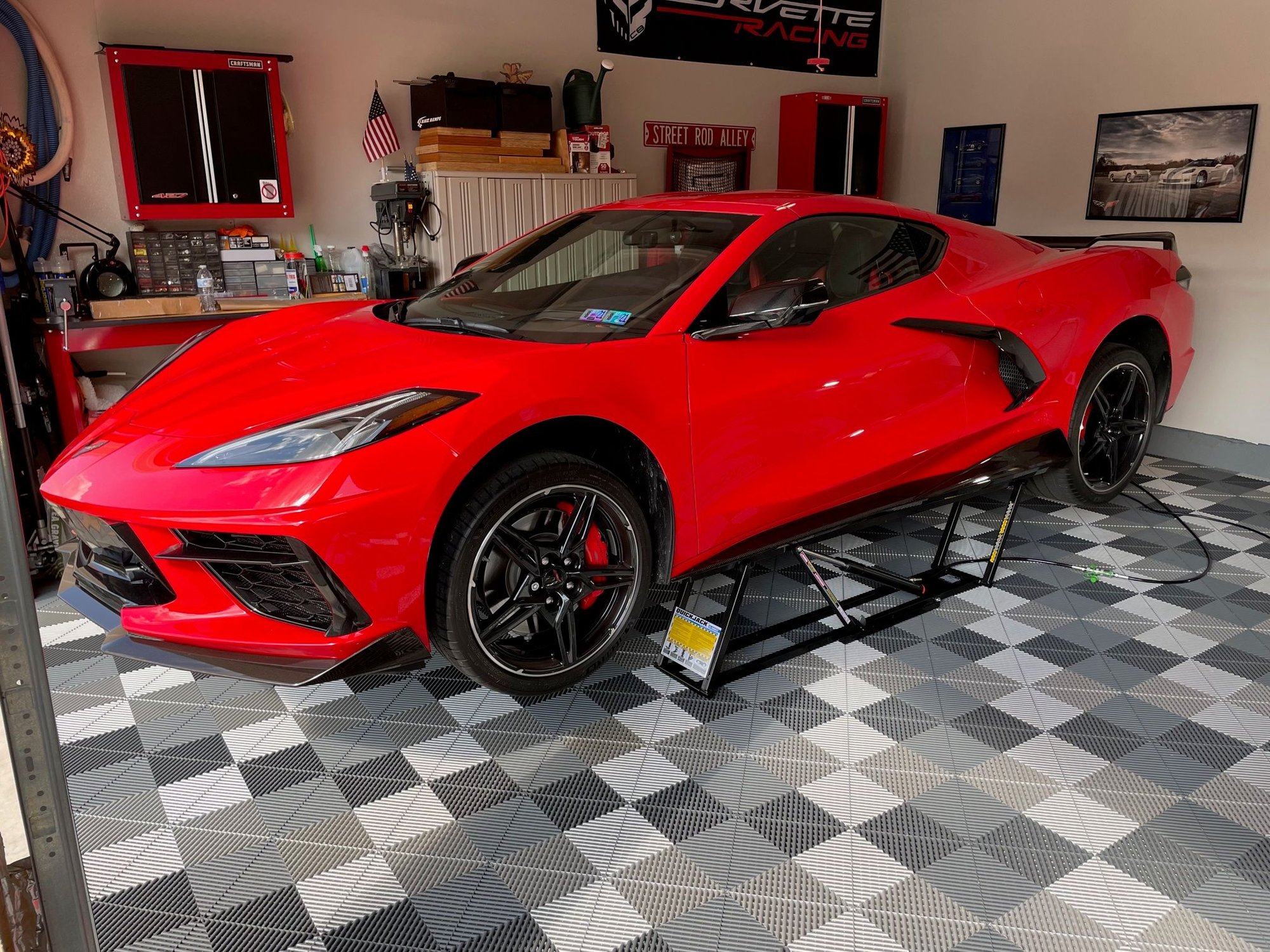

I use my QJ on a Racedeck FreeFlow XLC floor and before that on bare concrete. I have also used it on my asphalt driveway with plywood under the rails. I have never noticed any movement of the base, however the car moves 1 to 1.5 feet in the direction the rails are positioned. Using the RaceDeck flooring makes it very easy to line up the jacks. It also makes sliding the QJ into place easier. I just store my rails under the Corvette and don't move them until they are needed (my C7 is lowered all the way on stock bolts) because the DD can drip onto the QJ. Hanging 70+ lb rails on the wall will be somewhat difficult because they are awkward to lift. I would rig up a pully system if I was going to hang them. When the car was stored for the winter and the front was about 6" from the wall I reversed the rail direction so I had room for the car to pivot.
storage location
Lifted to 1st stop

Good idea.

Not needed in the least, the majority of the mass is in the rear, the thing never falls forward. I was under mine with front wheels off or on and it's beyond stable. Had the wife sit in the car too and it's rock solid. There is NOTHING shaky about using a QJ under a C8.

I agree completely that it's rock solid but IMHO it never hurts to be paranoid. The safer the better.
Especially if you are not the only person messing around in the room.

After verifying the weight of the car is on the safety bars (and I always do) I have no concern. I watched the QJ video showing it holding 20,000 pounds of weight, and I have the 7000 series that is rated for thousands more yet, yeah, I'm comfortable being under it.

I have the RaceDeck Free Flow XLC and it works great with the QJ. The pattern makes it easy to keep the QJ aligned and it slides easier. The Free Flow is great if your garage gets wet because the water passes through. We get a lot of snow where I live (also great for washing the car). The non draining tiles would probably be a better choice if your garage stays dry.
