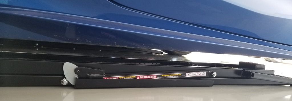

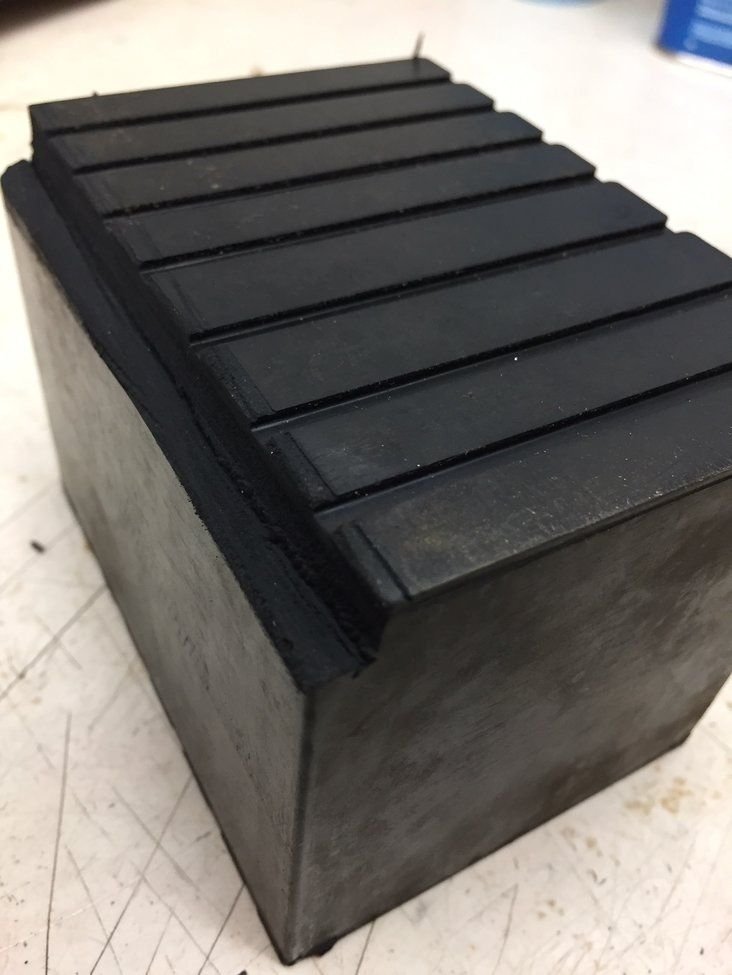

This thread seems to make it pretty clear. Rear QJ lift point with the shorter rubber block, with the rear jack pads installed. Front QJ lift point where it ends up, with the thicker bock trimmed to fit outside the frame "rail." NOTE: I have not tried this. Do so at your own risk. Neither I nor the original poster guarantee results or your safety. You're on your own.
https://www.corvetteforum.com/forums...es-and-no.html
Clear photos in this post:
https://www.corvetteforum.com/forums...post1602744741
Rear of QJ on puck:
Trimmed tall block:
Front of QJ where it lands, with the taller, trimmed rubber block:
And this photo shows the part of the frame the notch it cut to clear:
And the car up on the QJ, with the front block visible under the frame:

First 4 photos above are mine. I already had the standard (not EXT) QJ. I and others lift our C8s with no issues or concerns. If I were buying a new QJ, I'd get the EXT version. But I refused to buy the extensions for my QJ because of the added cost, the extra weight, the aggrevation of maneuvering and storage, and then not having enough clearance to slide the ramps under the car.

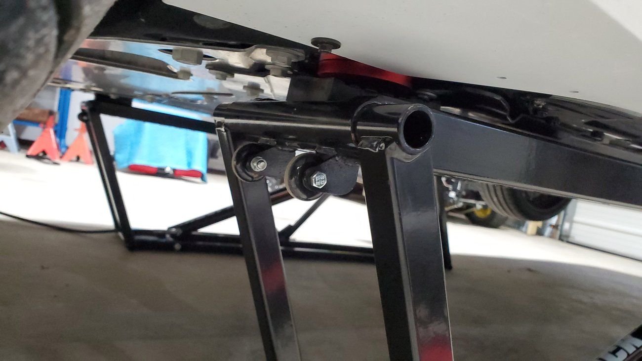

I vouch for the BL 5000 EXT too. It is the perfect length to accommodate the pucks.
Also used those red pucks that bolt to the C8 jack points for ease of locating them.
This should reduce the chance that anybody else will jack using the wrong points.
Regarding safety: Raise the jack until the two safety bars pass either the first or second stops located on the bottom rail.
Then lower the jack until the safety bars touch the chosen stop(s). This provides a safety mechanism in case the hydraulics fail.
If and when I plan to crawl underneath I would consider adding additional blocks or boxes under the vehicle in case both the bars and the hydraulics fail.
This would provide triple redundancy.
I have an epoxy floor. To keep from scratching the floor and make it easier to slide the QuickJack, I attached 1/8" thick sticky back felt pads on the underside of the QuickJack bases, especially at the points where the bases contact the floor.
My first project using the jack: I cleaned and ceramic coated the insides of the cast wheels, in order to make it easier to clean the wheel of brake dust.
Above: QuickJack requires some air gap in order to have enough leverage in its parallelogram, to begin lifting. It works.
Above: As shown, lifted to the first QuickJack stop point. The second one raises it to almost 24".
