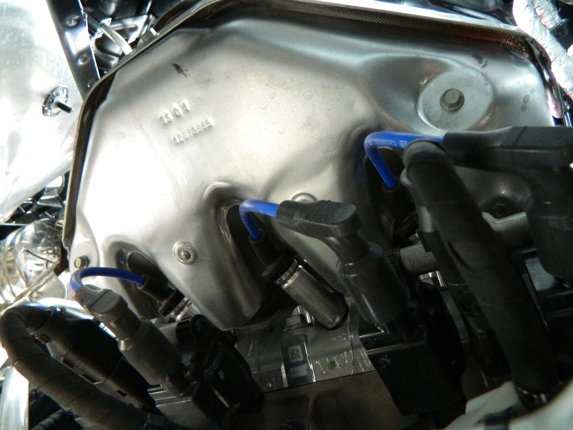

So, are people telling me that to change the plugs you do it from under the car???

Yup, actually easiest through the rear wheel well. Take off the rear wheels, remove the wheel house liner and it's right there. I took this pic from underneath with the belly pan removed while on my QuickJack.
