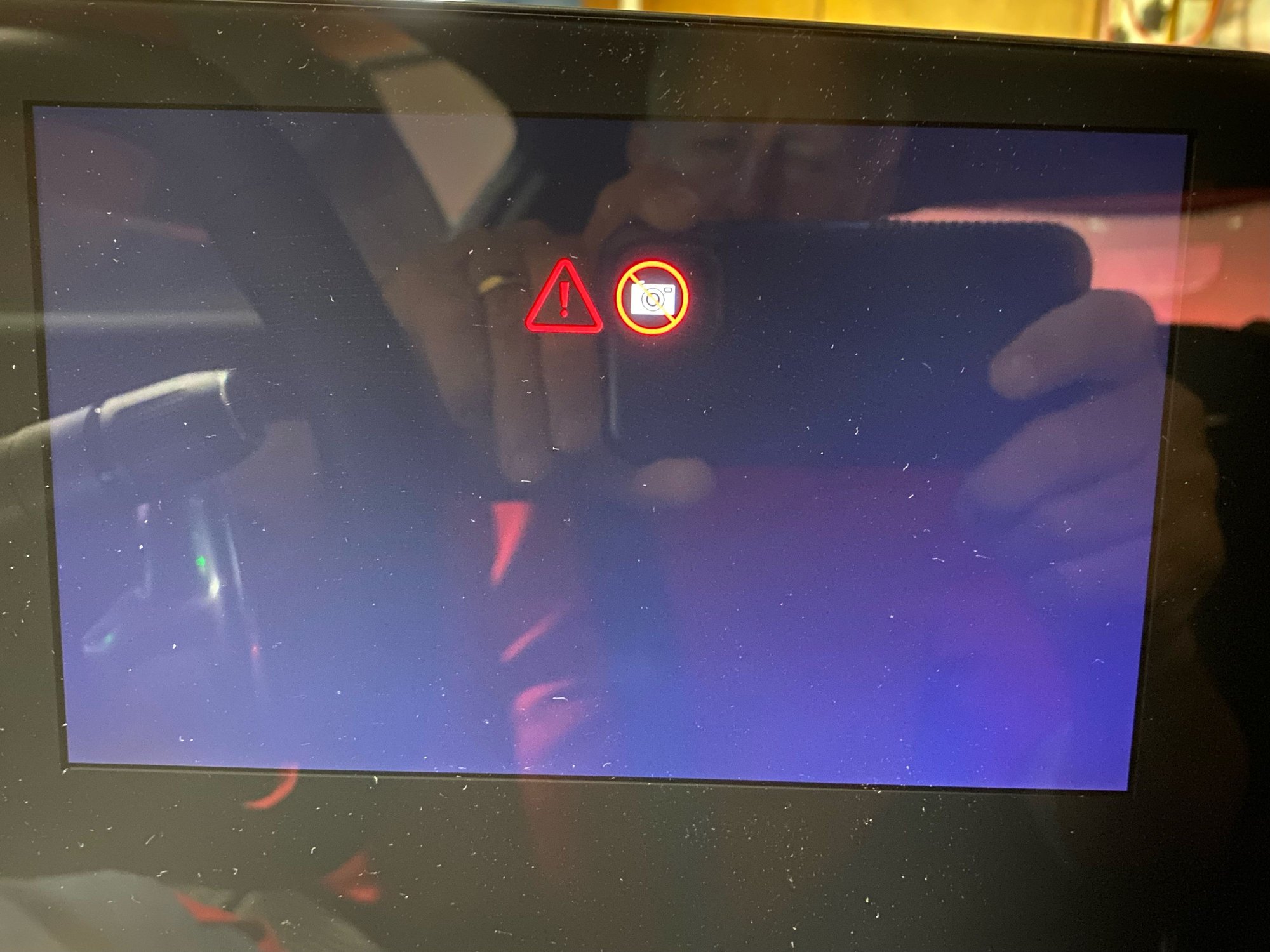

This is what it looks like. Next stop will be the dealer.
This is what the display looks like when the camera issue happens. Occurs about once a month. Next stop will be the dealer. It will be interesting to see how they deal with an intermittent problem. If they just want to shotgun it, I may wait until it occurs more consistently.

Please keep us posted how it goes. They normally cannot do much unless issues are permanent, but yea I'm also interested in what they say. Your screen is slightly different from mine. In my case, the color is blighter blue and no signs/icons, but I guess it's still same kind.

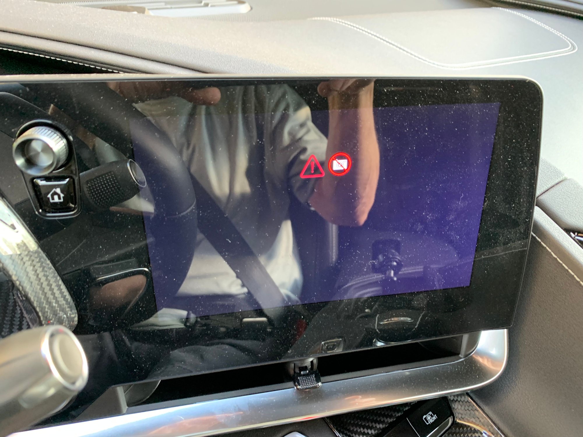

And here is a picture of my camera malfunction also! Did you happen to notice this seems to happen after you have had the back engine hatch open. This has occurred on mine about 9 times already. It seems to happen after the rear hatch has been opened.
