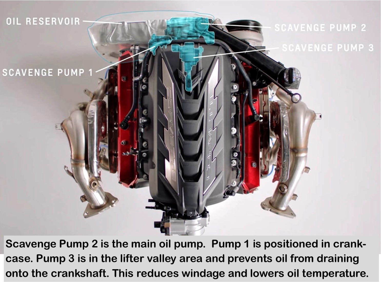

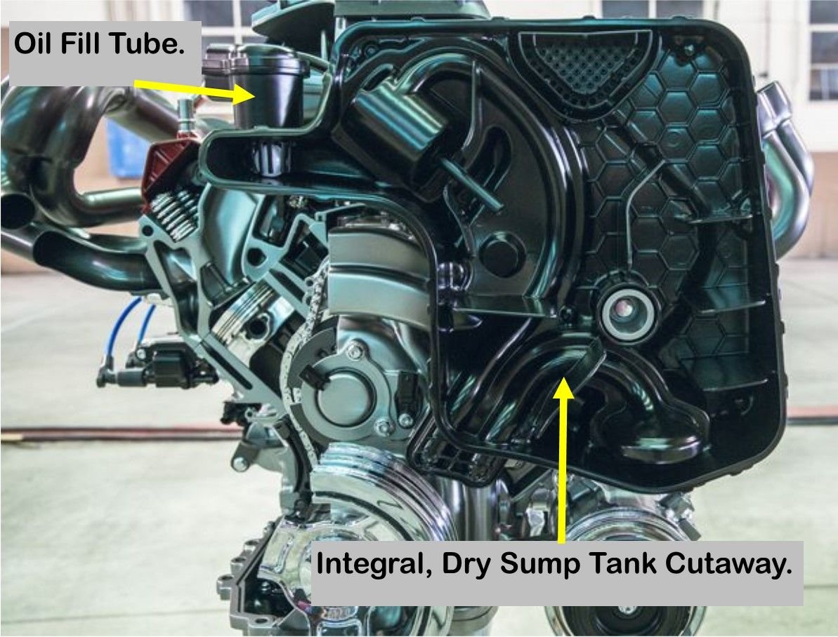

If that's the case it's a new on on me, as I've never heard of any Corvette oil being checked while engine is running, wet sump or dry sump......................
It's similar to an automatic transmission, the dry sump tank is part of the engine. So like a "slushbox automatic" the engine oil must be pumping to have it stay in the dry sump tank (as it must in the "slushbox" torque converter) for proper measurement. Shut it off and some runs back to the pan.
Similar reason you could not wait more than 10 minutes to check oil level in a dry sump C7. Oil would flow back to the pan and you'd get a low reading.
Actually the wife's BMW is similar. In that case no dip stick they use oil level sensors. The oil level can be checked but with the engine running and over a few minutes.
A pic of the dry sump is below. Instead of letting oil that goes to the rocker arms run down to the pan there is an oil scavenge pump in the lifter valley! It has 3 scavenge pumps not one like the C7.
Note for OP. If the cap you're is referring to is the one on top of the fill tube, would think you could run the car forever with it off on a smooth road! Oil is just being pumped into the tank by 3 oil scavenge pumps and delivered under pressure to the engine by one pump.
GM mentions the two added scavenge stages contribute to reducing internal crankcase pressure and increasing vacuum. That is similar to racing dry sump system with multiple scavenge pumps where the vacuum created has the crank and rods spinning in lower than atmospheric pressure and can add 10+ hp. Doubt the C8 system adds that much BUT everything helps!

Thank you Jerry, that's explains it precisely and to a much greater detail than included in the owner's manual.....................
