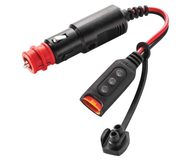

The CTEK adapter that I use looks like this:
Yes, the red doohickey stays on to plug it into the outlet in the frunk.

I don't remove it on mine and it works perfectly.

I will have to try it again. First attempt it would not seat in the receptacle. Been working without it.
Just put the red plastic piece back on. Must have screwed up the first time. Fits properly and seats in receptacle. Charge is working properly.

That red adapter definitely belongs on the end of the plug. It protects the other set of contacts that are in the wrong place for your Corvette. When the red adapter is installed there are only two negative contacts showing on the plug. If you remove it there are four. I don't know if that matters, but it definitely fits correctly with the red adapter installed.
