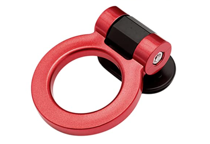

This is the BEST tow hook ever! AND, it's universal! Works on all cars! Best price at $10!!!
Amazon Amazon
[Yes, it's a joke for those stupid enough to think this would work.]

For show cars many have tow hook, for the looks. Many companies even make decorative/fake tow hook just for the looks, like the one few posts above.

You usually get what you pay for. Be careful, I've seen cheap ones that are for show only.
