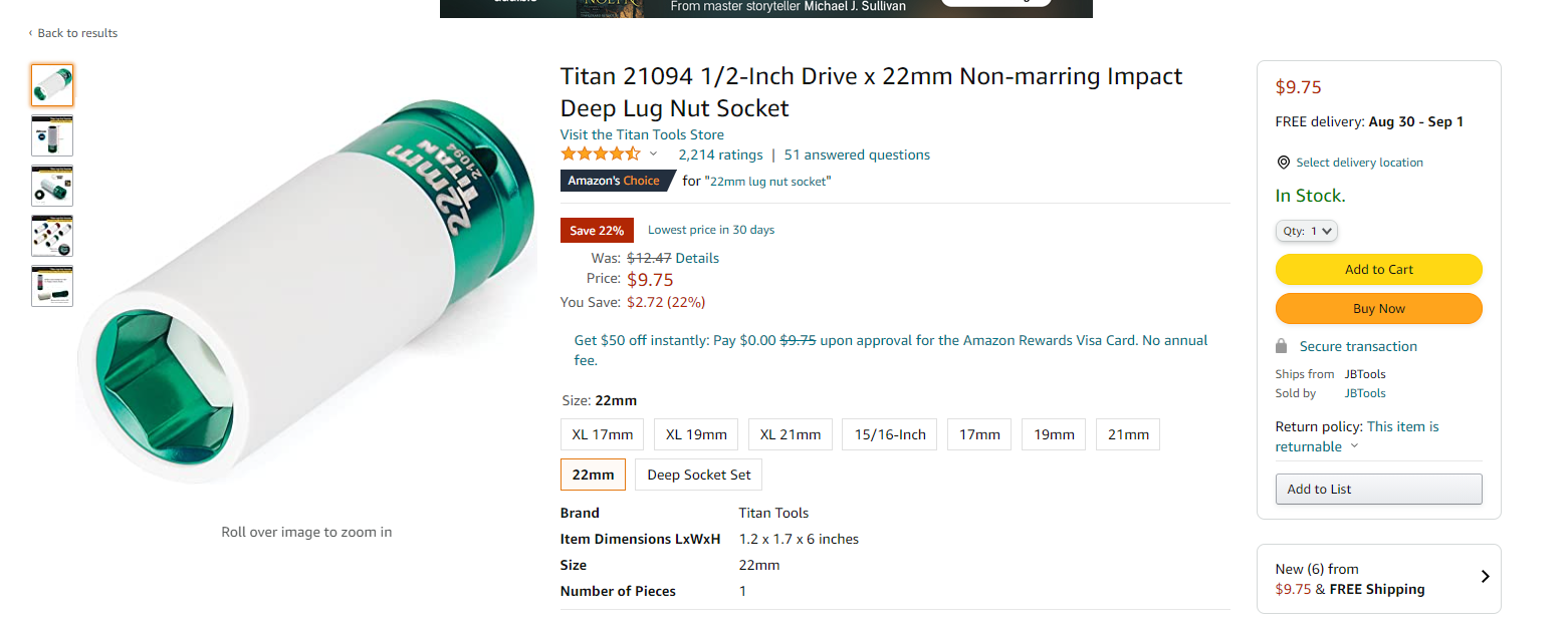

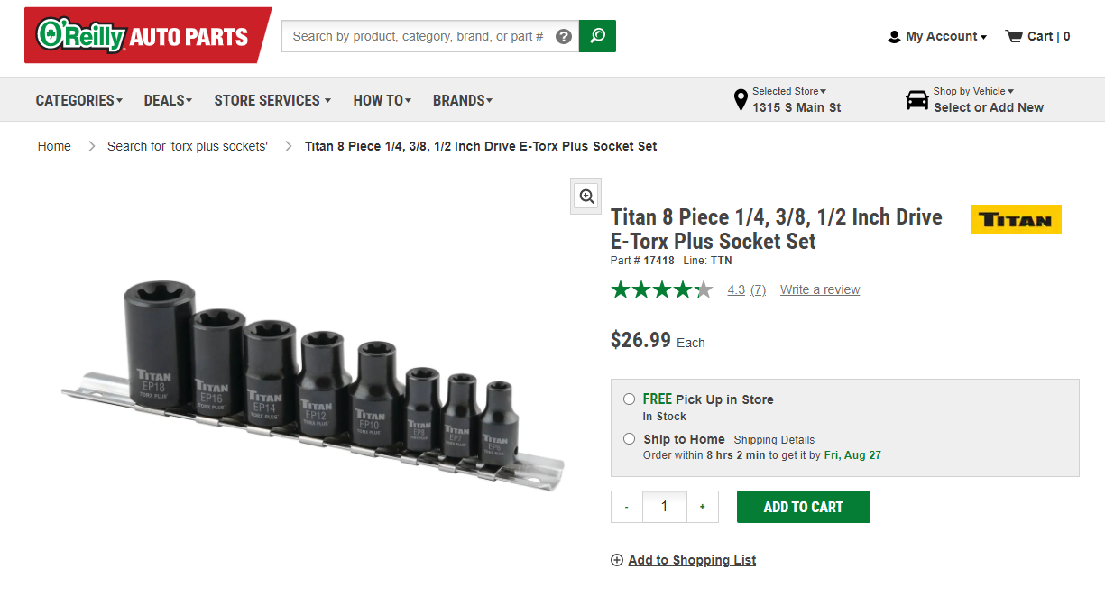

Just to get you going here are a few that are handy to have. The oil filter wrench truly fits a PF64 oil filter. The fasteners on the belly pan are Torx Plus E. The lug socket is the one I have, but some like the longer version.
Oil filter wrench on Amazon
Torx Plus sockets at O'Reillys
Lug nut socket at Amazon

Regarding the E-Torx Plus sockets, the bolts securing the bottom covers have low profile heads. This means that sockets with a chamfer may have to be ground to remove the chamfer so they don't strip the heads.
There are special low profile E-Torx Plus socket sets but they are expensive. This socket set appears to have minimal chamfer:
Amazon Amazon

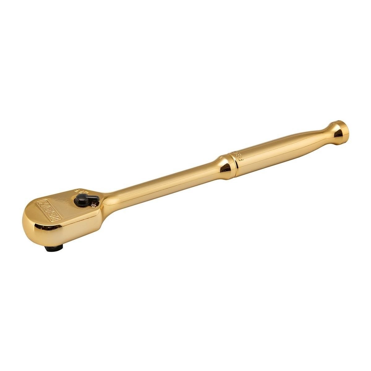

Originally Posted by sonicss33
Don’t laugh but Harbor Freight “Icon” series tools are rated pretty high against the competition.
Check it out - 24 k gold plated! Still a tenth of snap on. But I still would take the snap on.
https://www.harborfreight.com/38-in-...ted-56907.html
