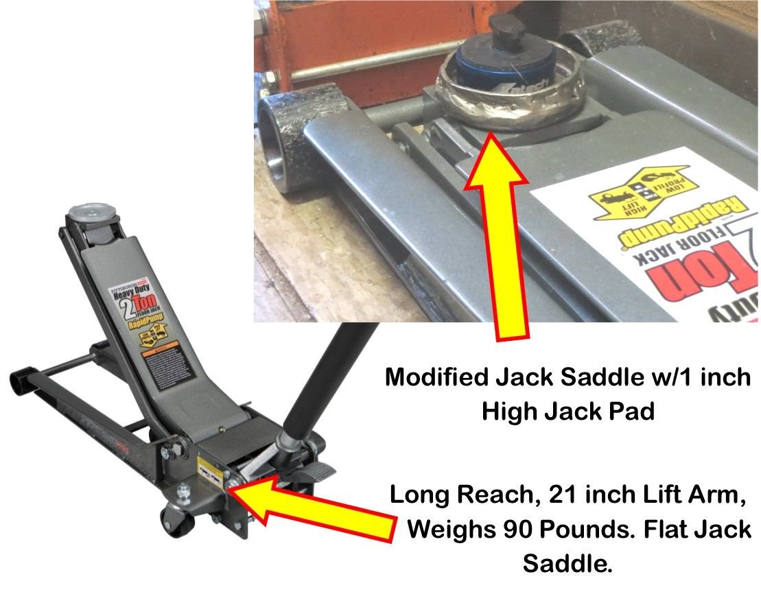

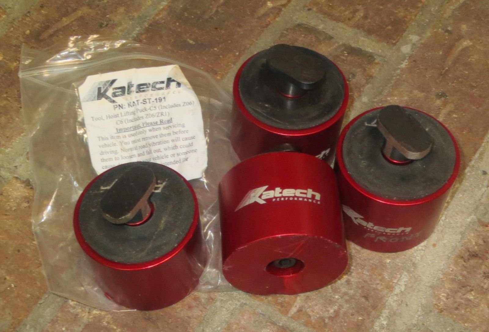

Yep, most of mine are loose vertically. No issue. Glad you said they were 2 1/2 inch diameter as my C6 jack pads were 3 inches so bought new ones for my C7's. Elite are less expensive than the 1 inch and 2 inch high Katech aluminum I have. But could not find the diameter on their website. Bought a 1 inch Katech pad to fit my low profile jack. Both have more than doubled in price. I'll recommend the Elite as I get PMs and posts asking!
FWIW, GM oval slots are not all perfect. Can see I had to grind the sides of two of my 2 inch high Katech pads to fit my C7 Grand Sport!
Bought a 1 inch high Katech jack pad to fit my long reach low profile jack. It's heavy, 90 lbs, and was not rolling into the car when lifted. I welded on a rim to the jack saddle! It helps pull the jack in and keeps the jack pad on the jack saddle! The 1 Inch high pad gives all the vertical clearence needed.
