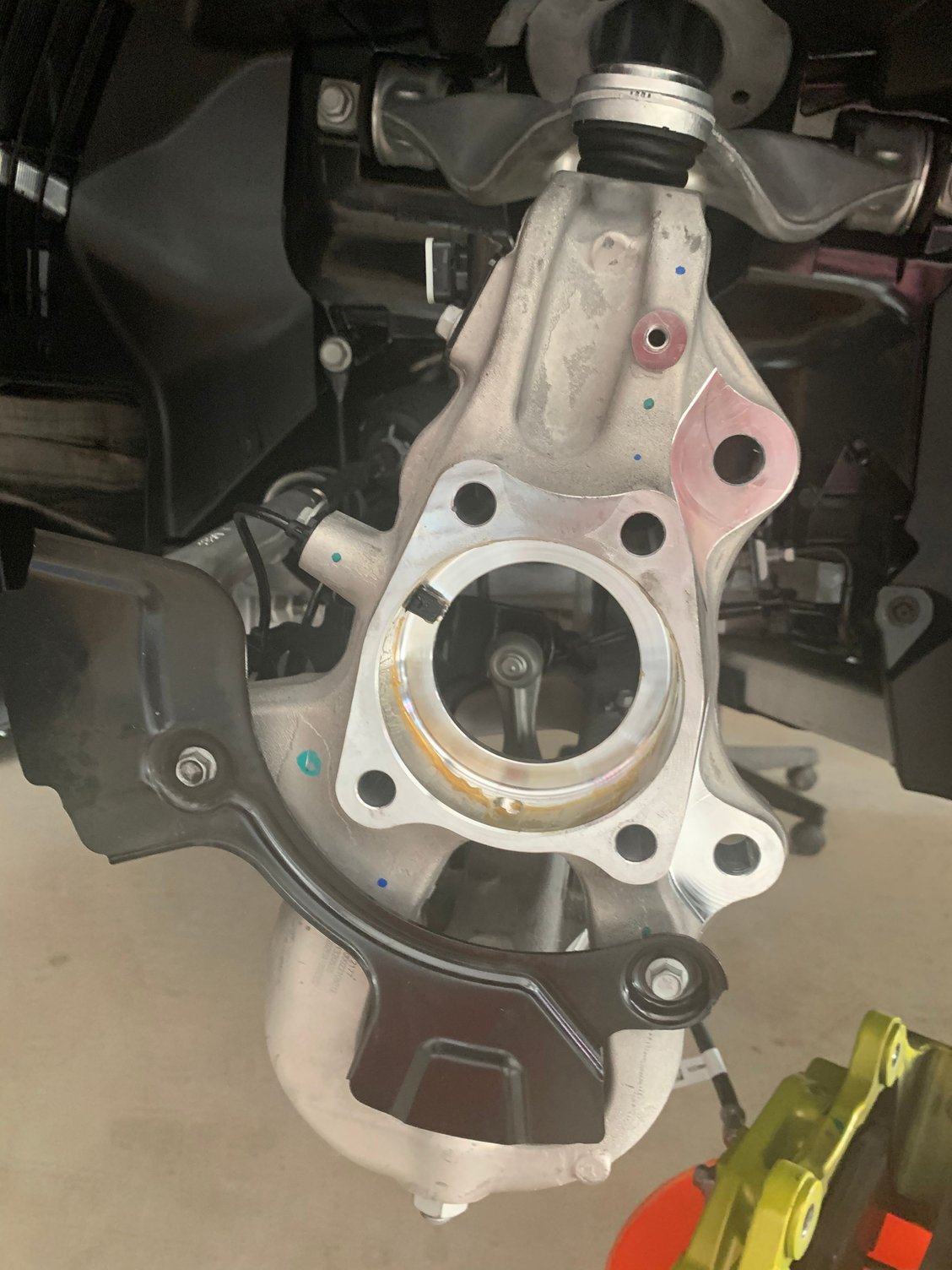

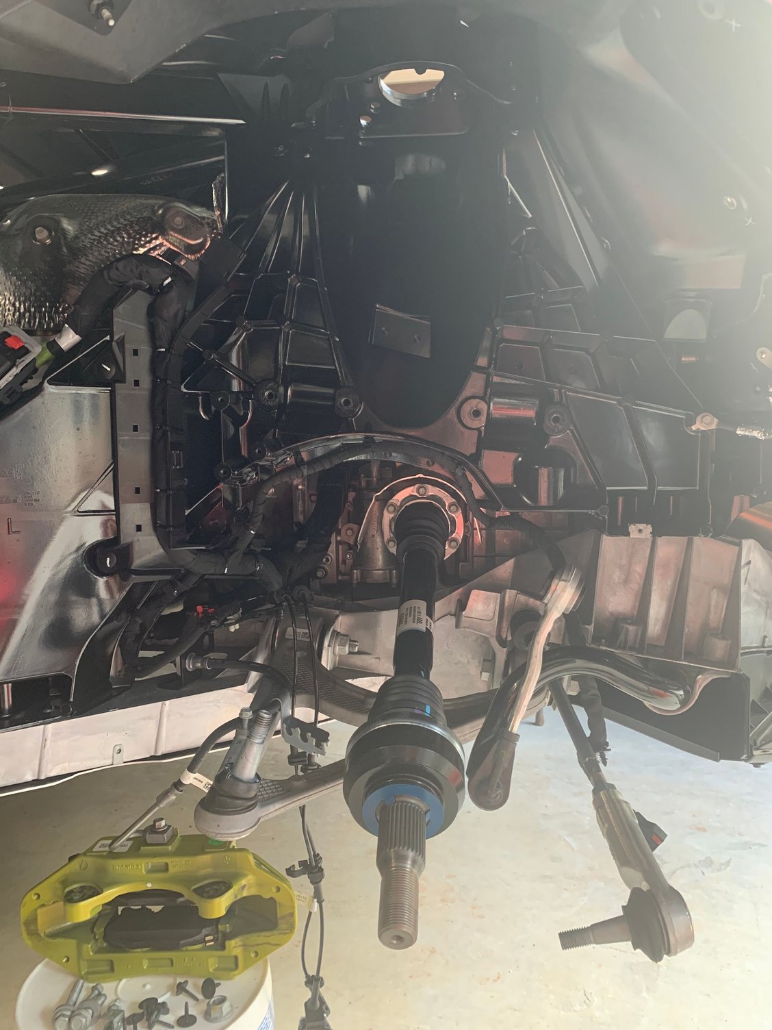

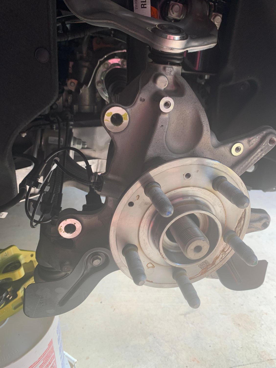

I’ve replaced with ARP’s. It’s a timely matter. The fronts are obviously easier. Remove brakes and then the hub. Which is way over torqued from the factory. The rear….. is a real pain. After removing the brakes, all arms, sway bar, and coilover the hub would not come off the CV axle with even the right tools. At least for me. But pulling the whole axle out was simply. Then I removed the hub in a vice with air punch. So for most this is probably intimidating. I also had just a little trouble with the passenger side axle (long side) getting the splines to line up and getting the snap ring all lined up. But haven’t had an issue. No reasons to fear these DCT’s. These are the only pics I have. The studs are easy to knock out and I have a 12 ton press for the rest. ARP’s are usually tight.

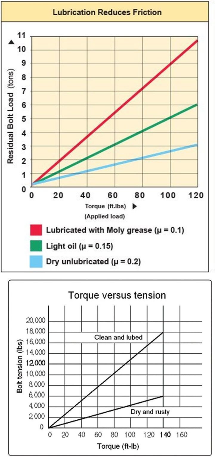

I said in post #2 "be careful about lubricating the studs!" Said that for a reason as in a recent Thread a poster justified why he always lubs studs. Frankly can understand why some living in places like I had for 7 years, NE OH where road salt corrodes studs and lug nuts might think Anti-Seize was the answer. BUT be careful and DON'T use the specified 140 ft-lbs!
See pic below. In words, if a dry stud/lug torque of 140 ft-lbs is applied and a light oil applied the bolt, the bolt load could be TWICE what is specified. With a Moly Lub over 3 times! Anti-Seize is typically like light oil but some could be more. It's a reasonable assumption that the load safety factor is 2:1 so you're close to the breaking load! Bit tricky to define exactly but some tables suggest reducing specified torque 50% if lubricant of any kind is used.
Bottom Line:
If you don't want to replace a wheel stud or pay for it to be done (looks very expensive) DON'T lubricate or use Anti-Seize
Two typical charts. The load depends on the stud size etc. But a design safety factor of 2 times is a reasonable assumption. So the stud could be way overloaded and break!

The company I used to work for did an extensive test series of thread lubricants and the effect on preload. Lubricants containing PTFE (Teflon) generally gave the highest preload vs torque. The interesting thing was that silicone grease used for lubricating o-rings was practically an anti-lube. So if you feel you really need to apply a thread lubricant on threads that have a dry torque specification, try silicone grease.
