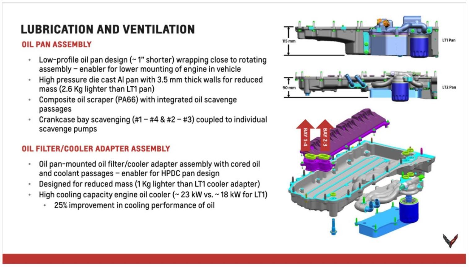

The LT2 has specific design elements to allow it sit lower than previous LT engines could:

My point is the low input shaft of the DCT transaxle with the input shaft mounted below the output shaft allows the LT2 engine to be mounted lower. The shallow oil pan and filter noted above would only provide more ground clearance if mated with a conventional transmission that has the input shaft positioned above the output shaft.
The shallow oil pan allows for adequate ground clearance when the LT2 is mated with the DCT transaxle.
My LS1 had a flat oil pan that wasn’t in the Firebird/Camaro. It’s not really a new trick to LT2’s and it’s still a modular design that can be applied to any RWD vehicle in GM’s lineup.

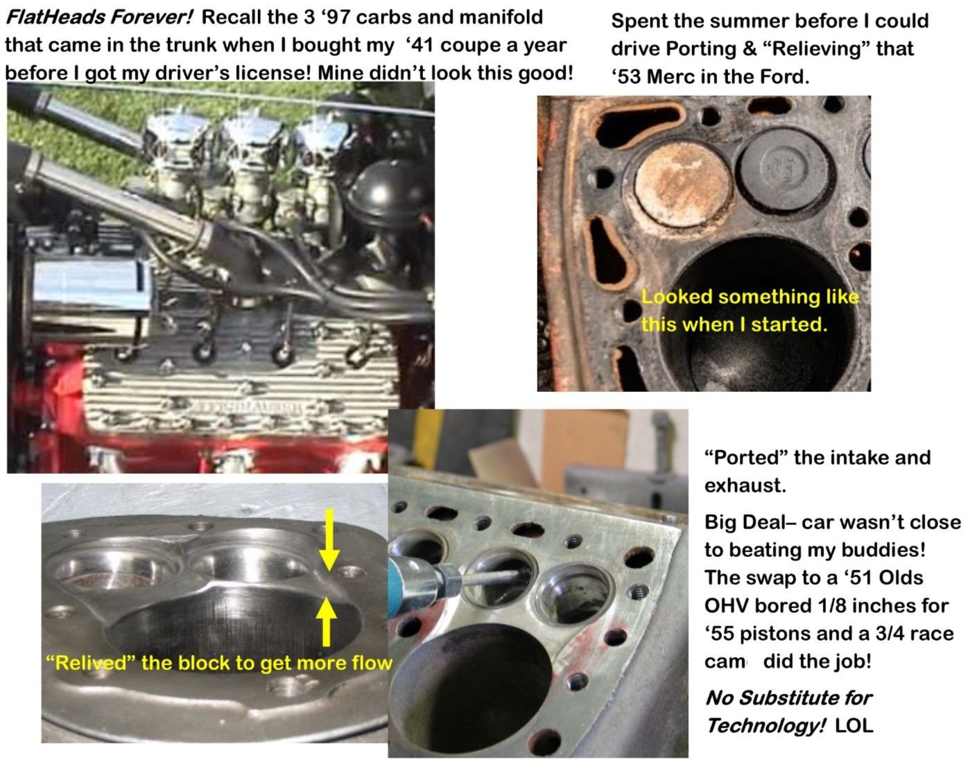

Funny at car shows there are still a few folks with Flathead Fords in Roadsters! Cost a lot more to build a flathead than to buy a modern crate engine that most use!
My first car was a 1941 Ford Business coupe; some called Opera Coupes as it had fold-down jumper seats in the rear leaving a lot of room for samples etc! It came with an economical small flathead called the V8 60 for 60 hp. It only had 136 cid. When I bought it over a year before I had my driver's license it had a 255 cid Merc flathead rated at 125 hp. I added the popular three Stromberg '97 cars and what was called "ported and releaved" the block. Doubt I got a lot more power. In any case was no match for the OHV engines in 1959 so built and early Olds engine all from parts I bought in peach baskets and had it bored 1/8 inches for '55 Olds pistons! A lot more power! Yep flatheads came in all sizes.
In fact Zora Arkus-Duntov when he first came to the US manufactured aftermarket OHV hemi heads they sold for the flathead! They were called "Ardun' heads for ARkos DUNtov!
