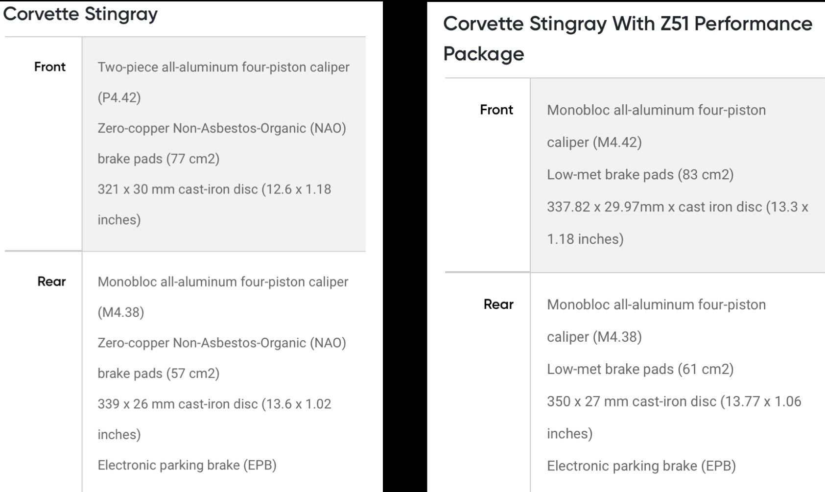

Here’s some info I found on the brake differences that you can compare to what you have.
