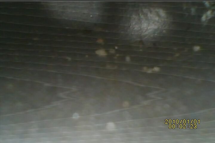

I just borescoped mine. The porosity/problem area looks perfectly clean. Previously it had an oily sheen to it and some bits of trash that looked oil soaked, but that was when it was brand new. Wasn't sure if that was a leak or not.
Haven't had my DCTF fluid level checked though.
This is the area that is most suspect for porosity problems:
This was my car with less than 200 miles on it:
Here is a DCT with a leak, you can see that area is oily, it has a reflective sheen:
I also just used the borescope to grab my data plate and pics of my DCT PAN cover.
It looks like my cover is made from aluminum, but it has been machined in some areas. Definitely doesn't look like stamped steel to me, especially in the area where it is machined. My vehicle as built in MAY 2021.

New borescope pic of the problem area:
It's a frame grab from the video (sorry, my scope sucks), but suffice it to say the mystery yellow bits are gone and it looks clean.

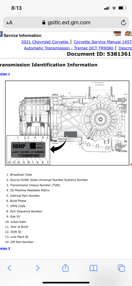

Pic of my data plate:
Example of an earlier bad DCT part# 1120350DEPX0134
Example of a new DCT that was installed to replace bad one: 11211601AEPX0013
My DCT part # 11211171AEPX0096
1AEP AMC1795F01
????5264 078418860 1210000000000X
11211171AEPX0096
Broadcast Code: 1AEP
Source DUNS: 078418860
VPPS Code: 1210000000000X
GM Part #: ????5264
Line Plant Id: 1
Shift Id: 1
Year of Build: 21
Part Sequence #: 0096
Julian Date: 171
Site Id: X
