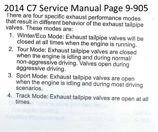

On my C7 there was 2 spots to control exhaust volume. If you ran in track mode, fully open, and you coukd set it up to be fully open all the time in all driving modes in prefernces on computer. I will disclaim though NPP woukd close during car warm up and if rolling at low rpm at times. Slight accelaration or highway driving it was fully open all the time. I am hopeful C* allows you to set exhaust to Track via computer once again.

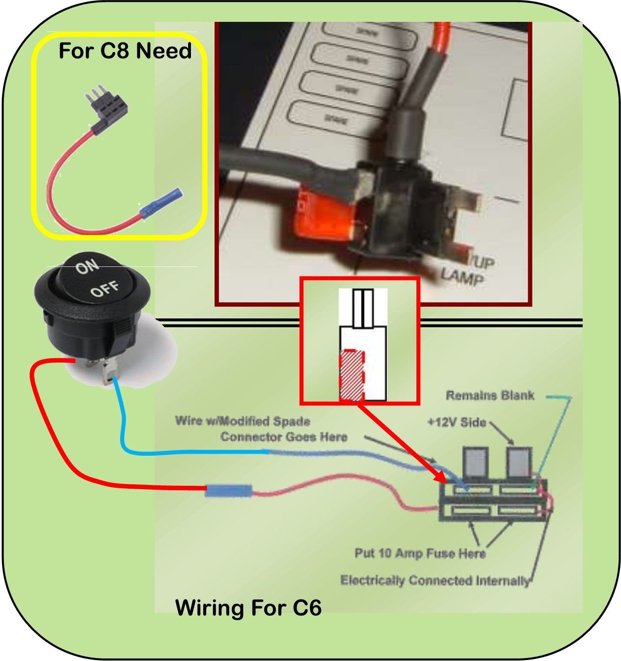

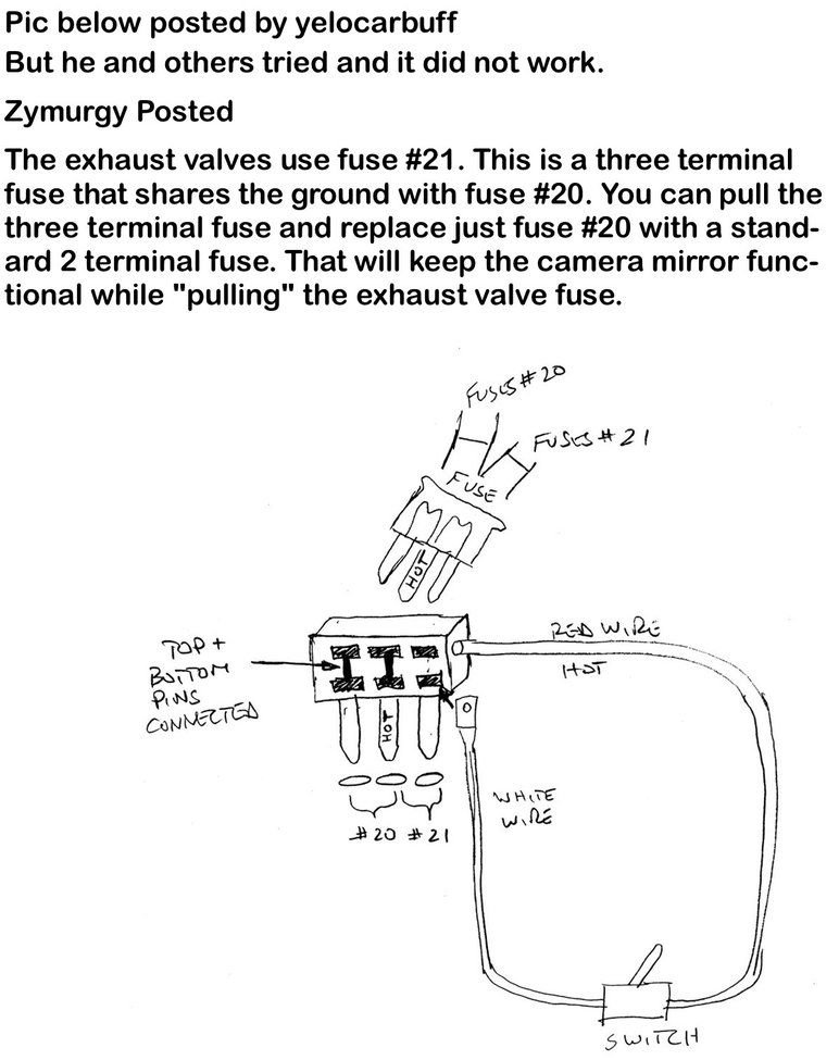

The reason pulling the fuse for opening the valves all the time is no good is because there are TWO circuits running through that fuse (in the C8). I don't know what the second use is for but we probably don't want to eliminate it. I believe this is the same reason the "Mild to Wild" doesn't work correctly in C8's
Old Feb 2, 2022 | 02:42 PM
RKCRLR's Avatar
RKCRLR
Joined: Aug 2016
Posts: 12,872
Likes: 10,281
From: Garden Valley CA
The 3 legged fuse can be replaced with a standard 2 leg fuse in the circuit that needs to remain enabled. I believe someone tried this and still had problems.

Yep, have followed since folks were trying.
Posted this pic of what I had done with my C6 and since the Fuse panel is on the back of the console thought it would be easy to add a simple switch
Yelocarbuff posted this. He and several others tried- no luck.

Regarding the attempt to bypass the part of the fuse that goes to the NPP and exhaust flow control valves, what does "it did not work" mean? Did it get louder, but throw a code? Or did it not seem to result in opening of the valves?
Old Feb 2, 2022 | 03:54 PM
Have to ask those who tried but my recollection is it did not open a close vallve.

I wonder what would happen if you both pulled the fuse and disconnected the valves. Disconnecting the valves should keep them open. Pulling the fuse may prevent the CEL. But I suspect if this were the case then the simulators wouldn't exist.

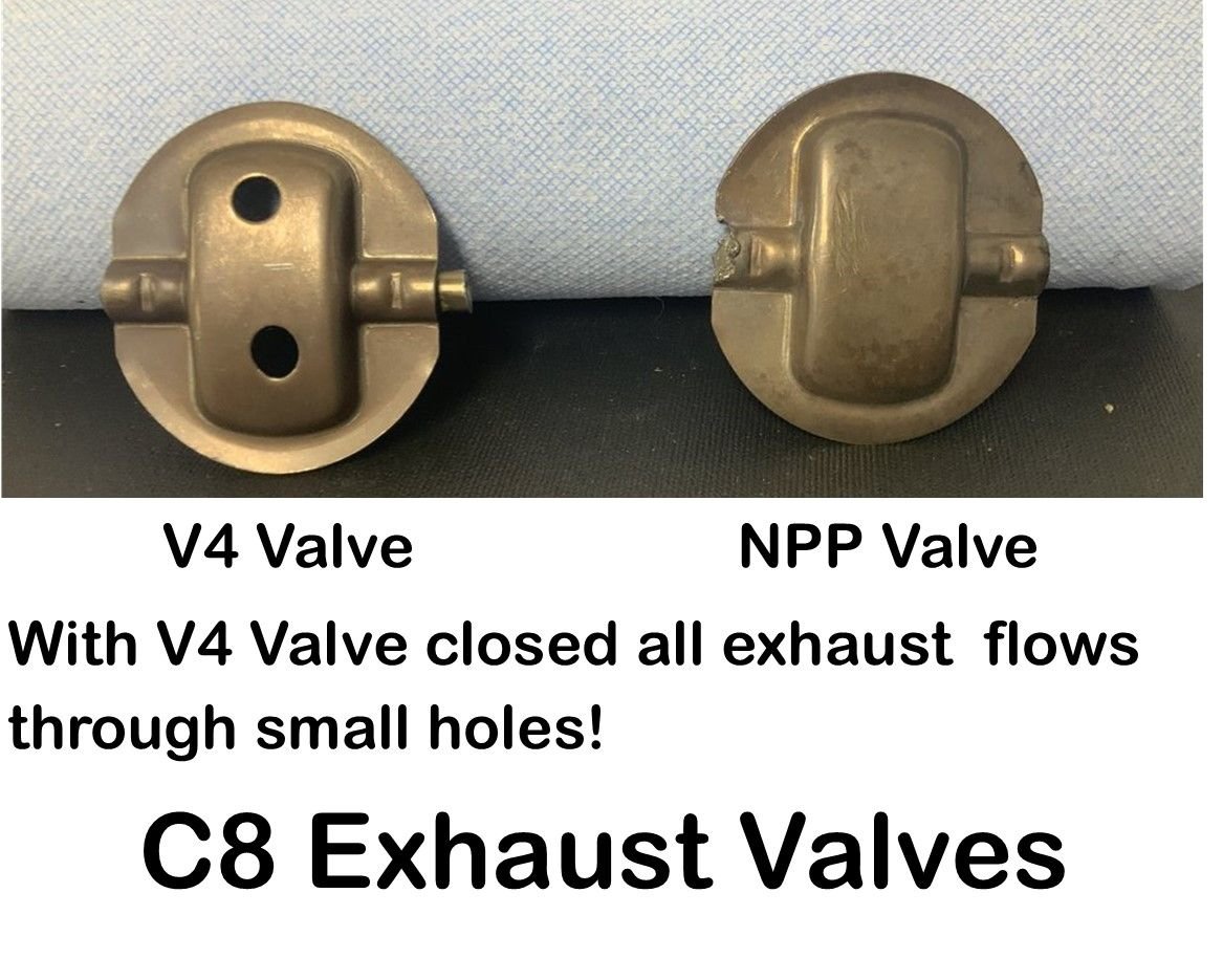

On the C7 if you unplugged the V4 valves or blocked them from activating, it would trip a CEL BUT not the NPP valves. Don't know about the C8 as no one has been successful. However looking at the C8 V4 valve can understand why if it did not return in V8 mode it would be a problem (see pic.)
These are the two exhaust valve butterflies. Note in V4 mode the valve closes and all exhaust must go thorough the two small holes. Logical as with the ~25/35 hp it's probably all it's producing in V4 to overcome the aerodynamic drag and tire rolling resistance drag. As I recall above about 75 mph where those forces start to increase significantly it will be in V8 mode. Also if on a modest incline it switches to V8 mode. So if the valve was closed and it went into V8 mode the exhaust back pressure would cause issues! For NPP if the valve did not open it's like a car without NPP
I'm afraid this discussion will be just like it was with the C7 until a number of folks with Mild to Wild who toggled between open and closed and reported the sound difference we're reading the GM manuals and trying to draw a conclusion. Just checked my 2014 C7 4 volume paper manual and this is what it says. That is what created the discussions early until as I said several with Mild to Wild proved in Track the vales do not open until about 1700 rpm!
Yep as noted it says in Track the valves are opened at all times!

The C8 NPP valves are not open 100% of the time.
The only way to have them open 100% of the time with no CEL is to install the NPP simulators as defined in POST#23 above.
C8 service manual: (Be sure to read the Note: after reading 3-SPORT and 4-TRACK)

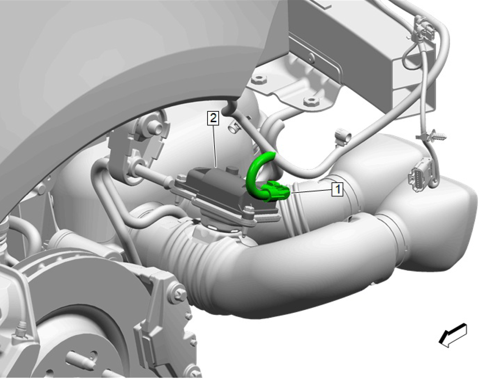

I found, in the 2020 Service Manual, what appears be two sets of exhaust flow control valves that will affect the sound. One pair are between the CATs and the muffler, the other pair are in the tail pipes. The pair between the CATs and muffler are associated with the AFM. The pair in the tail pipe are associated with NPP. According to the 2020 Service Manual, when AFM is active, it will take control of the tailpipe exhaust flow control valves and close them. It also apparently activates the other pair of valves that are between the CATs and the muffler. I have attached the exhaust flow control control valve schematic. I think the actuators associated with AFM are the two components on the lower left. The two on the lower right are the tail pipe actuators (I think). I highlighted the paths providing power to the actuators in red. Note that the fuse being discussed is in the power path only for the tail pipe actuators, meaning pulling it, or replacing it with a switch will not disable the AFM exhaust flow control valves, and so they will continue to open and close if/when AFM is activated (as a minimum). I also highlighted what I believe are the control paths, in blue. Control appear to come from the fuel pump power control module to all of the actuators. And in-turn, control appears to come from the Engine Control Module (ECM) to the fuel pump power control module. The control paths from the fuel pump power control module to the two actuators on the lower right show the wires going though a box labeled NPP. The power path to those, from the fuse, also shows the wire going through a box labeled NPP. Notice too that there appears to be a control path coming back from the AFM associated actuators to the fuel pump power control module.
I also attached photos showing the valve locations and the connectors, and also some other photos that might be of interest.
Exhaust Flow Control Valve Schematic
Green Circle - Tailpipe Exhaust Flow Control Valves. Red Circle - Exhaust Flow Control Valves associated with AFM.
Here is the tailpipe exhaust flow control valve connector.
Show actuator removed from the valve.
Shows connectors to the AFM associated exhaust flow control valves.
Linkage to the AFM associated exhaust flow control valves can be disconnected.
