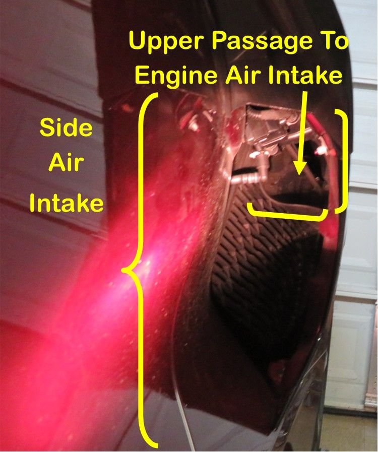

This is a good video where Tadge discusses engine and exhaust noise! As he has said previously, they found that a "Ferrari they dissected" had a 9 mm thick rear cabin window and they copied. It's >twice as thick as a windshield for one reason NOISE! As he notes the noisy part of the engine it right behind you so they insulated very well.
Perhaps someone will replace that window with the thickness of the side window. In another interview Tadge mentioned the routed the "good intake air sound" close to that window so you could hear it!! I put a pic of the passage!
As Tage described they wanted as much "Good Intake" sound to get into the cabin so they had it Pass closer to the side glass, which is thin compared to the 9 mm carbon glass! When I added a low restriction air filter checked the passage as Tadge described! Ran my flexible fiberoptic cable from the filter housing!
