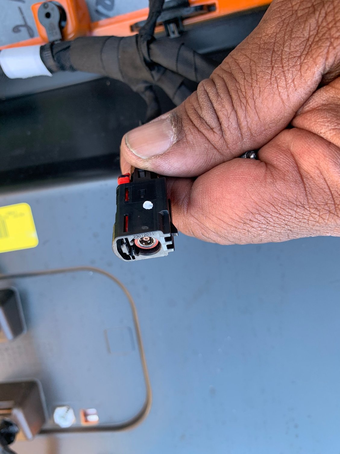

My Amplify Orange High Wing finally arrived. Lowering the car 3/4” went so well, and there are plenty of u tube videos, so I decided to install it myself. After removing what seemed hundreds of screws and nuts, the bumper was ready to come off. Oops, the table was too far below the car. Of the three connectors, the coax cable for the rear camera was the shortest. Of course the weight of the bumper pulled the coax right out of the connector. I tried to repair it, but I only destroyed the connector. Now I have no rear backup camera. I need help. Is the original connector available? Part number? Is there a way to splice this mini coax cable? I may be removing the bumper again for exhaust mods, so maybe I can lengthen the cable. Help please.

You can probably get a cable connector and extra cable. Then reuse that connection if it's not damaged. Good luck.

I don't think he can, that's a mini coax and there is a center conductor with an insulator around it and then a full perimeter ground mesh. We do RG59 coax at work every day (similar to cable TV size) but I've never seen a mini coax connector tool or fittings. They obviously exist, but not common.

I would imagine the nearest dealer parts department will have a schematic for that wiring & tell you if available to order. It MIGHT be same as for C7 rear camera wiring. Good luck 🍀

If you Google that number on the edge of the connector (try connector 2307207-1), you'll get some hits but they are all in China selling them in bulk.

I did the same thing on my 2022 coupe. GM now makes a backup camera harness, part 84852715. Ebay,Amazon, etc.
