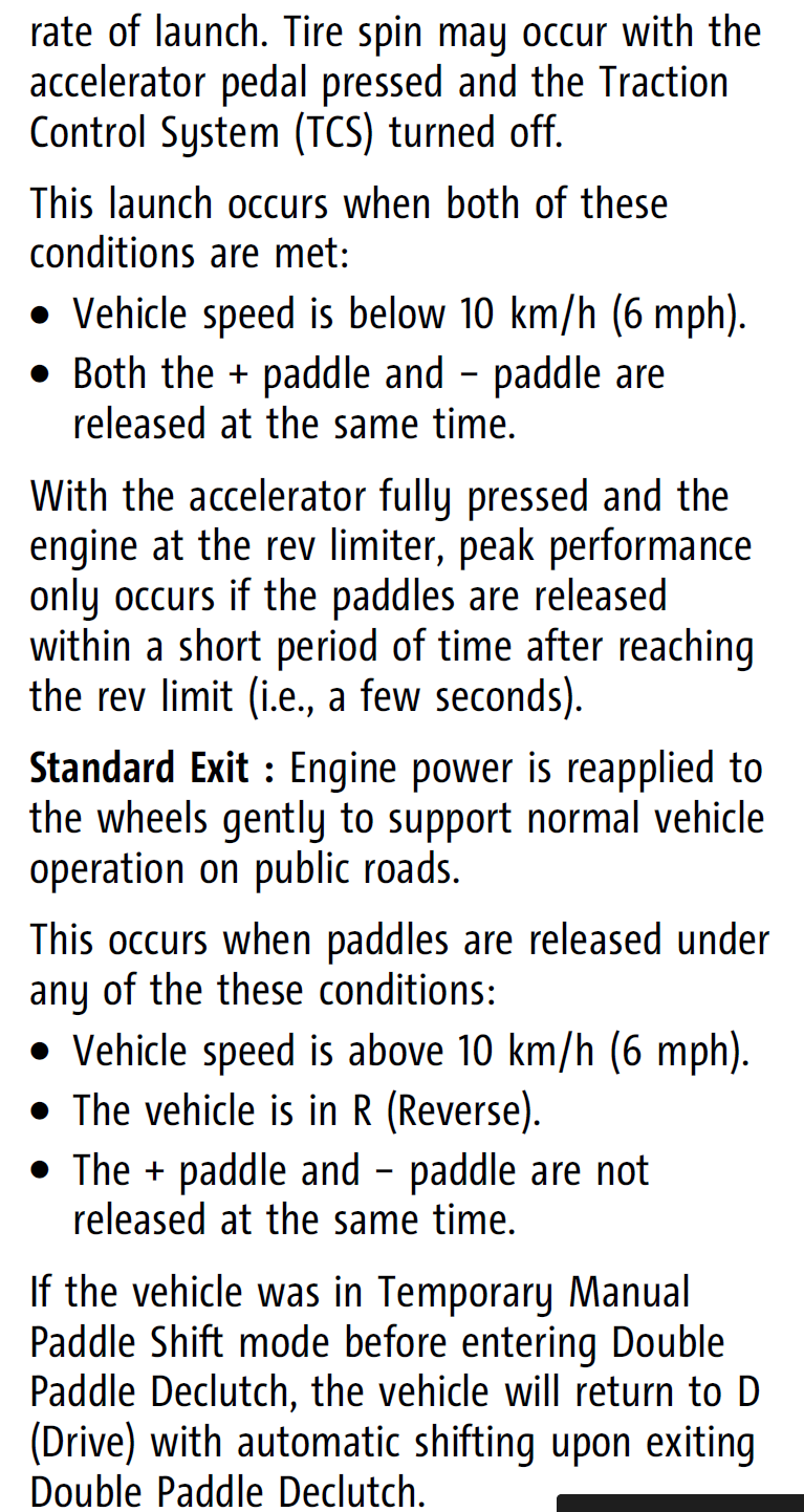

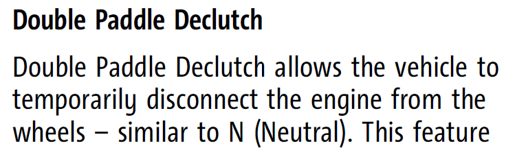

Hmm, you can rev the engine with the paddles pulled:
"The mid-engine C8 can be declutched when both steering wheel-mounted paddles are pulled at the same time. Pulling both paddles effectively engages neutral, but doesn't require owners to hunt for the button amid many buttons."
Try that with just the brake pushed hard and it will try to move forward! Will have to try with my "just right paddle pulled."

Here's another thing to try. With the car stopped in gear on level ground, pull both paddles back and note that the RPMs don't increase. Now let off the brake pedal and note that the car doesn't move and the RPMs don't increase. Now let off the paddles. The RPMs will start to increase and the car will start moving, in that order. If there were constant significant torque on the clutch pack the car would start to move and then RPMs would increase similar to how a car with an automatic transmission works.

Just was in town and tried several things:
Yep pull both paddles and it's in neutral. Can tell as the dash does not display that it's in a gear. Stop. release the left paddle and it stays in Neutral. You can rev the engine. Try that with just the brake pressed hard and as expected the rpm's increase and it's trying to pull the car forward.
Tried releasing the right paddle and holding the left and again stays in neural as you can see buy no gear selected and you can rev the engine to whatever. So it's not just the right paddle but either as someone stated. Programmers can do whatever they want BUT it's staying in Neutral until both paddles are released.

I notice something else about rapid exit mode (from the double paddle declutch) while reviewing that section (again). While we have noted that after pulling both paddles, the car will not "exit" the "double paddle declutch" condition until both (not just one) paddles are released, the discussion that follows regarding rapid exit and standard exit (from the double paddle declutch condition) seems to say that both paddles have to be released at the same time for the rapid exit mode, and that the standard exit will happen if the paddles are not released at the same time. I think it suggest that one should not pull both paddles, release one, and then subsequently attempt the rapid exit procedure (which involve full throttle) by releasing the remaining paddle. Not that anyone would attempt that......
