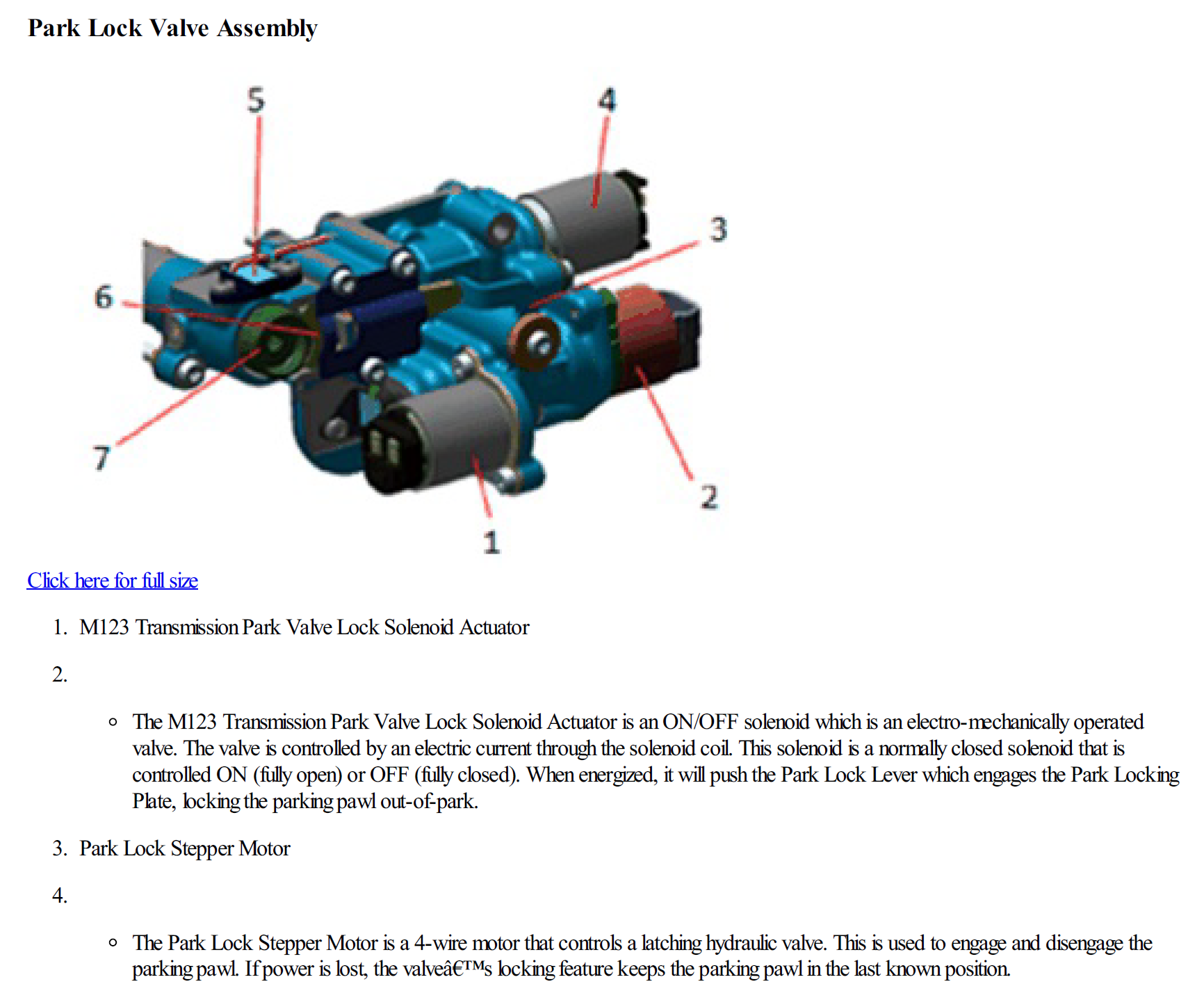

I stumbled across this in the sevice manual while trying to find out what is said about "double paddle declutch". Did not find much on that , but here is something about the parking pawl. Notice what is says about keeping it in the last known position if power is lost. Made me wonder if there could be a workaround, other than the procedures in the manual. But I doubt it.

This suggests that it may be possible to put the car into into neutral if the engine dies. But one would have to follow the procedure in the manual as if the engine was still running. It you open the door or push the park or start/stop buttons before following the procedure then you would be screwed. Hard to keep focused on this when you are in a predicament. The only way to find out if it is possible is to somehow kill the engine without following the normal procedures and try it.

Yeah. I was wondering though if "power" means engine off, or ignition off, or possibly meaning battery power (all electrical power).

I suspect that if you lost all electrical power while driving you'd be able to move the car after it stopped.

Based on what has been posted online (which may or may not be accurate), I think the solenoid opens or closes a hydraulic circuit, rather than operating the pawl directly. The term "valve" implies some sort of fluid control, not electric. If it operated the pawl directly, I don't see why you'd need the engine running to get it out of park.
