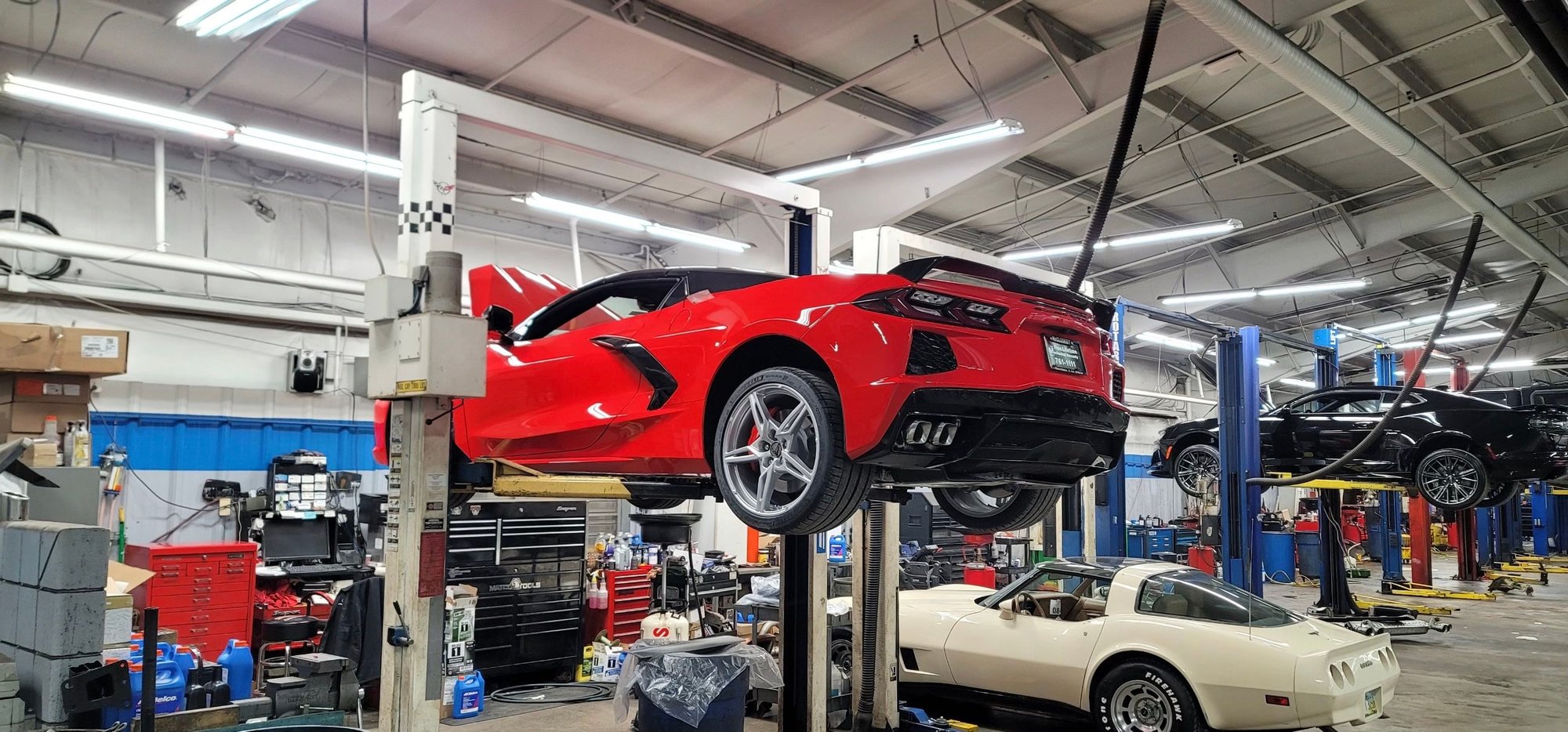

A Chevy dealer will have everything they need to get the car in the air. Buy the pucks if you like to do things yourself, or in case of an emergency.

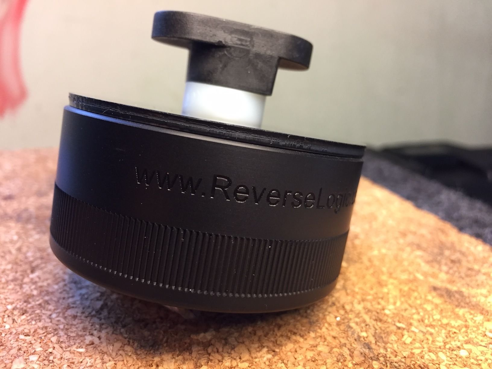

Since I sometimes do my own work on the car, I purchased a set of
lifting pucks lifting pucks
(I do not know why the link goes to Walmart when I got them from Amazon) and leave them installed since they bolt in place. I was just in for my first 7,500 miles service yesterday and told the dealer they were installed, which they seemed to appreciate and used them with no problem. Like you will see above, it is not really the dealer you need to worry about (usually), it will be the time where you have a tire blow out or working on it at home where you will want to have a lifting puck handy at a moments notice. The other big benefit of having the pucks installed all the time is that there is less chance of a shop trying to lift the car using the wrong lifting point. Since I chose the red color pucks it is pretty obvious where to place the lift pads to raise the car.

Is there a good reason to pick aluminum (I assume those in the Amazon link above are) vs the rubber kind? I kind of like the idea of the bolt in place.

In my opinon, not really. I have three different sets. An extra tall aluminum set, two inches tall, which I thought would be necessary due to my, now removed, side skirts. They are beautiful but unnecessary and, in fact, although they can be used with a floor jack, they are too tall for use with my lift as I cannot get the lift arms under them since the arms are about 4 inches off the ground. They were about $89. A regular height rubber set which I bought off of Amazon for $19.99 for the C5, C6 & C7 but which, as noted elsewhere, also fit the C8. These are my go to pucks, cheap and effective. I believe they were called the Mapleza Jack Pad Lifting Kit or something to that effect. I also have another set of hard plastic very short pucks, which I have spray painted flourescent orange and keep in the frunk in case I am ever out anywhere and need to have the car lifted. They are actually for BMWs but snap right into the later generation Corvette jacking puck holes and are about the same 2 inch diameter size as the stock jacking pucks. They snap in the hole and then can be pulled out once you are done. As I mentioned, these are just in case I am not at home and need to get the car lifted. I looked briefly but could not find the information on them. If anyone is really interested, please PM me and I will look further.

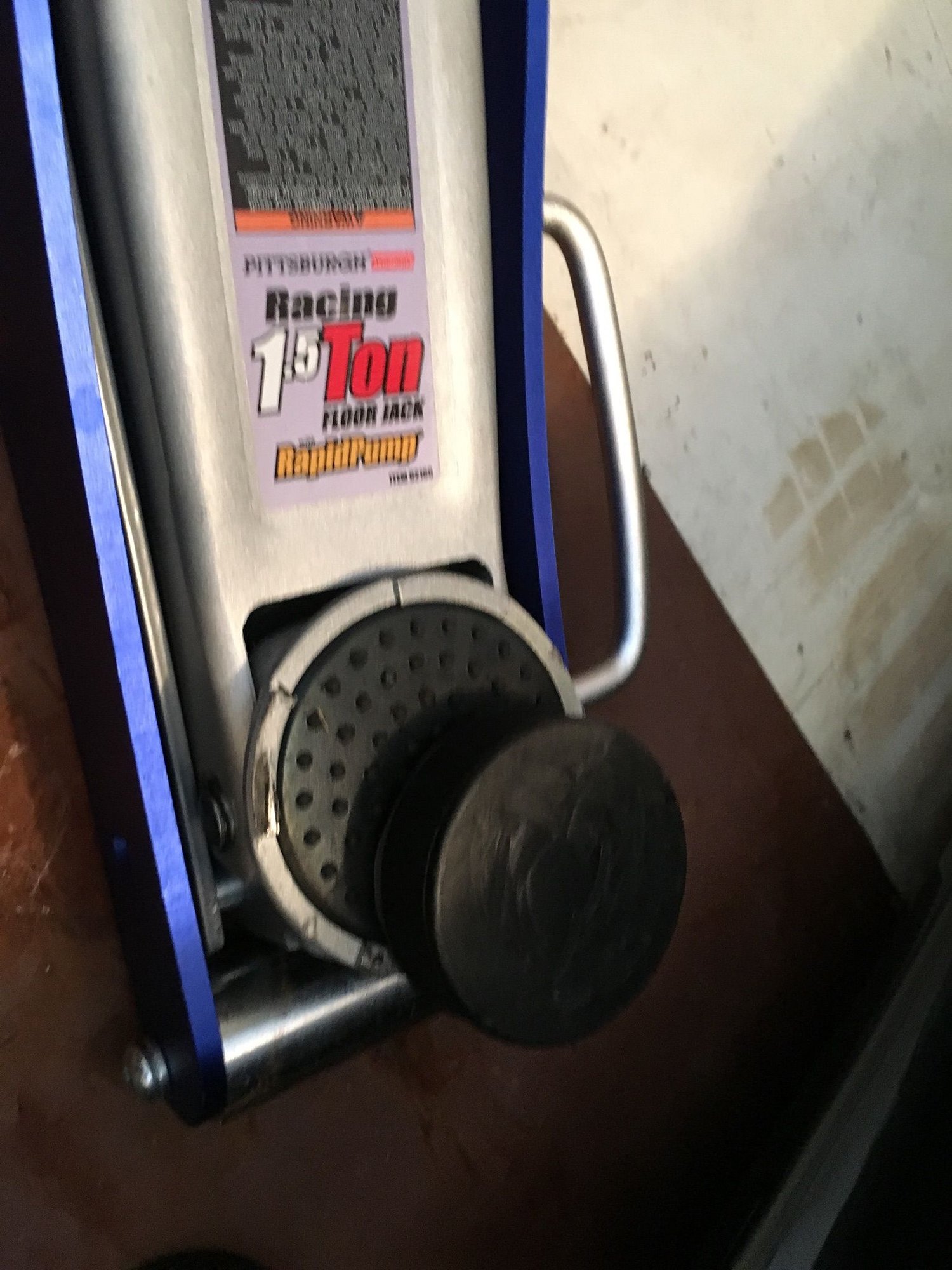

This. Hockey pucks work perfectly for DIY stuff at home.

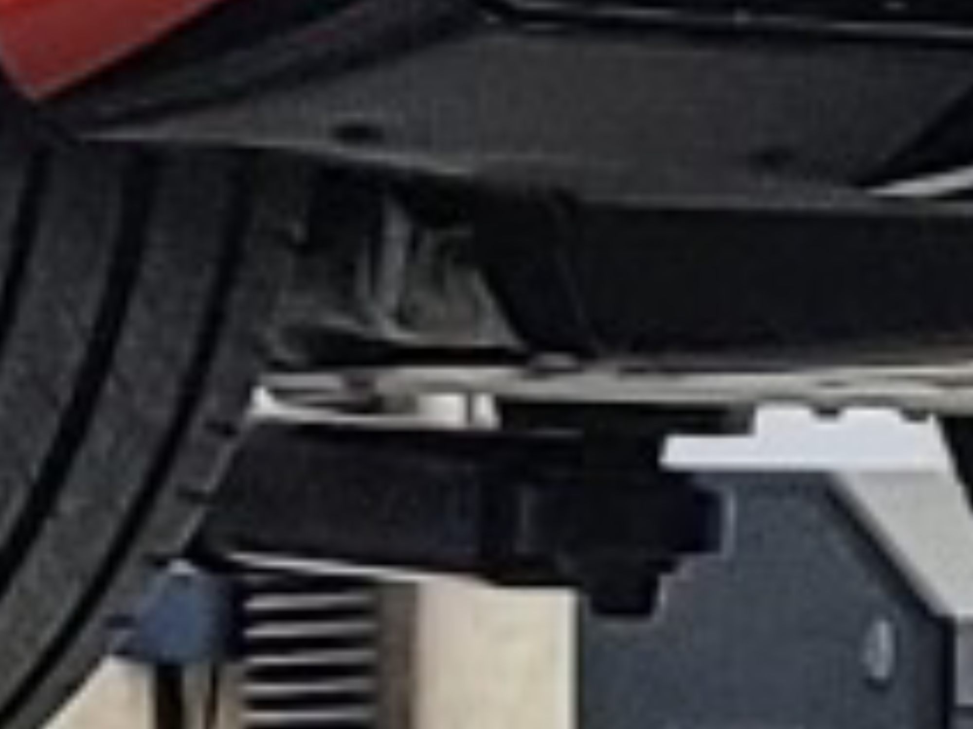

Does it look like the dealer used the lifting pads or not?

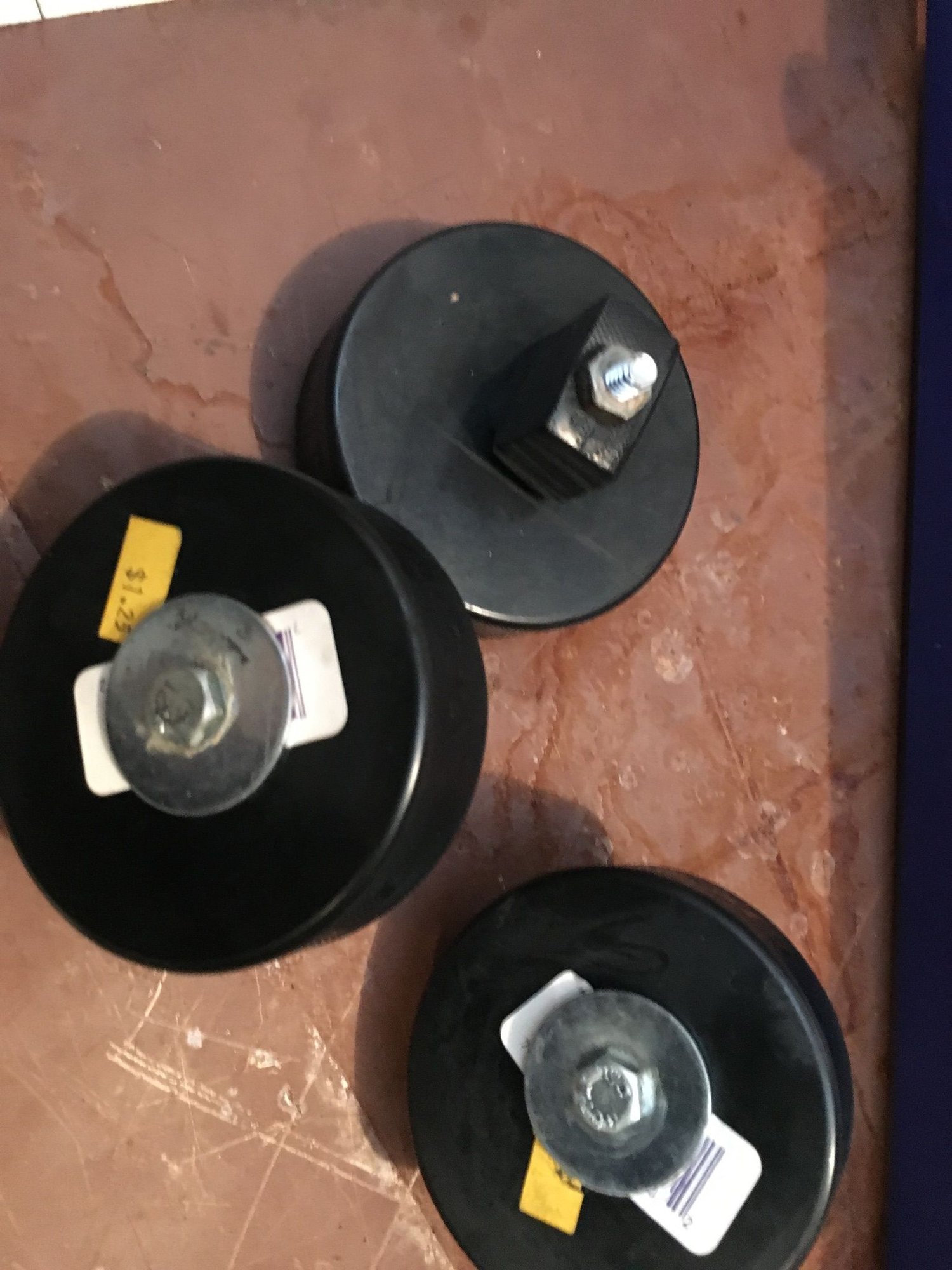

One of the first things I did when I finally after 13 1/2 months and I drove my C8 Corvette home was to install a set of "permanent" screwed in jacking pucks. I have told everyone who decides to do this to make sure they put Loctite on the adjusting screws after locating them.
