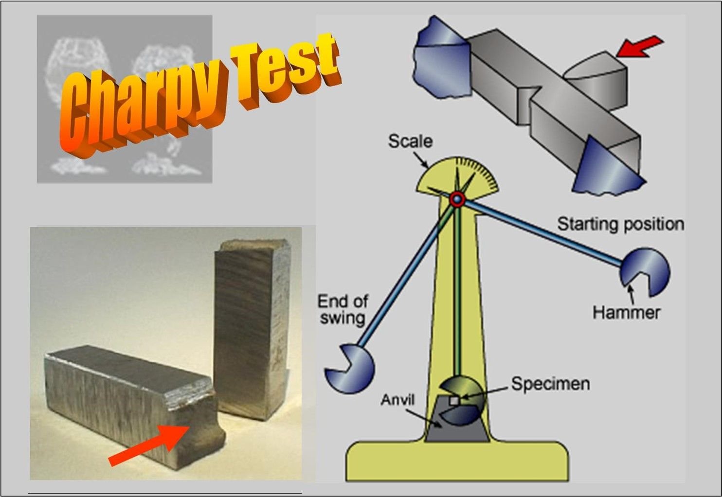

BUT I clearly said I wait until the engine oil is up to temperature before I use significant power. That takes quite a while. I presented that valve springs, particularly in a high performance car iike the C8, can use 300,000 psi strength steel. Gave a comparison that a steel bridge uses only ~50,000 psi strength steel. Steel has a property (unlike say aluminum) where at cold temps it can be as brittle as glass! The stronger the steel that brittle/ductile transition can be quite high MUCH higher then a few minute warm up will achieve. I said I will not get near redline unless the oil temp (which I monitor) is past 175F! NOT coolant temp which gets hot quicker.
Nope I don't wait even 30 seconds before I drive BUT would never use significant power until the oil is ~175F or higher. I have Oil, Trans and Coolant temp displayed on the left side of the dash! Yep a little Metallurgy 101 with these posts!
Some ship failures were attributed to brittle steel (like WWII Liberty Ships and perhaps the Titanic)
Common Steel Property Test To Define The Brittle/Ductile Transition Temp.

As a structural steel fabricator, I understand "charpy v notch" testing. Just like you, I will not punch the throttle until all fluids have come up to "operating temp", same with tires...
