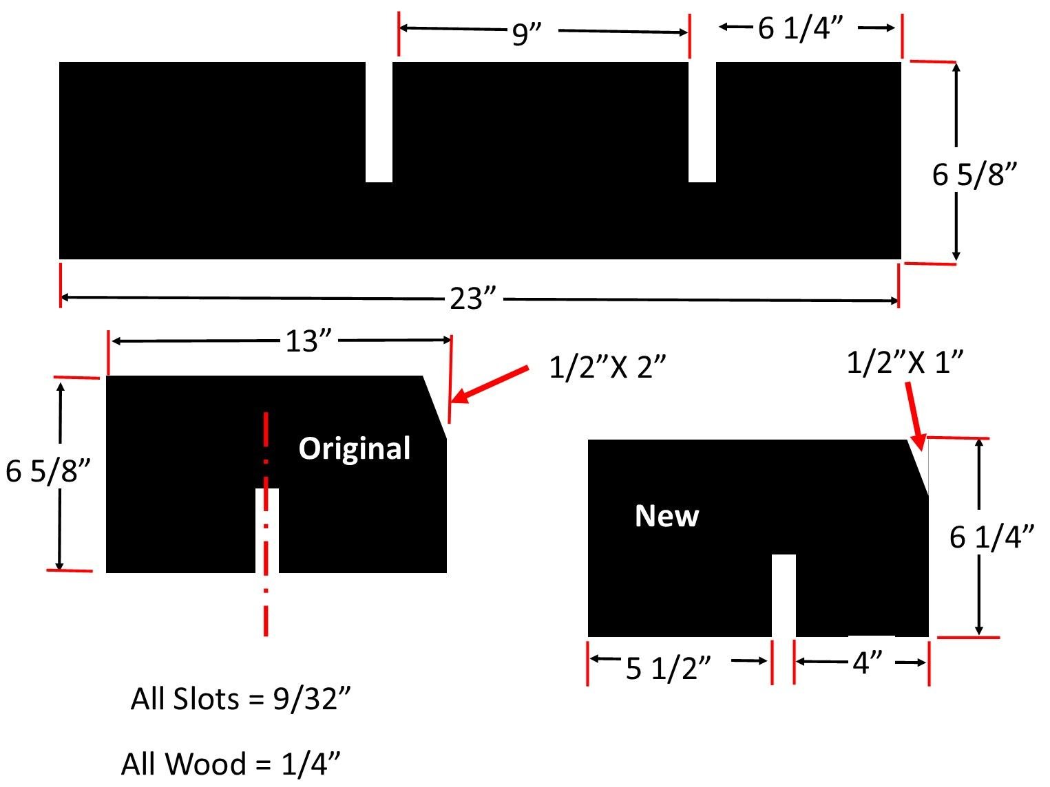

Wife and I left a restaurant and had a doggy bag with a plastic clamshell holding a hot leftover meal. Thought Truck will be fine with its flat floor (have a tool bag in the Frunk.) Got home and bag had slide sideways into the "hole on one side!" Contents had spilled but some was caught in the bag AND I have the GM Jake Rubber truck mat! Clean-up was easy. BUT decided I needed what I had in my two C7's when carrying things like a milk carton. Bought a carrier that measurements showed would fit BUT the odd shapes of the trunk had it too high in the rear, which is tapered. Fortunately, was from Amazon so sent it back!
This is what I built, modified from my C7:

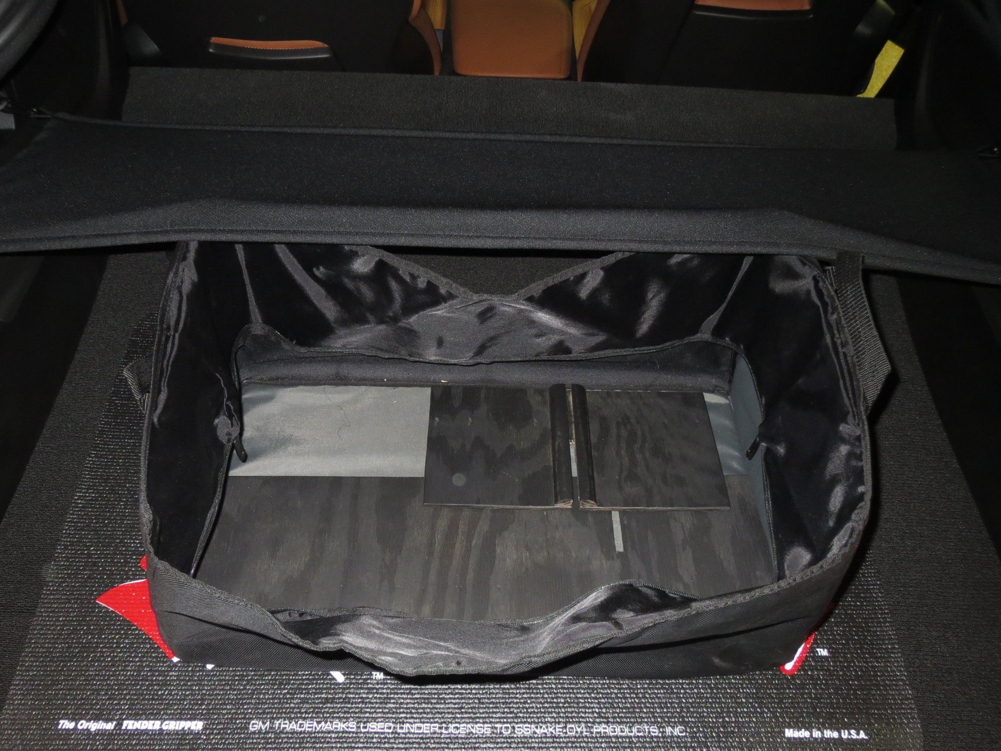

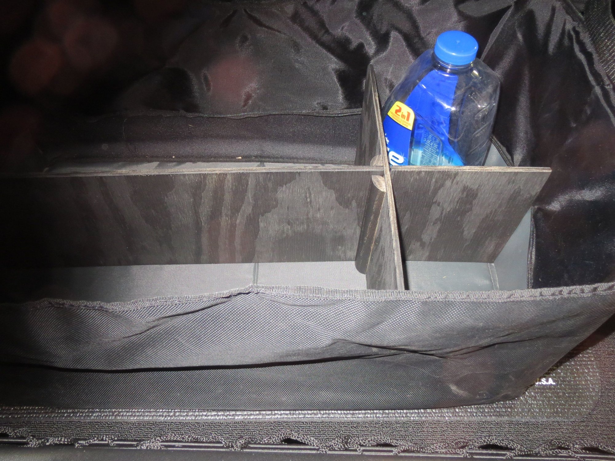

Used in C7s. Fits in Ballistic Nylon carrier
Folds flat when not in use, as does Nylon carrier

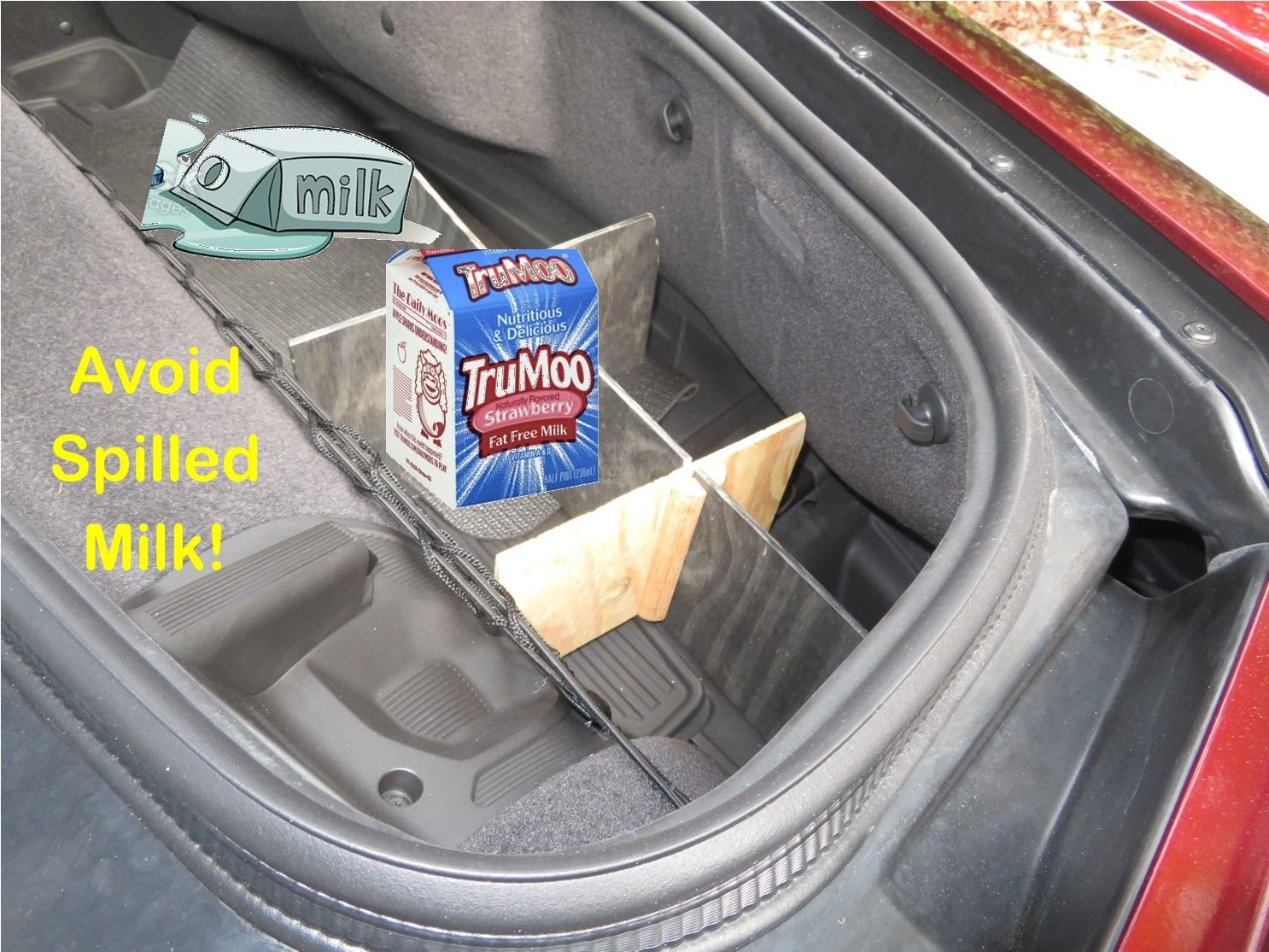

Modified for C8. Note Trunk rear is tapered so had to trim. Purchased narrow Nylon carrier but was too high in rear and was returned.

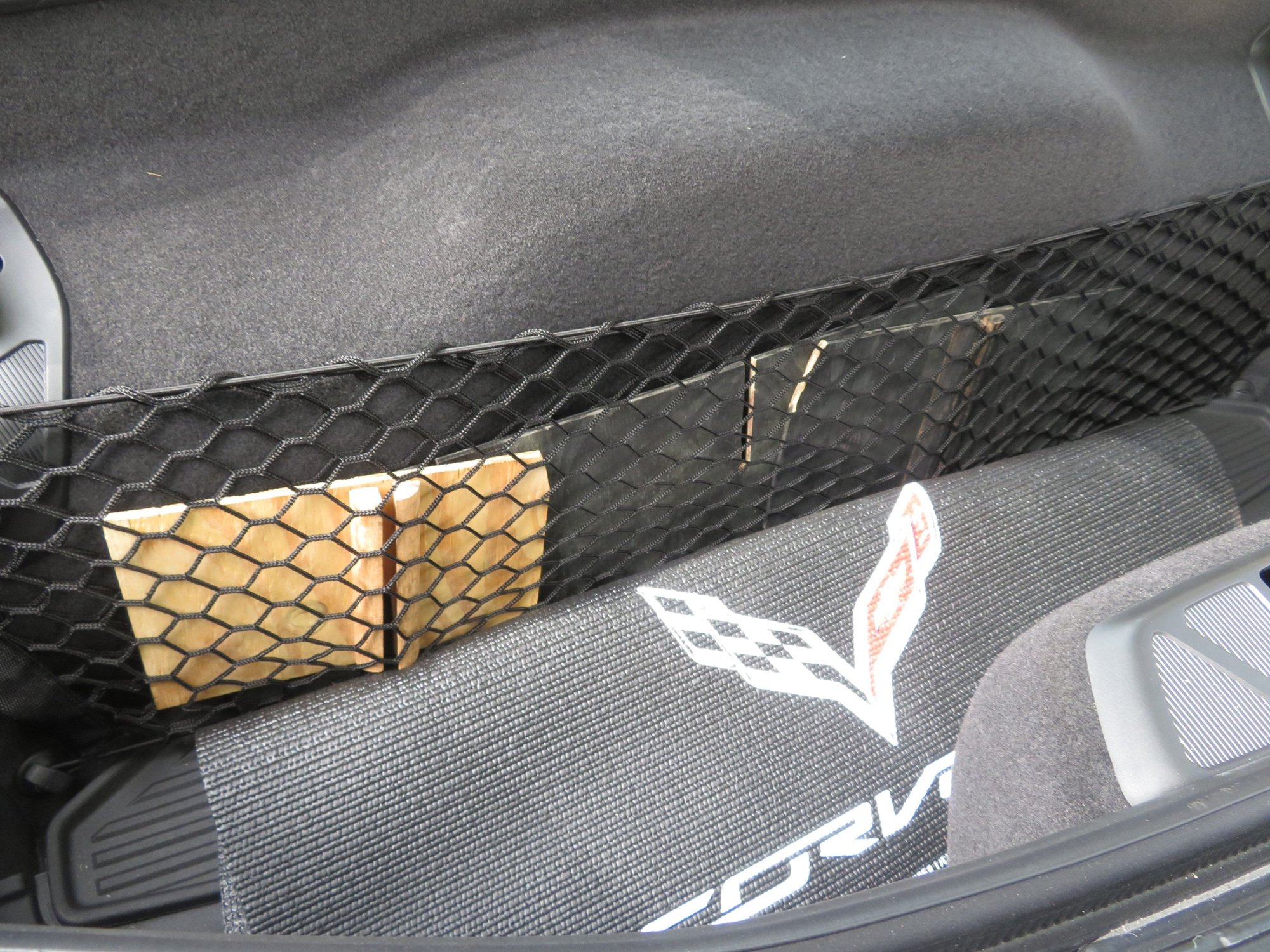

When not in use, parts disassemble in seconds and fit flat in net. BTW, that folded fender cover is what I use when lifting heavy stuff over the rear Z51 wing. Helps with bulky things like golf bags. It has a high friction bottom that holds on wing. Inexpensive.
If interested this is from a PDF I also have but all you need to understand the build
