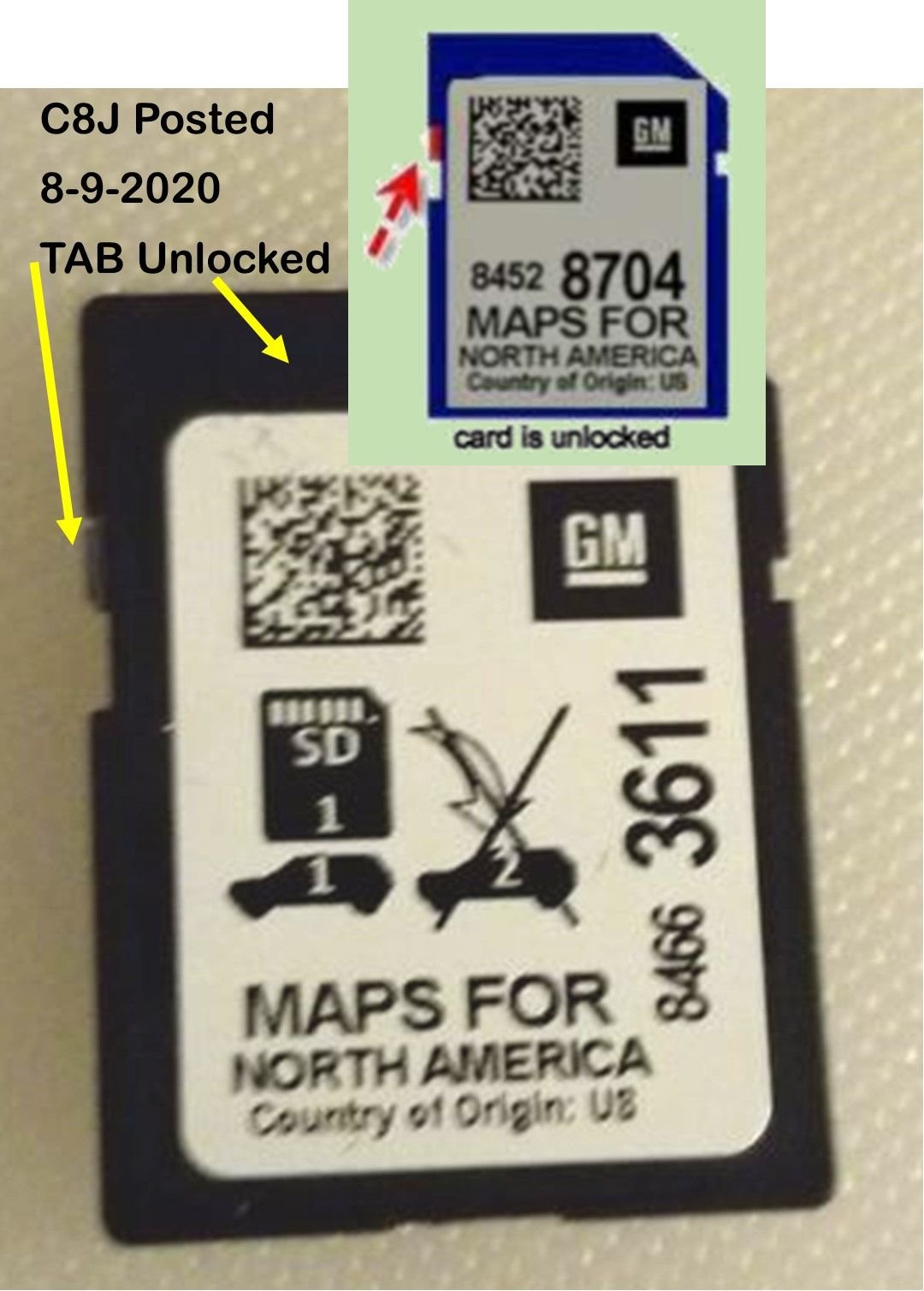

Reloaded all my songs on a new high speed Thumb Drive to see if speed would help.
Decided to use the new GM NAV Card I purchased. It came in the Unlocked position!
I had moved the Tab in the OEM 2020 Nav SD card that came with my 2020 from the locked to unlocked position! Or I'm 90% sure it came locked! So looked and found a good pic of a 2020 NAV SD card posted by CJ8. It shows the Tab in the unlocked position.
Started the car and all worked fine, got music and No SD Card Removed message. Doesn't mean a lot, we'll have to see how often I get the message (hope never!)
I Thought My Original NAV SD Card Came Locked and I Unlocked It! But This Pic From CJ8 of His Card Shows It Unlocked. ???? Anyone have a 2020 NAV Card and can look?
