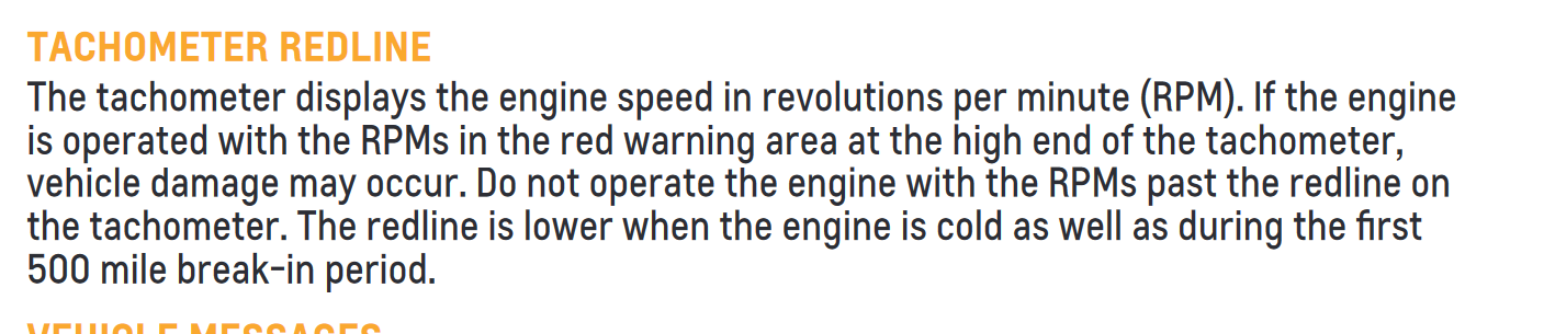

After the 500-mile reduced red line went away, upon a cold startup (Car not driven for 24 hours) my 2022 Z51 never indicated a reduced redline until the engine warmed up like my C7 showed. I am assuming it's a software issue but before I go to the dealer do all 2022's have the reduced redline appear until engine temperature is approximately 165 degrees like in the C7.
Looked in the owner's manual but the only reference I could fine was in the pamphlet "Getting to Know Your 2022 Corvette Performance Features" on page 2.
Thanks

Originally Posted by HJHorton
....... the only reference I could fine was in the pamphlet "Getting to Know Your 2022 Corvette Performance Features" on page 2.Thanks
As I mentioned above, my 2021 does show a reduced redline. And based on the reference guide for the 2022, it appears that the 2022 is supposed to do the same thing. If it is not, it would appear there is some issue.
