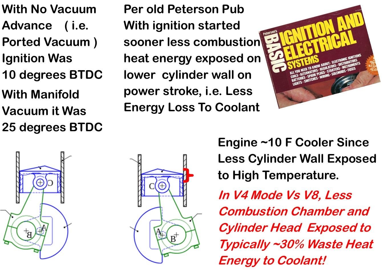

I'll give one I observed an IMO is a factor. Can't quantify for hp but can an issue with cylinder wall heat extraction from combustion!

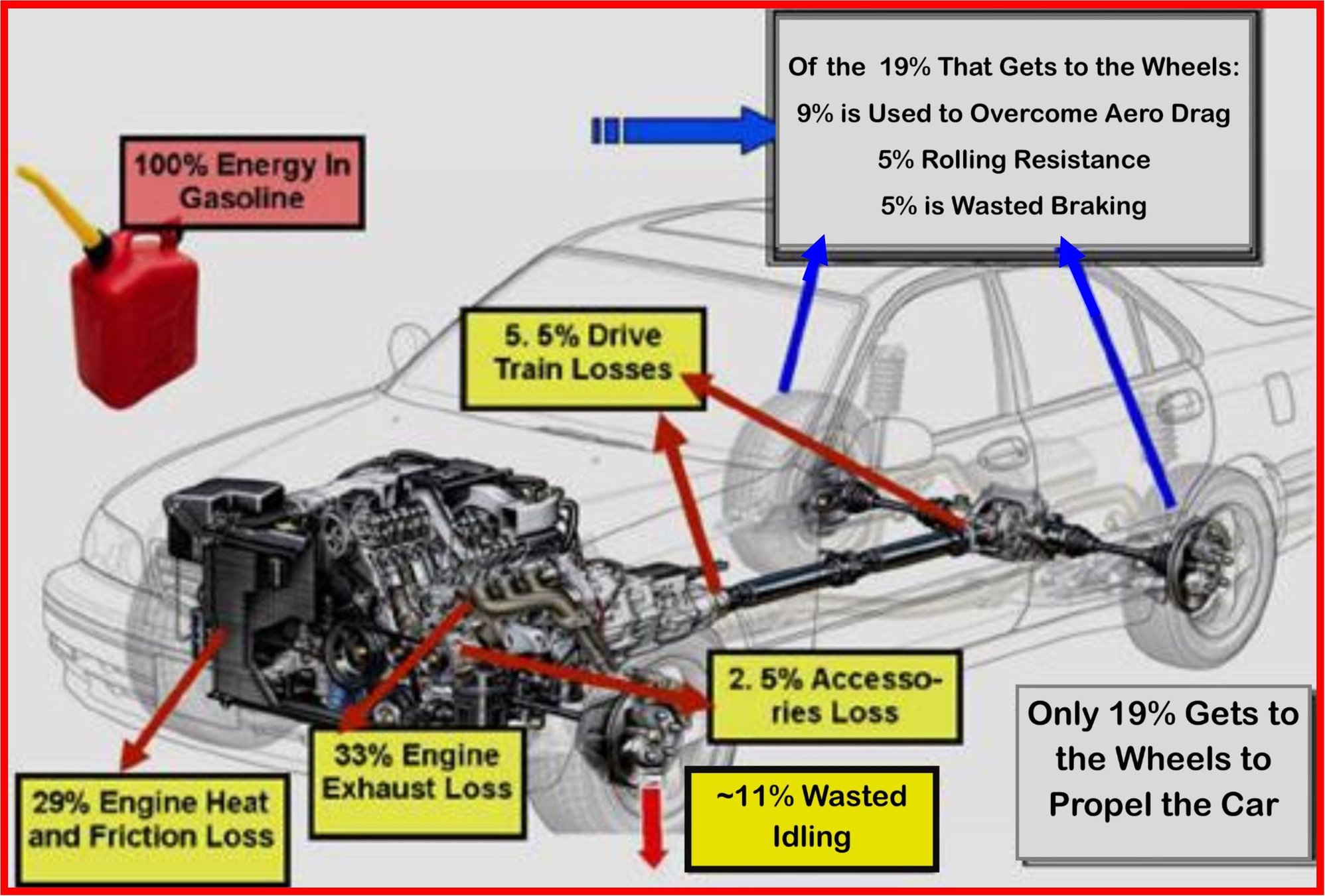

First an ICE is very inefficient. Much of the energy in gasoline goes into wasted heat! From the pic below, 29% of the energy in gasoline goes into the coolant. That comes from the ~2500 F combustion gases conducting into the cylinder walls and combustion chamber.
Second, I lowered the coolant temp when stopped idling in the ~525 hp 8.2 Liter BB in my '34 Ford with a thicker aluminum rad BUT same height and width as Henry used for his <100 hp 3.6 Liter flathead! Note cooling temps were fine when moving with the aluminum multitude Griffin rad, 6 blade high pitch engine fan and car moving so air was going thru the rad. But even with the two electric fans turned on in front of the AC Condenser helping at very slow speeds or stopped idling coolant was increasing to 220 F on a hot day.
An old Peterson pub re ignition provided the solution! The 502 crate motor used a ported vacuum advance (as most modern cars) versus manifold vacuum. It discussed when that change occurred, it was to reduce emissions. Prior cars used manifold vacuum to activate the distributor advance. Quoting from my website below (that also shows the result.) "Using "Manifold Vacuum" the spark at idle will occur sooner and "less cylinder wall is exposed on the power stroke to the heat (of combustion), thereby lowering coolant temperature." Interpreting their statement, with more advance at idle, the combustion starts on the upper portion of the cylinder on the compression stroke. Flame front travels very slowly at the low cylinder pressure that occur when idling. Therefore the cylinder head and upper cylinder walls will absorb most of the combustion heat and the lower portion of the cylinder on the power stroke will be cooler. This transfers less total heat to the cooling system!
BOTTOM LINE RE AN ENERGY EFFICIENY ADVANTAGE OF V4 0VER V8
So with no combustion in 4 of 8 cylinders there is less energy loss to the coolant as no heat is transferring from those combustion chambers and cylinder walls to the coolant!
How much? Don't know but certainly a factor.
SIDEBAR
These are details from my website:The Chevy Crate Motor instructions say to use "Ported Vacuum" to connect to the distributor vacuum advance diaphragm. This means there will be no vacuum present at idle. This port comes from above the butterfly's in the carb. Therefore until the throttle is open, there is essentially no vacuum in this port to activate the distributor advance mechanism.
However and old Peterson publication entitled "Basic Ignition and Electrical Systems" reviews the history of "Manifold" versus "Ported" vacuum. As they indicate, "Ported Vacuum" came about during the start of pollution controlled vehicles to reduce nitrous oxide emissions with lean air/fuel idle mixtures. They state that by using "Manifold Vacuum" the spark at idle will occur sooner and "less cylinder wall is exposed to the heat (of combustion), thereby lowering coolant temperature." Interpreting their statement, with more advance at idle, the combustion starts on the upper portion of the cylinder on the compression stroke. Flame front travels very slowly at the low cylinder pressure that occur when idling. Therefore the cylinder head and upper cylinder walls will absorb most of the combustion heat and the lower portion of the cylinder on the power stroke will be cooler. This transfers less total heat to the cooling system.
In fact, on this 502/502 motor an additional ~ 10 degrees advance occurs at idle when the "Manifold Vacuum" port is connected to the distributor vacuum advance rather than the "Ported Vacuum" location. This provides about 25 degrees advance in total when idling! The engine idles considerably faster compared to when the "Ported Vacuum" port location is employed. The throttle butterfly's have to be closed about 1/2 turn on the idle adjustment screw to maintain the ~900 RPM idle speed. I consider this decreased throttle opening to be a good indicator of more efficient use of the fuel. All else being equal, less butterfly opening means less fuel consumed which equates to less total heat to transfer to the coolant.
Quoting another source; "Ported vacuum showed up when emissions became a factor - before that time, full manifold vacuum was provided to the distributor. Many emissions engines use a thermal vacuum control switch to deliver ported vacuum to the distributor until the engine reached operating temperature, then manifold vacuum to keep the engine cooler at idle."
Measuring the engine temperature on a very hot day (95 degrees in the shade, with the air-conditioning off and the electric fans on) with the car idling at 1100 RPM in PARK, it slowly rose to 220 deg F when "Ported Vacuum" was used . Under the same conditions using "Manifold Vacuum" for the distributor vacuum advance the temperature maxed out at 210 degrees, a 10 degree lower coolant temperature!
Not on the website but subsequently found some cars when ported vacuum started some cars with AC, when idling had a switch to go from ported to manifold vacuum to lower coolant temp!
A lot of the energy in gasoline is wasted as heat!
