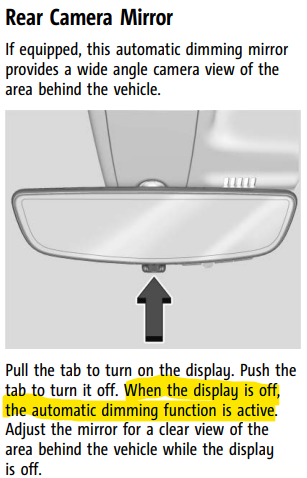

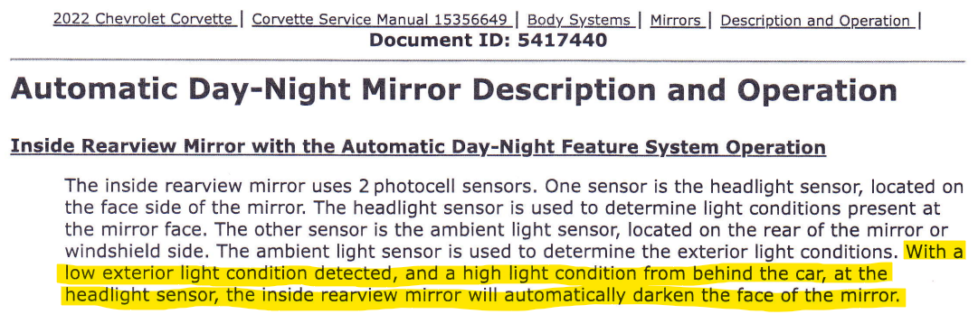

I took it to the dealer 2 weeks ago. I had taken it in 06/03/22 for the infamous "headlights always on" issue and the ambient light sensor finally came in. In the meantime, I had bought one off of eBay that had resolved my "headlights always on" problem. Regardless, I let the dealer replace my part with their part. Seems to be still fixed.
Then I shared this video with them.
Their response was "NPF NO ABNORMAL CONDITION FOUND AT THIS TIME".
They gave me a page from Corvette Service Manual 15356649, Document ID: 541744O and referenced the following section:
The 2022 Corvette Owner's manual page 26 states:
Does this mean that the automatic dimming function is NOT active when the display is ON? If so, then the automatic dimming function is not a consideration in my situation.
Just to further confuse this, the Service Manual mentions "low exterior light condition detected." Could the replacement ambient light sensor have fixed a problem in that area? They did not apply a software update.
