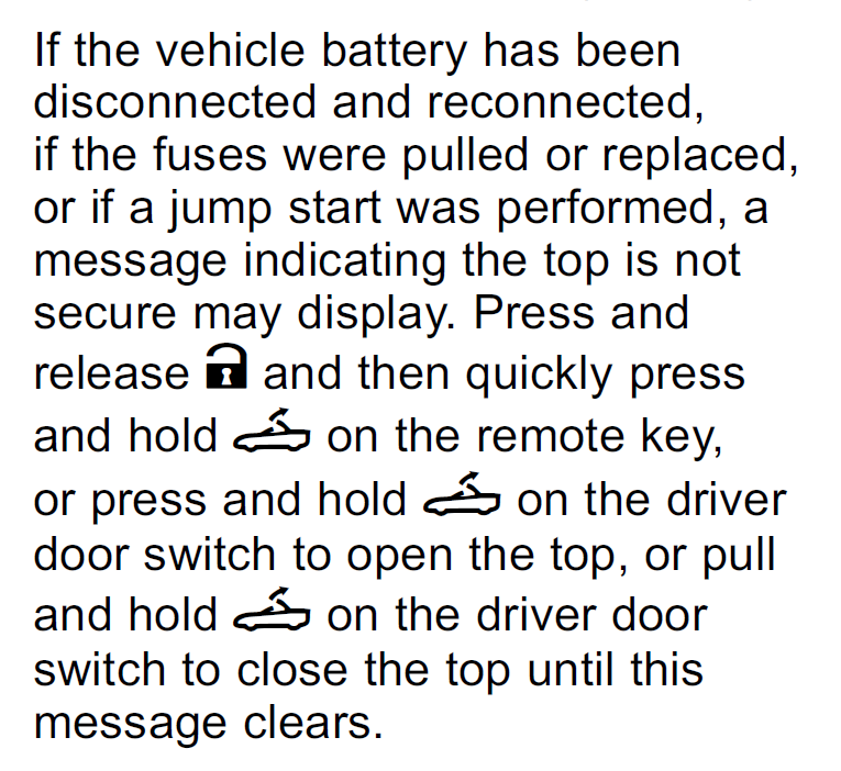

Should be ok to drive it below 31 mph since the manual says it can raised or lowered at speeds at or below that. Since you mentioned indexing the window, it sounds like already reviewed the trouble shooting sections of the manual, but here are some things you may have tried but did not mention:
1. Is your trunk secure?
2. Manual says the top wont operate with a low battery - you might try charging the battery.
3. Did you try operating it with the FOB? If the car got confused and thinks the tonneau is open in service mode, it may respond to the FOB to close it.
Below is an additional item from the manual to try:
