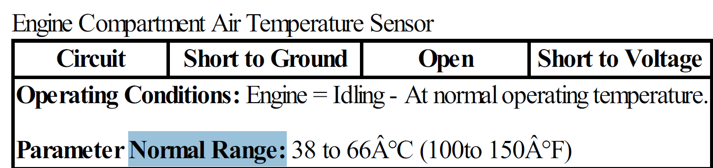

Originally Posted by SL41
flip the picture upside down the 70* will be obvious. that is what i did. i think from what was posted on the service manual it doesn't give the temp that is rated at. let me see if i can post a better pix
I see it - blew it up - and I can see the degree mark and all. And, I agree that the test from the manual does not say what the thermostat is rated for - just when it should open. The rating is supposed to be when begins to open, so its still not consistent with the statement in the manual. Possibilities: the manual is wrong, or the picture is generic and not the actual part.
I searched the manual more using the term 'normal range" and found several items of interest. These are the ranges that are expected when running diagnostics. Some of them appear in several places in the manual, and are all consistent. I'm not posting this to prove anything about the thermostat - the original discussion was just about normal operating temperature.

with it being a mid engine it probably will have a wider range of temp since it doesn't get as much air flow as front mounted C7. another possibility is GM could have also change the spec of thermostat like they did with the c7. i believe the first year c7 the thermostat was rated at like 205* ish before they change it to 194*, or it could be like you stated that it could be a generic pix but if it is what car would be using a 70* C stat?
looking closer that what you posted from the service manual, that temperature range is for engine idling (no air flow), right?
with it been a mid engine it probably will have a wider range of temp since it doesn't get as much air flow as front mounted C7. another possibility is GM could have also change the spec of thermostat like they did with the c7. i believe the first year c7 the thermostat was rated at like 205* ish before they change it to 194*, or it could be like you stated that it could be a generic pix but if it is what car would be using a 70* C stat?
The normal operating ranges are what would be measured under the specified conditions, during diagnostics - That would mean the car is not moving. There is no comment about air flow - there are thermostatically controlled fans, front and rear, that may or may not be running - and there would be some flow through the engine compartment due to convection - you can put your hand over the vents and feel the hot air come out. It is whatever it is for the conditions specified. As for the thermostat test - when it is supposed to open and close - that is a static test of the thermostat off the car. I can't comment on the thermostat rating. I also cant comment on the relative airflow between C7 and C8. I do know that Tadge talked about the fact that the mid engine design posed a challenge regarding airflow, and that is also discussed in the mid engine revolution book that can be purchased at the museum and on line. So they went to great lengths to manage the air flow to insure that the cooling system capacity on the C8 is adequate (more than adequate for the street). That being the case, I would not have a basis for concluding that the air flow is "less" or more.
