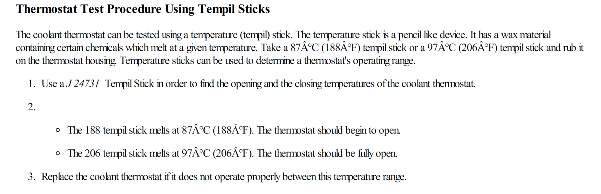

I searched the 2020 service manual for some indication of coolant temperature range. I found the following that indicates that the thermostat should start to open at 188 degree F, and should be fully open at 206 degree F. There are multiple coolant flow paths, and a search for thermostat replacement reveals at least three different thermostats in the cooling system:
1, Radiator Inlet Hose to Auxiliary Radiator Inlet Pipe (this one only appear in the illustrations for option code V09, cooling system, powertrain, high ambient, which includes an extra radiator on left rear, which is not on US models).
2. Auxiliary Radiator Inlet Hose to Auxiliary Radiator Inlet Hose (this one appears in the illustration for the right rear system, option codes "V08 and V09" - I believe it is included with the Z51 option which adds the "rear-mounted third radiator")
3. At Engine Coolant Manifold (this is the conventional looking thermostat at the water pump inlet, I think).
I only found one discussion of thermostat testing - I believe it applies only to testing of the conventional look thermostat that resided in the inlet housing on the water pump.
So, how can we have lower operating temperatures than 188 degrees? Most thermostats have a small hole in them that allow coolant to flow even with fully closed. This is necessary to allow the warm water to get to the thermostat so it can eventually open. So coolant is actually flowing. The oil can be checked when coolant temp reaches 175 degrees according to the manual.
Anyway, this should provide a clue to the normal operating range for the engine coolant. I could not find anything that indicated the temperature at which the actual overheat message happens.

that you stated is true, LT1's stat are 194* but if you do a search here for a OEM 2020-2022 thermostat, you will see in one of the pix of the stat it clearly has a marking of 70*C. i am sure that is why some folks are reporting cruising temp in the mid 160's. from a cold start, go right on the freeway (easy driving), the first sign of coolant temp dips, that would also give you a clue what the stock stat is rated at without taking it out.

Here is the search result. I can't make out the number stamped on it - but 70 deg C is lower than what is stated in the 2020 Service Manual, as posted above.

flip the picture upside down the 70* will be obvious. that is what i did. i think from what was posted on the service manual it doesn't give the temp that is rated at. let me see if i can post a better pix
