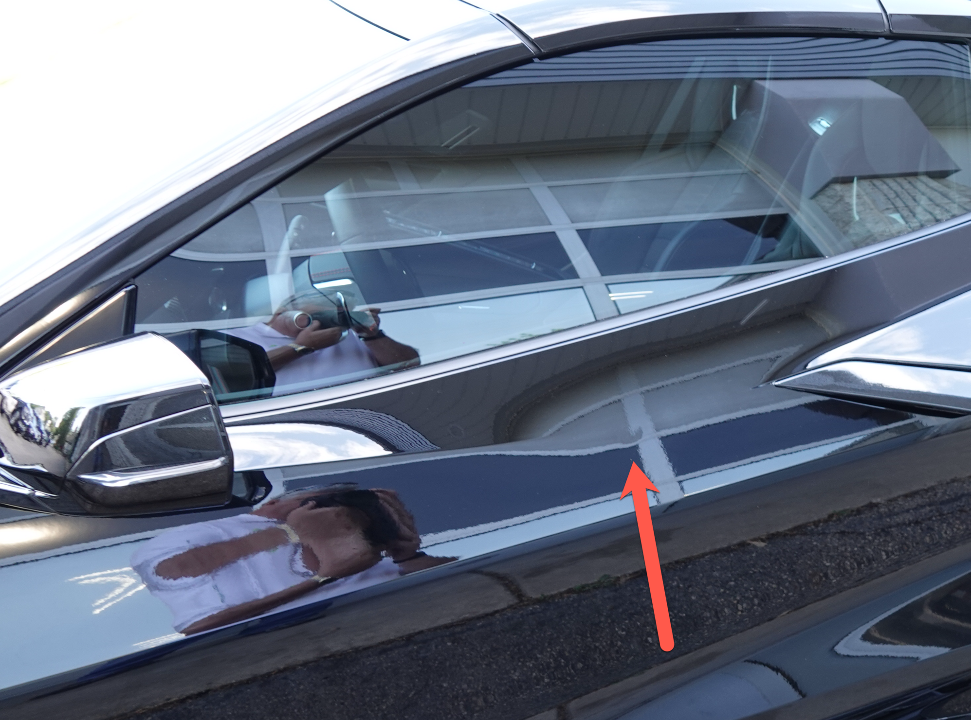

Default Door "Ding" Anyone?
The only other mention of this issue is a dead thread here: https://www.corvetteforum.com/forums...door-ding.html .
I only have it on driver side. There is no evidence that it came from an impact. It is underneath PPF although it was there when I picked it up from PPF install. PPF installer called his Vette Guy and he did not have an explanation on even how this could happen due to the composite makeup etc. none of us thinks a body shop is going to be able to do anything "good" about it. It could have been there when I picked up the car but really cannot confirm and it is so stealth it is really hard to see and to photograph but, of course, you can't unsee it once you do.

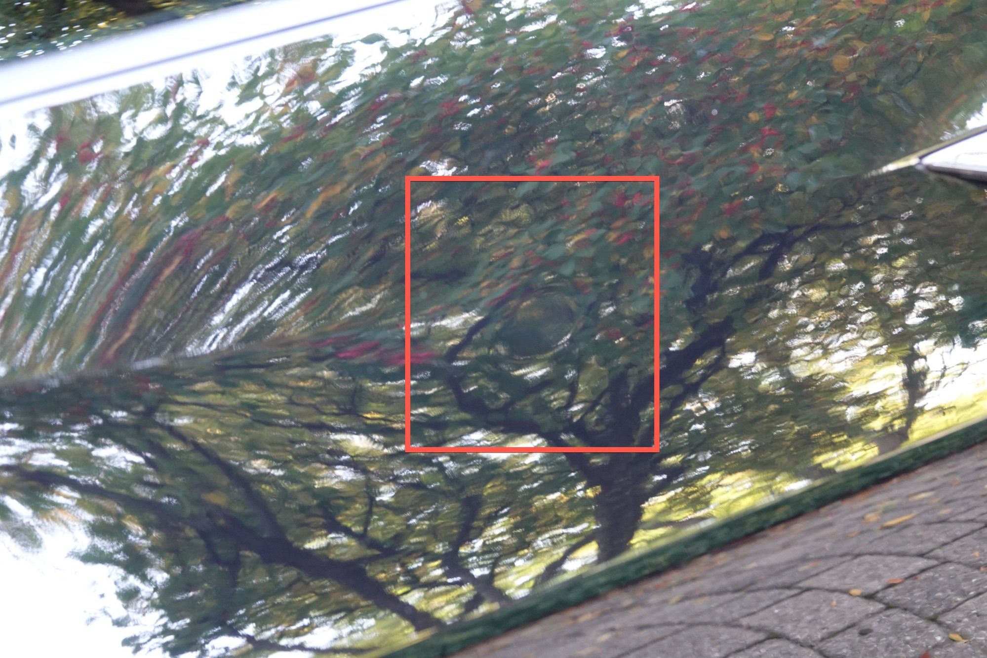

Really challenging to capture in an image since the car is so reflective but it turns out that a tree behind me provides the best image of the divot.
Anyone else have this sort of a door "ding" on their C8?

I have the exact same mark on my 2022 HTC. Mine is in the same location, except on the passenger side. I noticed it a few days after taking delivery of the car. I decided that since it is nearly invisible, and my car is a tint-coat color (very hard to match), it would probably cause more harm than good to demand the door be repainted. Since then, I don't even see the spot when I causally look at the car. I have to inspect the paint VERY closely to see anything wrong. In short, I live with it and just enjoy my car.

SMC doesn't usually get those sorts of dings; my first guess would be that it came from BGA that way. Find a good dealer and have them take a look at it as long as it is still under warranty.

...actually in my experience, it looks more like a spot in the paint than a "ding". It is almost as if some impurity settled on the paint during the curing process. Again, in my case I just ignored it, as on my car it is virtually invisible...

If you look hard enough, you'll find those dimples all over. I'm pretty sure its just a side effect of bonding the inner and outer panels. I have one particularly noticeable dimple near where the rear quarter panel and rear fascia meet. If I reach my hand up behind the wheel liner and feel around, there is a small rough circle exactly where the dimple would be on the outside. It reminds me of ejector pin points or something on an injection molded part.

Possibly a factory paint defect. I worked paint quality control at a GM/Toyota plant. Cratering can occur when air of a different chemical composition (such as a perfume or deodorant fragrance diffusing off an assembly line worker) gets trapped in the paint before it cures then bubbles/craters when the trapped air escapes. Paint line workers are told to minimize or not wear fragrant products. Cultural observation: Japanese more or less follow that rule to a T for the greater good of the company. Americans with lax attitudes more concerned about their paychecks than their employer's reputation for quality, not so much.

I believe that based on the OPs photographs and the appearance of the same defect in my paint, this explanation best addresses what happened here...

Thanks everyone. There is definitely a depression there. Dealer is my next step.

Those types of defects are in the SMC panel, not paint, and they are inherent in manufacturing that material. It's often missed in QC inspections because they are hard to see. Metal panels stamp out the same way every time. It's the price paid to keep the car as light as possible.
We have a small dimple in the passenger side nacelle on our HTC, which can only be seen from one particular angle under very bright shop lights. It can't be seen during normal daylight or more muted light. I spotted it months after delivery when we parked in a different garage bay, and I could see it every time we parked it in that spot. It's now parked in a different spot, and I haven't seen it since.

Essentially living with it. Took it back to guys who did PPF and their assessment was what others said earlier in this thread that this was a molding thing, could not really be fixed. They also spoke to their own Corvette guys who said the same.
I think almost nobody sees it except for me but I'll be sure to inspect my next car more carefully.
