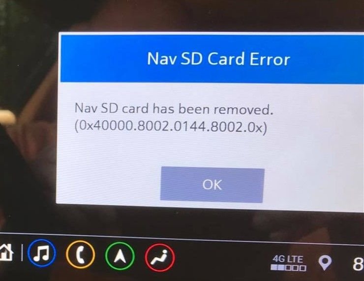

Originally Posted by Zormecteon
No trick at all. While there is not a slot to plug in a chip, there are both USB and USB/c slots. ..
IIRC some people are having issues with the NAV function when using some drives, but they will have to weigh in on this.
Originally Posted by C5racecar
I'm going the USB route. I'm always using the phone for apps while driving, or the battery is low. I like the USB, once it is plugged in, it works. Then the phone is free to do anything else.
Yep, I lived with the NAV SD Card removed error for a year (as some others.) Was using the same SanDisk flash Thumb Drive I had used in my 2014 C7 and 2017 Grand Sport where it worked fine. Even bought several new SanDisk flash drives and tried, no help. It has to do with NAV and whatever is plugged into USB starting at the same time and both use the same Buss.
Tried many things with no help including buying a new NAV SD card; dealer tech reinstalling Sound Sofware and no help. Then Dealer tech found a note in the GM Service online system they subscribe to that said, "Don't use a SanDisk Flash Drive!" So bought a Verbatim flash drive that works fine and has for several months with no errors. Error was occurring about every 10 to 15% of my starts.
Error was occurring every 1/3 start, reduced to every 10 to 15% following a Poster suggestion
Bought new NAV SD Card no help. Others where dealer reinstalled new SD slot reader, no help
Solved my issue ~3 months ago!
This is a detailed step by step PDF of things tried.
http://netwelding.com/NAV_SD_Card_Error.pdf
CONCLUSION
SanDisk is fine, others are using BUT I bought all mine from the cheapest source on Amazon for what said they were the same specs (I assumed wrongly it was a real SanDisk Flash Drive.). PROBABLY as others have found both on the Forum and Net in general - there are bootlegged copies. Perhaps read speed not meeting specs etc. From my industrial experience, copiers are smart and pick the market leader! If buying a SanDisk brand buy from a reliable source. I would buy direct and as I recall they sell on Amazon just more money!
