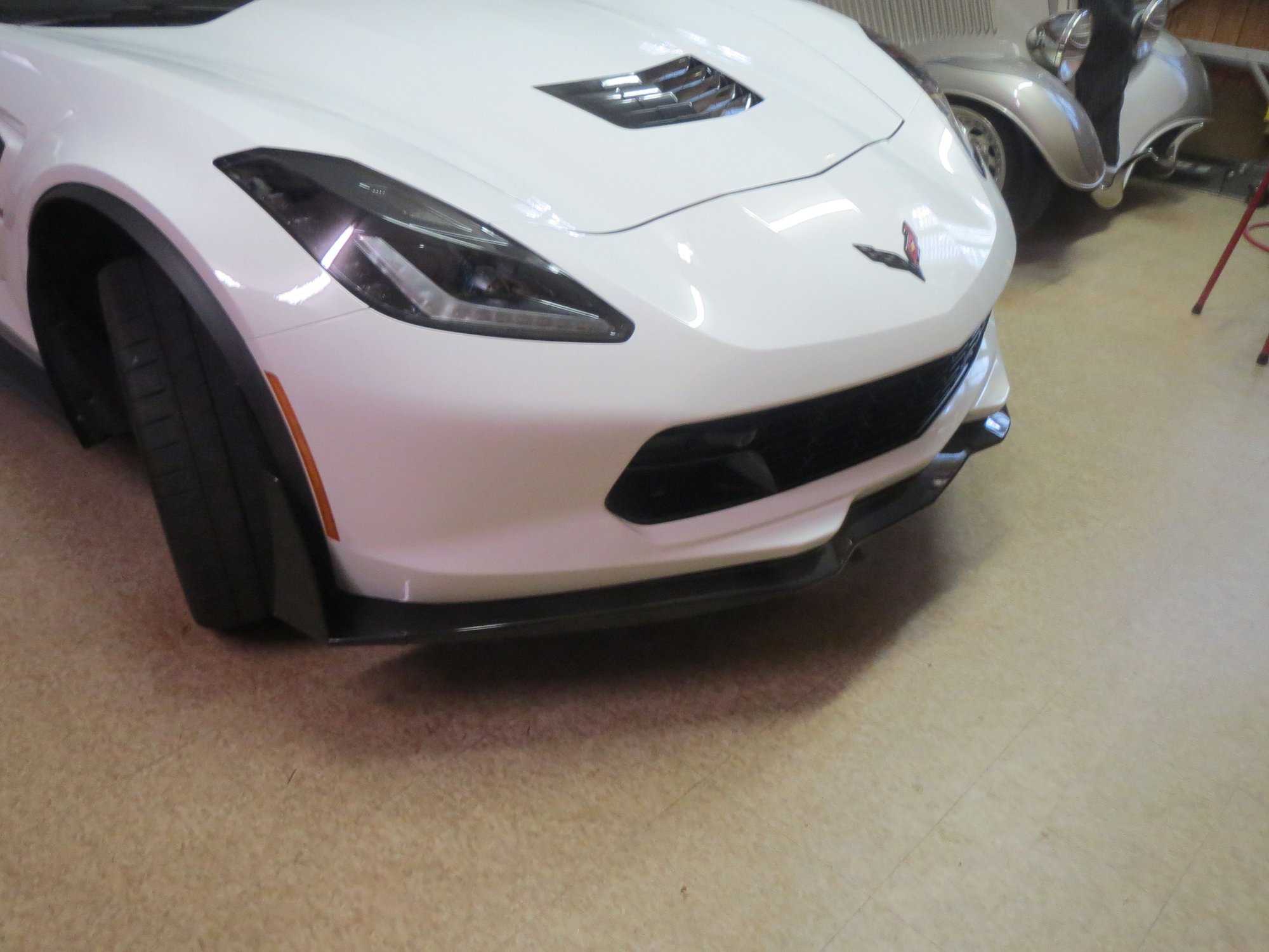

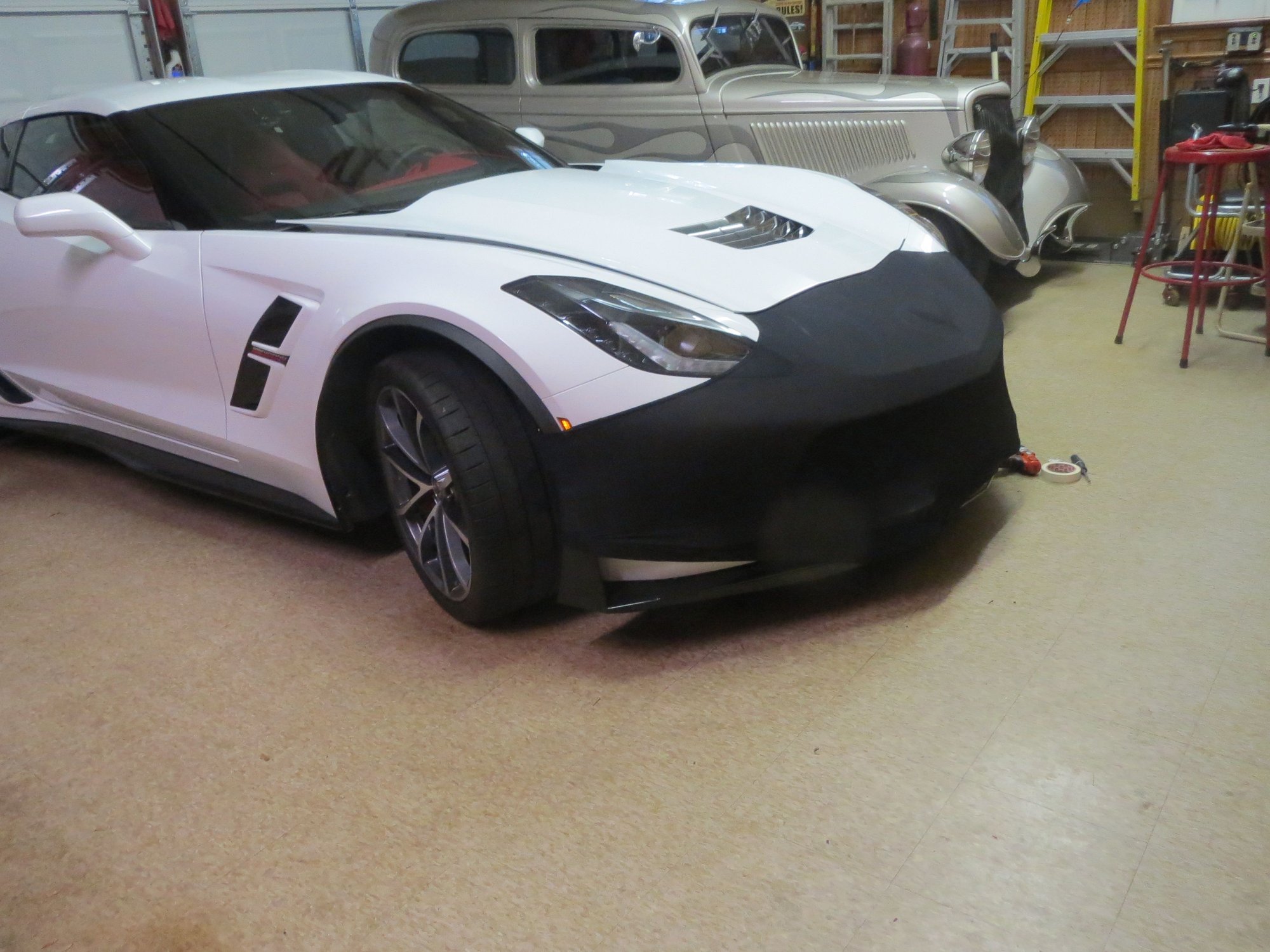

R. E. Effectiveness and installing a Novastreatch bra with a splitter:
Unlike an air dam (was on all C6, most C7s) that is effective reducing drag at highway speeds the C8 has a splitter that does little below 100 mph.
I added the Stage 2 aero package to my C7 Grand Sport (as the aftermarket 5VM to my C8) to get side skirts to stop rocks dinging my rocker panles. Both came with splitters. Here are pics on how I got the Novastreatch bra to fit my C7.
Can buy these snap extensions in any Marine store or Amazon. They are used when the boat cover shrinks! Come in various lengths. I just used on the bottom center snap you'll add when installing the bra. I even was able to use with Stage 3 winglets (I added because I scrapped the one that came with the Stage 2 Aero option) by using extensions the side snaps!
