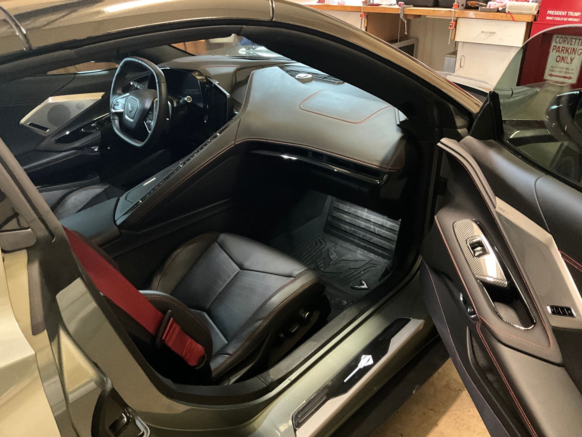

Resurrecting this thread to add that I took the plunge.
My car started with black seat belts and white stitching. A week ago I removed and sent out my seat belts to have the webbing changed to red. The color I chose is a darker red than OEM. Once I installed them on Friday I felt the white stitching looked out of place. So used a Uchida Marvy fabric dye pen in Cherry Red. For those who say there is SO much stitching, honestly, it’s not bad at all. The stitching takes the dye easily, and you wipe the excess off with a rag. It probably took me 2-3 hours total. I’m quite happy with the outcome, all the exterior reds I have added over time are now picked up by the reds I just added to the interior.
As for fading, we will see - but on all car forums across the internet, the Uchida Marvy dye pens get consistently rave remarks for not fading.
