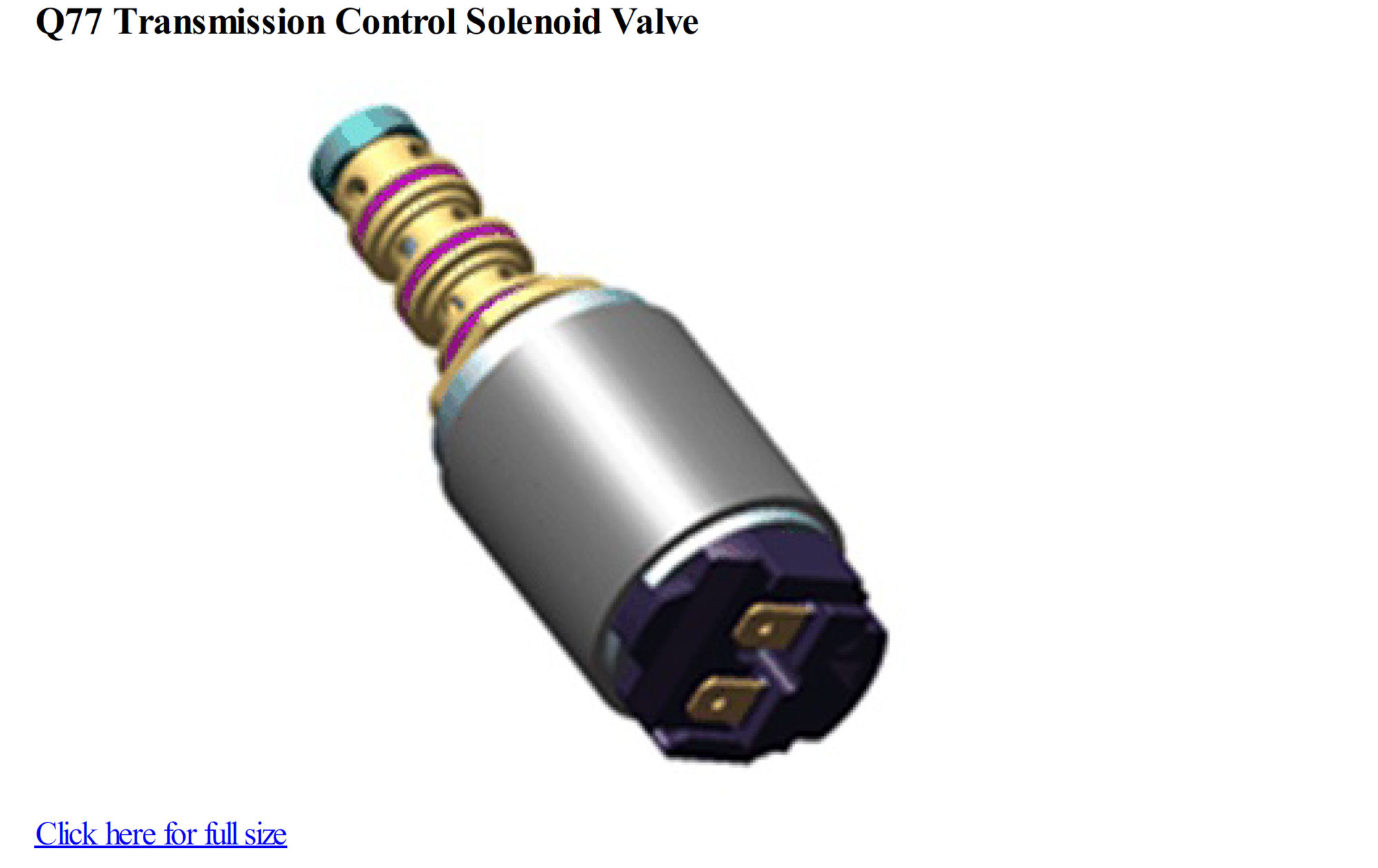

Originally Posted by flittlejr
Just left dealership. Did DCT flush, replaced filter. Lite came on in 25 miles. Have appt on 12th for top rattle (5 visits) and they said if #5 solenoid replace have to send to manufacturer. Said they not allowed 🚫 to go inside tranny. If so because that will be visit #3 according to Virginia Lemon law have to refund or replace. Don't want refund but will ask for expedited replacement. Love my Yellow LT3 so hope this fixes. Will post fix .Thanks for input. Frank
So, here is what a solenoid valve looks like. It appears to have a solenoid that actuates what appears to be a plunger, with some red things that may be o-rings or similar gaskets. And also where it goes, position 5, in the Main Control Valve body. Looks like the plunger part fits into the valve body. I wonder, are they replacing just the solenoid, or are the replacing the entire valve body? I have read forum reports about replacing the entire valve body. Seems to me that could not just replace the solenoid without insuring the valve body is free of debris. So does the dealer do that, or do they ship the whole valve body back?
