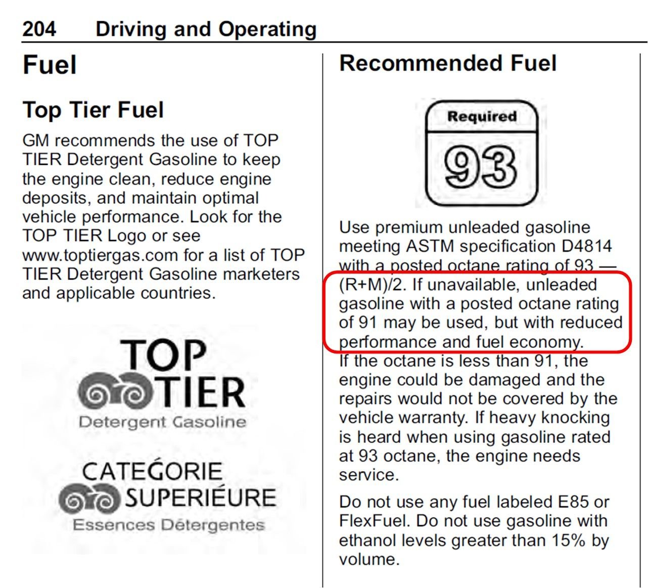

The 2020 Owner's Manual (SEE BELOW) says clearly IF you use 91 octane it will REDUCE PERFORMANCE AND FUEL ECONOMY.
Can speculate that is not the case with later year C8s BUT IMO GM just changed the words to make folks who can't get 93 Octane "FEEL BETTER." Don't think some understand that the GM engineers pushed the small block from what I had in my '56 using the exact same bore spacing and using 11.5:1 compression. Back-in-the-day 11.5:1 compression would have required Sunoco 260 with 100+ octane and a Duntov cam with so much overlap it kept actual compression down when the engine was operating at lower rpm where knocking was more likely to occur! Could always tell a Duntov camed engine with its lumpy ~900 rpm idle!
Yep the C8 air/fuel MAPS can adjust and make the fuel air mixture richer to reduce knocking BUT that can only go so far. AND you'll sacrifice power and fuel economy! The LT1 in my C7s also had high compression, the same cid, variable cam timing (best you can do with only one cam) AND that Owner's Manual said, quoting: "Use premium unleaded gasoline with a posted octane rating of 91 or higher. If the octane is less than 91, you could damage the engine and may void your vehicle warranty." BUT that was before pushing the LT2 with 35 MORE HP.
Folks where only 91 octane is available can believe what they wish and you're probably not losing a lot of HP and fuel economy BUT doubt GM did anything but change the words in later Owner Manuals!
