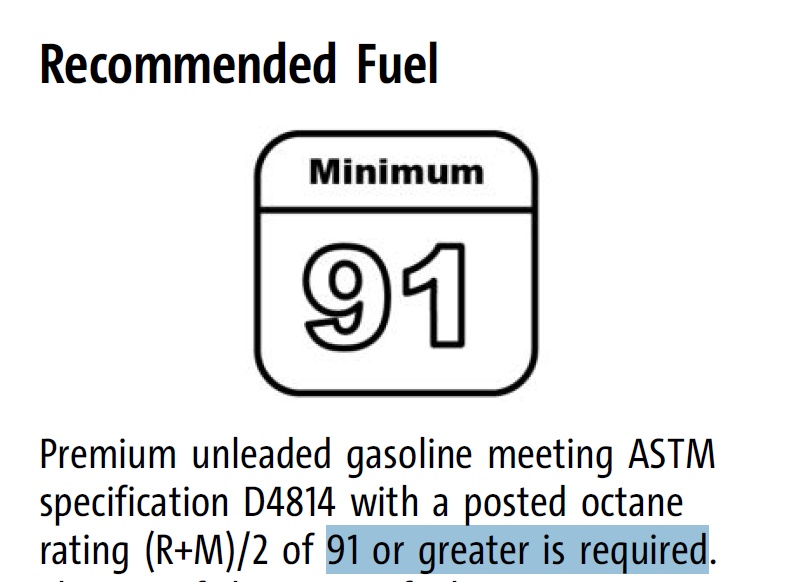

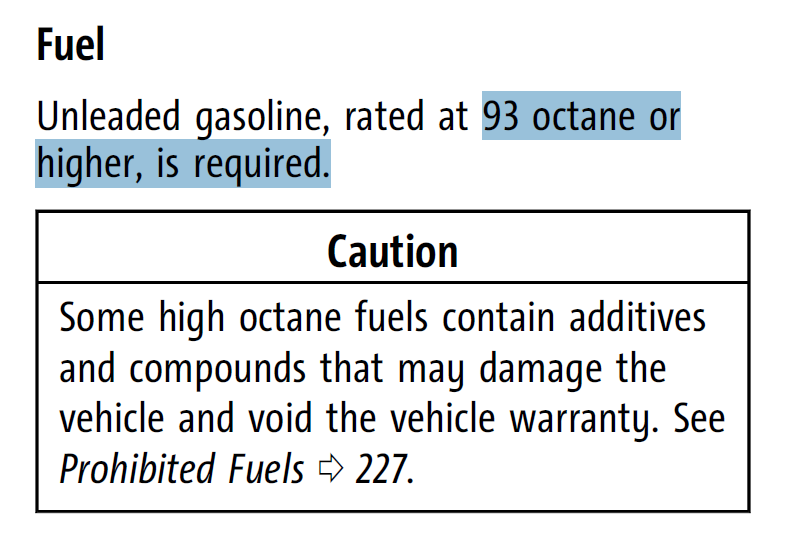

91 for street. 93 for track.
The 2023 Manual says, for normal operation, 91 octane or higher is required. But in the section for tracking, it also says 93 octane or higher is required. And yes top tier is preferred when you can find it.
NORMAL DRIVIING
AND, IN THE TRACK SECTION WE FIND:

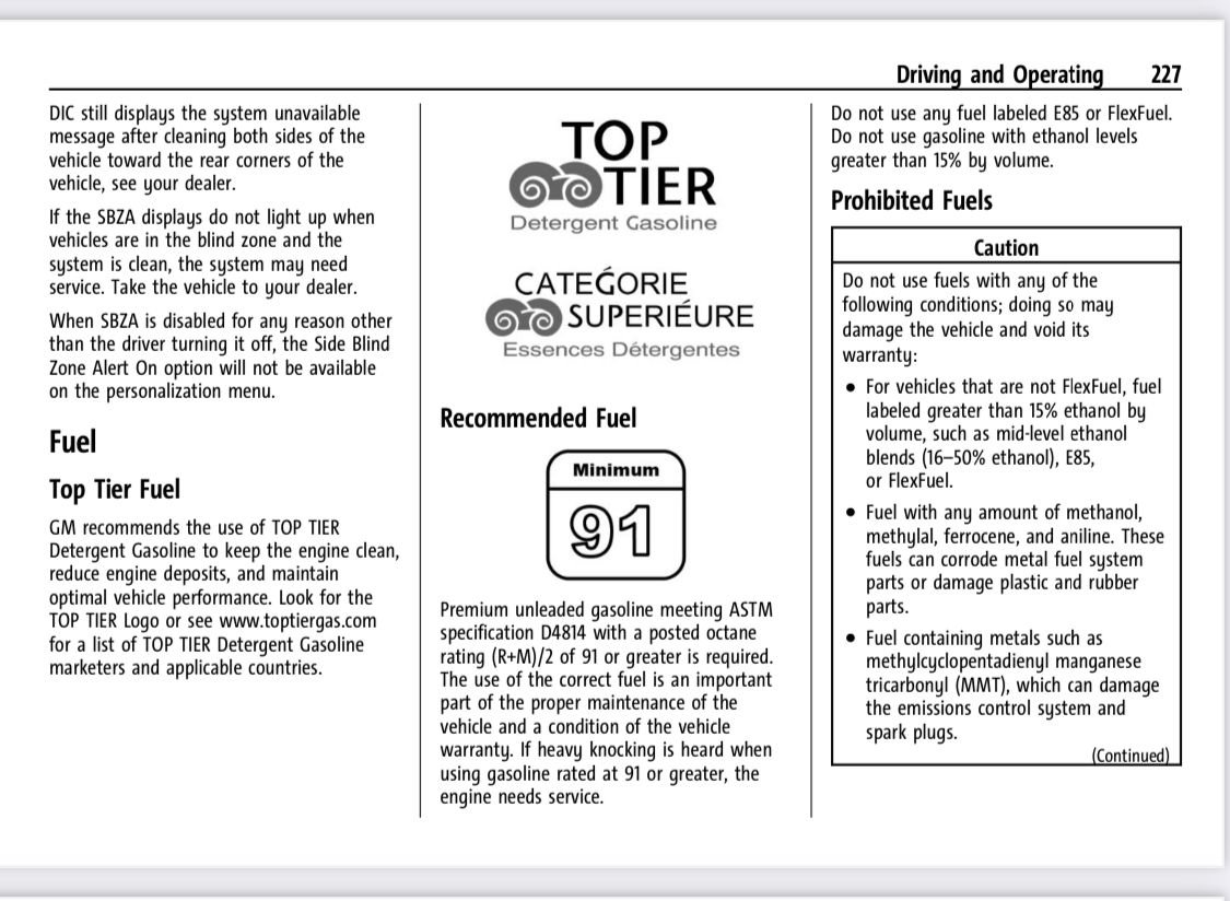

Also notice under third column “prohibited” fuels the last two items. Many of the “fuel additives” some here use contain those prohibited substances which can void warranty AND cause substantial damage to components within the fuel system including engine components.⚠️🍻

The manual lists substances that are harmful. If you add something, make sure it does not include any of those. I believe Top Tier additives are sufficient and I won't add anything to mine.
