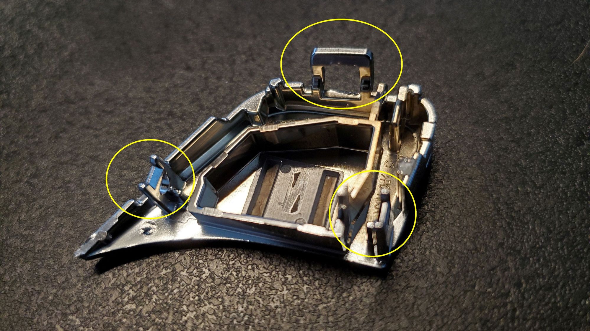

Here is a pic of the underside...It's held in 3 places...
I suggest watching the video again to see how they pull up and release the button keeping these 3 places in mind...I found using trim tools and angled pick tools worked well...
