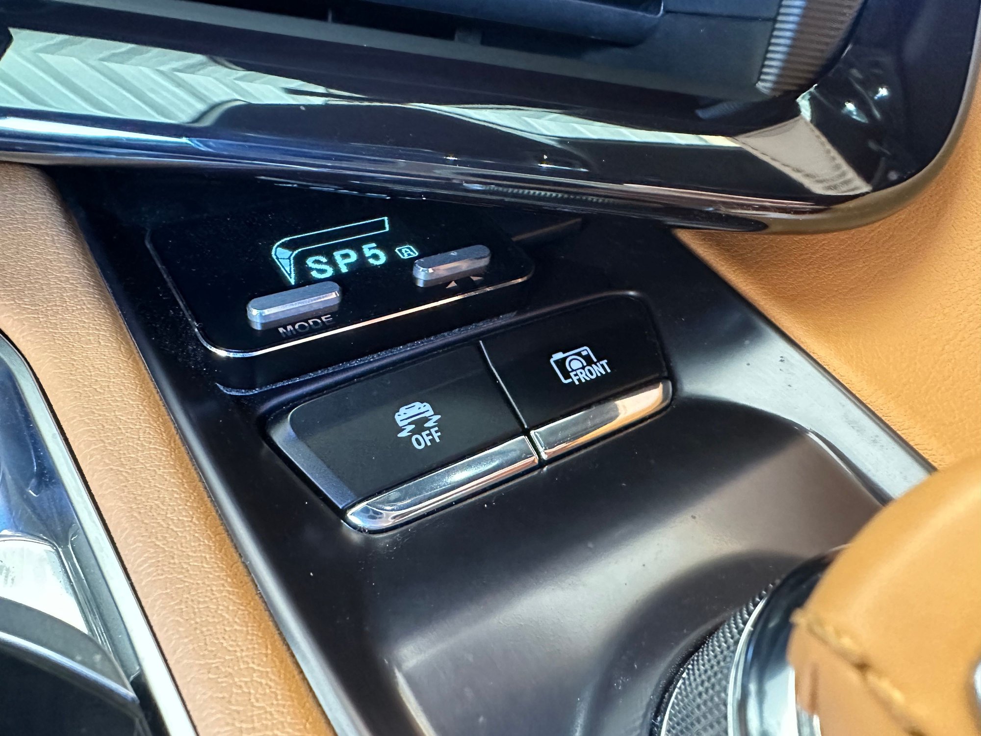

I have both Vitesse and Soler. I have Vittese in the C6 and C7, and went with Soler in the C8. I have the BT Soler but rarely use that part. I just use the buttons on controller since I found a pretty good spot for it and doesn’t show wires.
both work well. Like the Soler better because it has more modes to choose from…. Including weather and Valet mode.

Is that a pic of a C-8, I am not sure mine has those buttons. Mine has 3 instead of two?

If yours has 3 then you have the front lift in the middle. Doesn't matter where you mount the control pad (shown above the 2 buttons) I have mine mounted to the bottom right corner of the screen.
