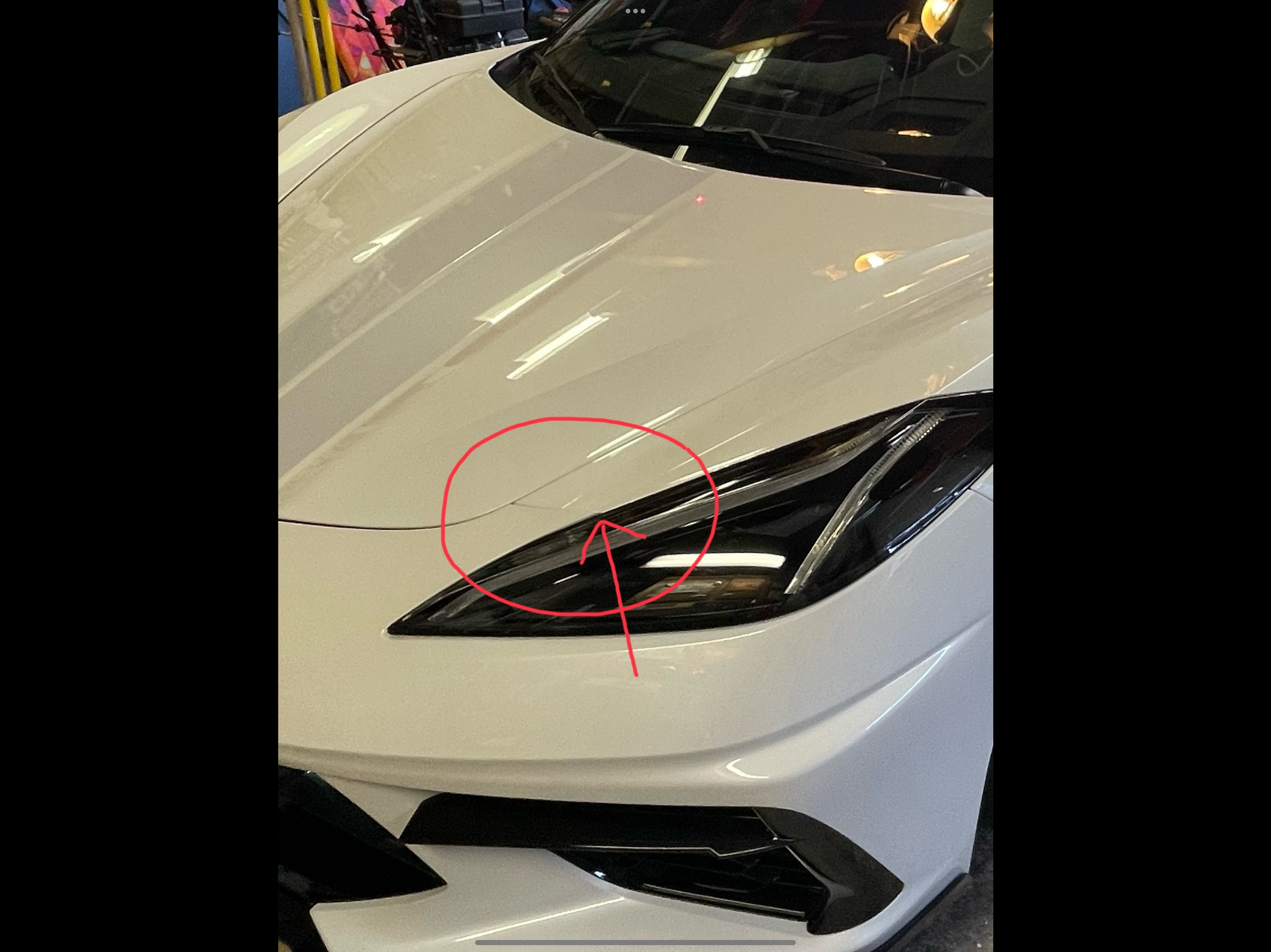

Had an appointment at the local shop this AM for a door rattle and some other nit-picking things. Shop foreman agreed with most of you in the "i would not touch it department".
They have one of the best body shops around here so will see what they say. I did not put it on the work order as it was more of a question to them versus a complaint.
We will see and I will update if I let them touch it.
Its an easy fix. Now, whether or not you want to let a potential hack dealer touch it is up to you. Mine had a similar issue and I fixed it myself when I removed the bumper to align the headlights. See attached pic- the highlighted piece is adjustable and holds the top of the bumper down.
If it was me- take your palm and push firmly down. That part snaps in and might just not be seated.

Hello, somewhat new to the forum. Recently received my 23 C8 with a few body alignment issues, also wondering if I should let the sleeping dog lay or if these might be easy fixes. Passenger door/trim is pretty far off compared to the driver door. Also, the rear roof panel sticks out quite a on the passenger side compared to the driver side.

Both the door and roof panel can be adjusted, easy fixes for sure.

These adjustments are easy to DIY if you're a DIY type. I'd be afraid to bring it to the dealer for fitment issues. Unless they get a TSB from GM, most techs have no idea what to do. I had two things I felt were worth tweeking (dash to door alignment, and something about body I cant recall) when I got the car home. Took me about an hour, including online research to know what to poke at.

Sorry for the bump, but I hate to start a new post on an issue that’s been discussed before. Any resources on how to adjust the door? My drivers side boomerang sticks out a hair too much like the photos above. I’d love to make them perfect. Issue is like @Joel3 ‘s photos.

When I got my 24 HTC in October I had it PPF'd. About around 45 miles I noticed the film backing out on the driver side where the fender. light and bumper cover meet. I took the liner out and was looking for some screws/bolts that I could adjust and there were a few but after backing some of them off to see if I could get the fender to move a little I figured it was not going to work. I, for some reason, grabbed the bracket and gently pulled down on it...and it bent a little. That put the proper (larger) gap back in between the light and fender. Back to PPF and replace the fender film. Now at 402 miles no issues with that gap or the film. It is possible to move these panels if you take your time and figure out the positioning. "Don't try this at home, I am a professional". FWIW. In some cases you may want to leave it if it's tight but not rubbing (which I would have done if not for the PPF issue).
First, I 100% get that this is a mass-produced, American made vehicle. However, for nearly $100k car one would come to expect certain things above and beyond a less expensive vehicle.
With that, I am going to the local Chevy dealer tomorrow for some other "nit-picking" items but want to know what to expect when it comes to this.
Two images:
  • Right fender to front is good to go (green check and circle)
  • Left fender to front is visibably not aligned (red x and circle)
So is this even something that can be "adjusted"???
Had the exact same issue on my 23. Dealers body shop adjusted it. Took about an hour. Looks perfect now.

Those gaps are relatively easy to adjust. Under the closeout panels in the front are the brackets that hold the fender on. There are 6x10mm bolts that have plenty of room to move around. When I remember I can post a pic of the brackets, I have the front apart on one at work if that would help.
