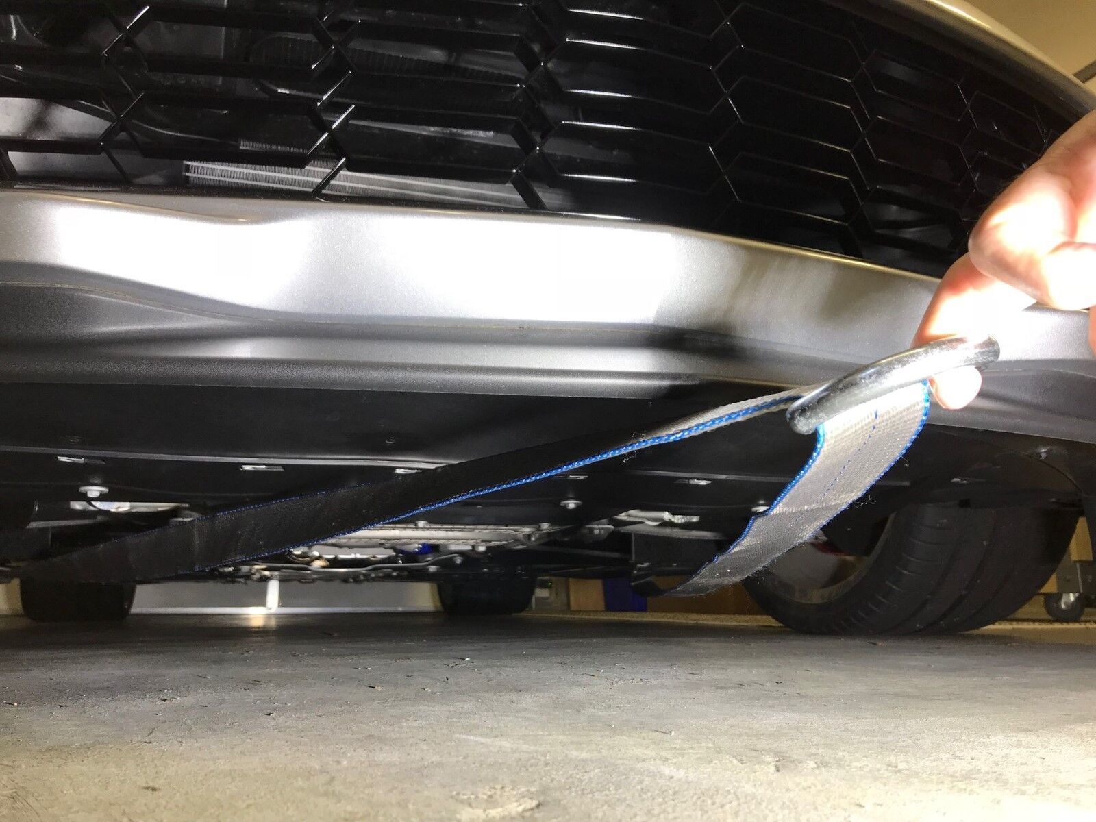

Wrecker...... that's exactly WHY I went with the V tow strap method years ago, and continue to keep in in our C8 now !!!

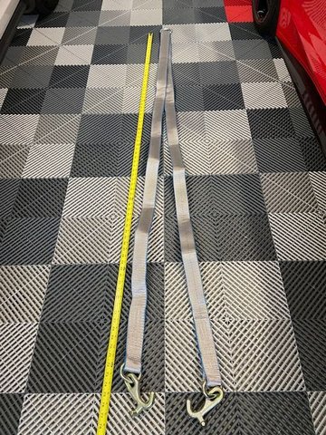

Rather than the Tow Hook method, I chose to go with a V tow strap that is long enough to hook into the shipping holes on the frame and come out clearing the front carbon fiber splitter with lots of room left over ! Came with a nice zippered fleece bag that I leave in the trunk. I've had this tow bridle since my C7 days.
Strake's Tow Bridle with J hooks.

I found it on eBay several years ago...... Seller was from SC if I recall. Sorry, I can't search back that far on eBay.... I do see where I paid $55 for it, including the bag. It's extra long.... about 76" or 78"

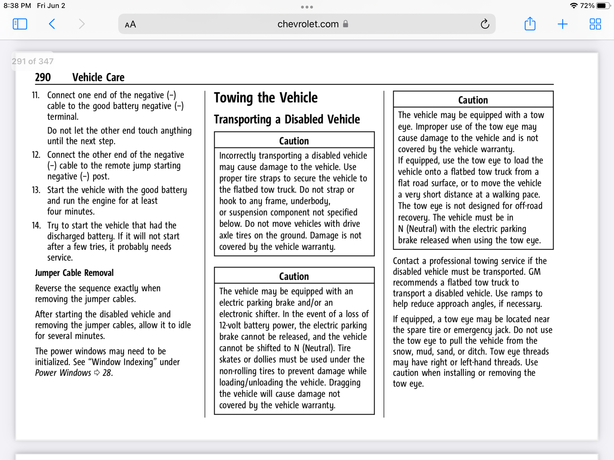

If you READ the manual about the tow hook, it clearly states NOT TO USE IT TO PULL A CAR FROM A DITCH as you suggested it was used for. Just an FYI. Below image is from a 2023 manual.

So GM says to use the tow eye to "load the vehicle onto a flatbed tow truck". While the tow eye is not dead center on the car and there will be some side force while pulling the car up it isn't significant enough to be of concern. So much for 30 years of towing experience previously stated. I like the tow eye method because I have permanent jacking pucks installed.

Here are the three pages that reference Towing.
Thanks
2024VETT
