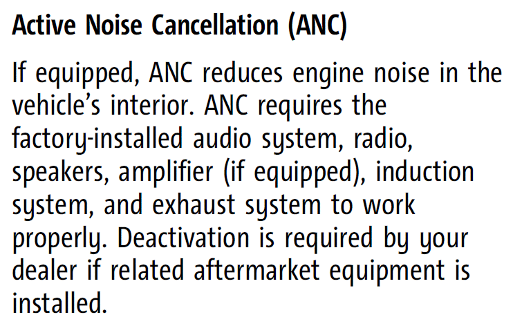

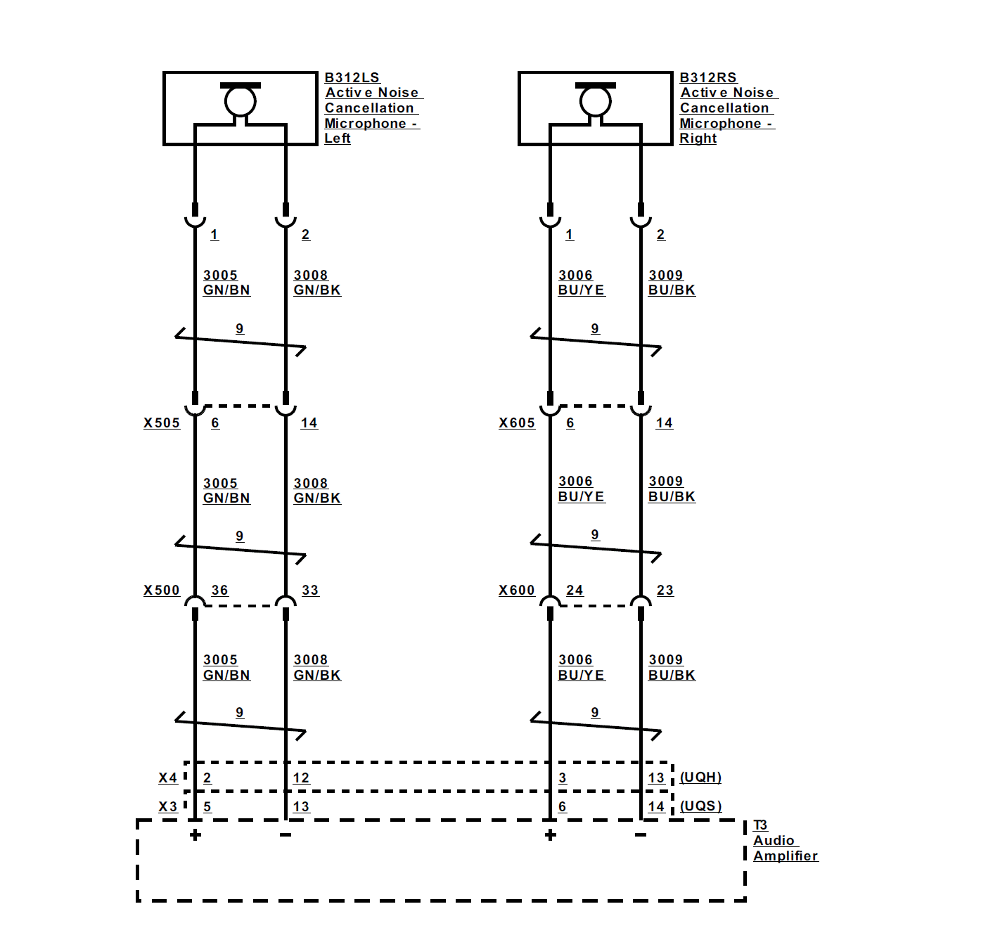

Originally Posted by c7yellow
......Is there a way I can upgrade the LT1 speakers or even add a sub or better speakers?
If you do attempt any upgrades, be aware that your car may have "active noise cancellation" as describeD in your owners manual that may need to be disabled as stated in the manual. See the clip attached. There is no menu item to disable it. It is disabled by disconnecting one of the door microphones (if you have them) - see attached photo. The feature may only be on the 2,3 LT with the 14 speaker systems. At least one forum member did add a subwoofer and it was necessary to disconnect the microphone to disable the feature(s) - but I do not know if his car was 1, 2, or 3 LT.
I say "may" because the 10 speaker system may not have that feature.
The Bose website, at this link,
https://automotive.bose.com/vehicles...vette-stingray
says that the 14 speaker system on the LT2,3 has "engine harmonic cancellation" which uses the car’s audio system to generate acoustically opposite sound waves, reducing the unwanted powertrain noise. This description sounds like it is the Active Noise Cancellation feature The 14 speaker system also has "engine harmonic enhancement" which uses the sound system to enhance select engine tones, providing refined and desirable powertrain sound inside the cabin. Neither of these features is listed for the 10 speaker system on the Bose website.
THIS IS THE GRILL FOR THE ACTIVE NOISE CANCELLATION MICROPHONE - IF YOU HAVE THEM.
ACTIVE NOISE CANCELLATION MICROPHONE BEHIND THE GRILLE
ACTIVE NOISE CANCELLATION MICROPHONE SCHEMATIC
