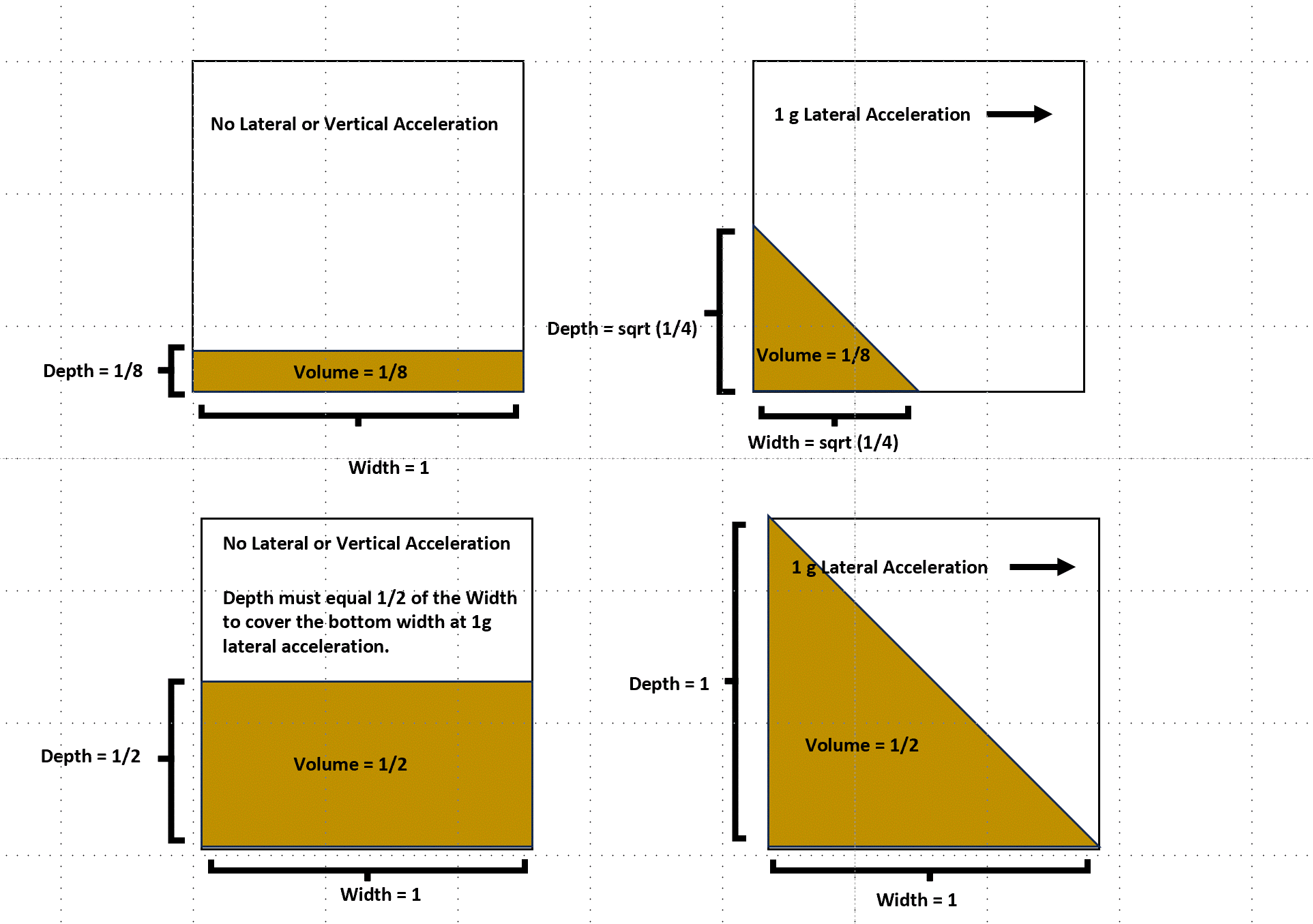

Here is what that looks like. This illustration is to scale in arbitrary units. In a 1 g turn with no vertical acceleration - there is 1mg of force down and 1mg (m is the mass of the fluid) of force to the side, so the fluid depth up the side and the fluid width on the bottom will be equal. In order to keep the bottom width covered in a 1 g turn, the depth of the fluid at rest needs to be half the width of the bottom. Of course, in this illustration there is no structure to the bottom. The effect will be different (I think) with a more complex shaped container and baffles on the bottom. So this is just to illustrate how adding fluid helps with lateral acceleration.

Well, it was supposed to be to scale - but it had an error. The numbers are still right. I fixed it in the post.
