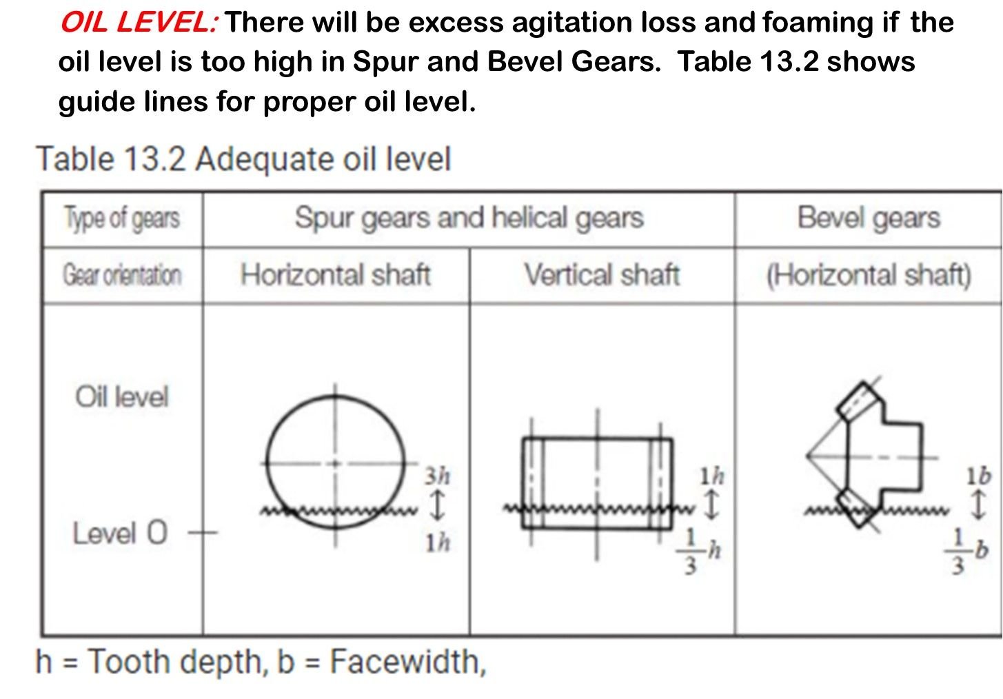

Also gear trains DON'T operate as well with more fluid. It just creates drag and possible oil foam.
See no logic for adding for street driving. Believing it runs better is not supported technically. Recent proof is the C8 Z06 with a slight mod on the lower pan DOES NOT REQUIRE ADDING THE TWO EXTRA QUARTS EVEN WHEN TRACKING. THAT IS EVEN WITH CUP 2R TIRES THAT CREATE A HIGHER MAX LATERAL "g" FORCE.
Here are some pics to help understand the issue:

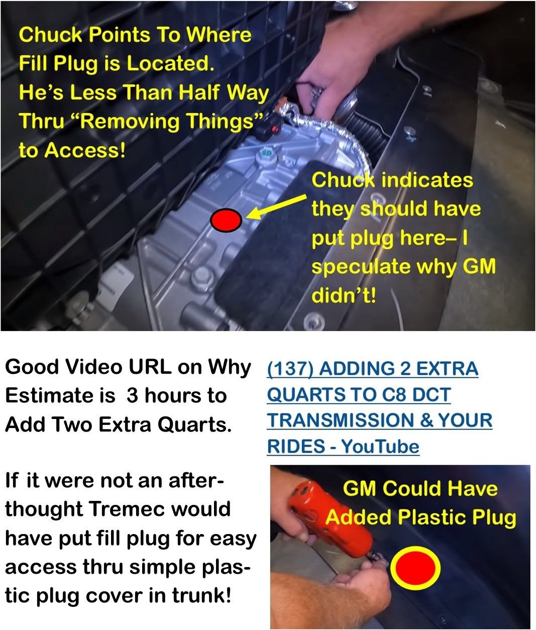

Chuck, Conti dealer Tech during his video of 2 to 3 hour effort adding the 2 quarts shows where they could have put the fill plug, under the truck! Have to take a lot apart to add!
